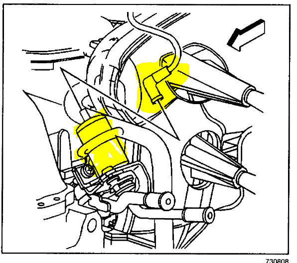

Okay, I'm now onto the fuel filter and MAF sensor but I can't get a straight answer on where the MAF sensor is. Any other vehicle is in plain view. One guy says it's here; another says it's there. Yet another says there's none at all. Obviously two of those answers are bogus, which is it? I have no problem identifying it on any other vehicle. Incidentally, it took several days for the evap code to return. I tested the purge valve, and it was clicking only a fraction of the time. That would tell me why the code didn't come back right away because it was working some of the time. So far, the evap code is gone, but the 171 came up immediately. I understand the fuel filter was recently replaced, for security of my waning sanity, I'm going to replace it again. Still need a MAF location or if it even exists.

No, sorry. Basic scan tool here. I really just need to know does this 2003 4.2-liter engine have a MAF sensor or not? If so, where is it please thanks? In summary, the vehicle started out with evap issue codes. Removed, tested and replaced the vent valve as there was no reaction when I applied current directly to it. Code remained absent for several days but then displayed the lean code but evap code did return. Removed and tested and replaced the purge valve as it was reacting intermittently to the current applied directly to it. Smoke tested the evap system and then went directly into intake and found no leaks. The gas cap was tested and ok'd when I failed the emissions test. I then replaced the fuel filter as I found no record of it being done and as of now I've got no codes but need to drive cycle some more. I'm left with the MAF sensor which I can't easily identify on this engine. That's about the end of my rope of expertise. If I can't clean or replace a MAF sensor and the mil stays lit, I don't know what else I can try. I have not been able to put a gauge on the line at the fuel filter but again, there is no misfire codes or anything else indicating low fuel pressure. Starts, idles and runs like a raped ape, no signs whatsoever of low fuel pressure. It is past due for passing smog test and now I'm having to absorb slack from this vehicle being down. Can you please tell me, MAF or no MAF? Or any other suggestions I can try at my level. With the current state of this country and the gouging of customers going on, bringing this vehicle in at 140 dollars an hour just isn't possible right now. I appreciate your attention.
Nov 5, 2022 at 6:19 AM
  • 110,240 POSTS
It doesn't have a MAF. In its place is a manifold absolute pressure sensor and an air intake temperature sensor. I attached a pic below showing locations.

Okay. I'm still chasing this thing, but I did manage to score a better scan tool, and this is what I saw. First off, which I thought was weird, was immediately upon starting the system went into closed loop way before it reached any temperature. Is that because of heated o2 working? This is the real issue I found. The small tube that connects the fuel pressure regulator to the airbox on top of the engine, when I wiggle the tube the fuel trim bounced back and forth from extreme negative to extreme positive. I think 19.53 is the maximum fluctuations either the scanner app will display, or the computer will allow in not sure but regardless, the slightest touch and it will go from neg19. 53 to pos 19.53 instantly. The driver complains of a gas smell occasionally. The tube is not clogged, and I couldn't find cracks in it. Should I replace the tube or the regulator or both. I hope I'm making sense. Thanks for all of your help so far. How you keep up with all of this I'll never know but good job.

Are you referring to the vacuum hose to the regulator? Take a look at the pic below and let me know if that is what you are referring to.
Also, disconnect that hose and see if there is any evidence of fuel being in it.
See pic below.

Yes, sir that's the one. I could almost blow on that tube, the slightest touch sends the stft from all the way negative to all the way positive and another touch sends it all the way back to the negative again. Meaning -19.53 to +19.53 in an instant, not anything in between. That tube appears to be airtight so it's telling me there's something amuck with the regulator. One moment it's dumping fuel into it the very next it's trying to take it away. I would suspect that's why she only occasionally smells gas. Incidentally, I'm also getting the p0442 code simultaneously with the p0171 for the first time. Before it was one or the other. The purge system, valve and solenoid both tested faulty and have been replaced. There's no change in numbers while applying brakes nor 1500 or 2500 rpm revving. I have not seen a drop of fuel from that tube or anywhere. The exhaust stinks like dead birds but this vehicle has no problem starting, staying running and it hauls ass still. No hesitation and only a very slight rough idle. The cap has been tested; I've done smoke testing as well as carb cleaner testing revealing no leaks. Should I buy the regulator? I've got one shot at getting it. I can only afford one more thing i have to get it right. Thanks
Dec 10, 2022 at 10:48 AM
  • 110,240 POSTS
If there is no evidence of fuel in the vacuum hose and the hose has good vacuum pressure with the engine running, then I would suspect it has to do with the regulator. The only thing that makes me question it is the idea that when you move that hose, the trims change so much. Are you sure there isn't a crack in the hose?
