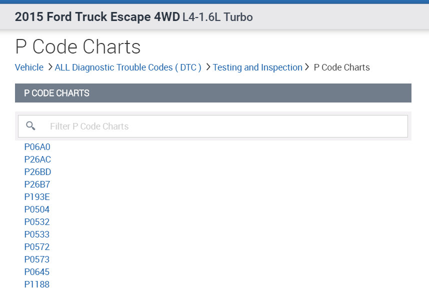

SCGRANTURISMO
  • 4,897 POSTS
If I could jump in here for a second, there is no Direct Trouble Code (DTC) P,B,C,or U (Power-train,Body,Chassis,Network) 0456 in the DTC list for your vehicle. Could you please double check the DTC number again and get to us with what you are able to find out. To reiterate BMDOUBLES answer, I would check to make sure the air filter housing is snaps shut and ensure that the proper air filter was used and is seated in the housing correctly. Please get back to us with what you are able to figure out.
Thanks,
Alex
2CarPros
May 29, 2019 at 10:03 AM (Merged)
CYNTHIAWA
  • 67 POSTS
Thank you. Good idea. Someone mentioned getting my injectors cleaned out. Which would maybe make sense to since I had a one time P0106. But didn't come on again with same symptom just a second time. The only code I got a second time from O'Reillys was 0456/ which he said was a lack of gas cap and air getting in there? First time a check engine light was on. Didn't come back.

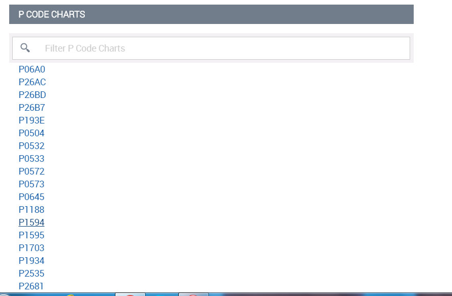

SCGRANTURISMO
  • 4,897 POSTS
Hello again,
Okay, again I am not seeing that DTC on the list. In the diagrams down below I have sent you the entire P-Power-train DTC list for your vehicle.
Thanks,
Alex
2CarPros
CYNTHIAWA
  • 67 POSTS
Hmm, they said it was code 0456.
