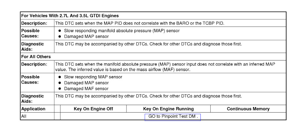

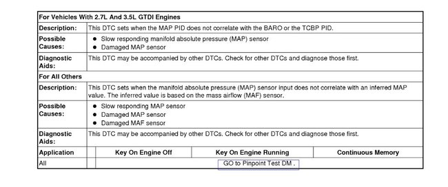

I attached some possibilities below for the failure.
You need to have it addressed. It will not go away until the issue is diagnosed, repairs made and clarification are confirmed.
The mass air flow sensor, connector and voltages all need to be checked.
P0106
Descriptor
Probable Causes
Manifold Absolute Pressure (MAP) Sensor Malfunction
Manifold Absolute Pressure (MAP) Sensor Responding Slowly
Mass Air Flow (MAF) Sensor Malfunction
Flow chart
DM: Manifold Pressure Sensors
DM: Introduction See: Computers and Control Systems > Diagnostic Trouble Code Tests and Associated Procedures > DM: Manifold Pressure Sensors - Introduction

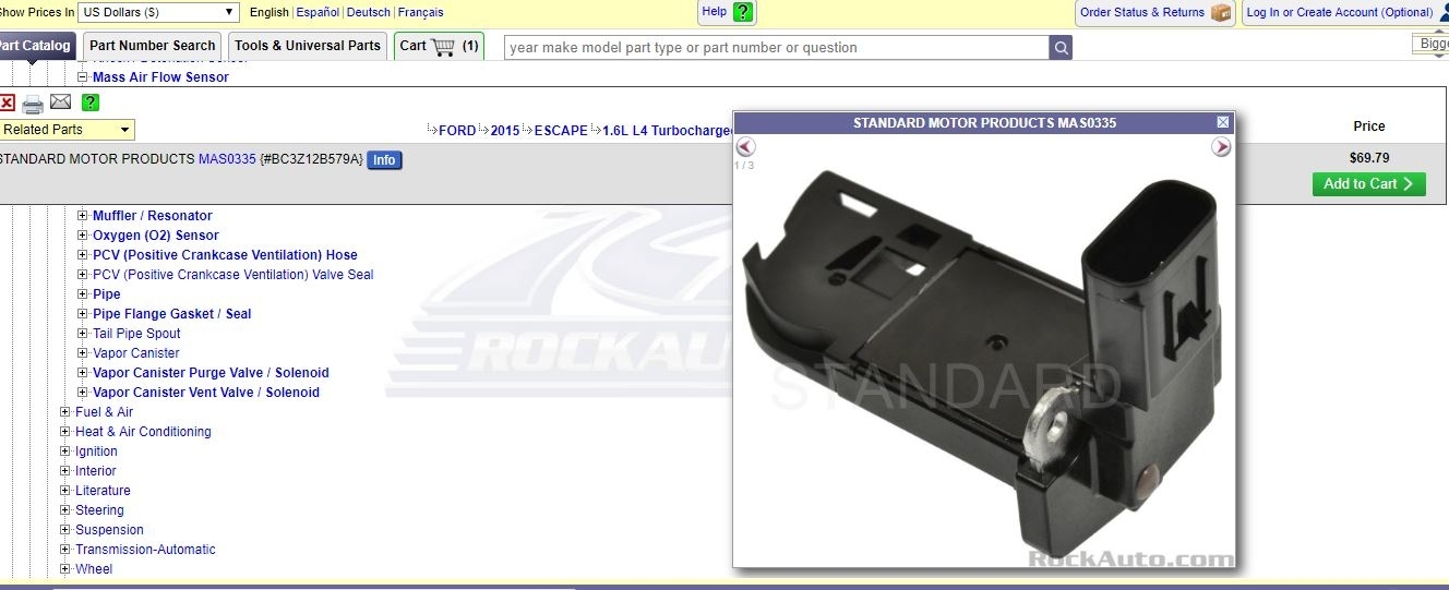

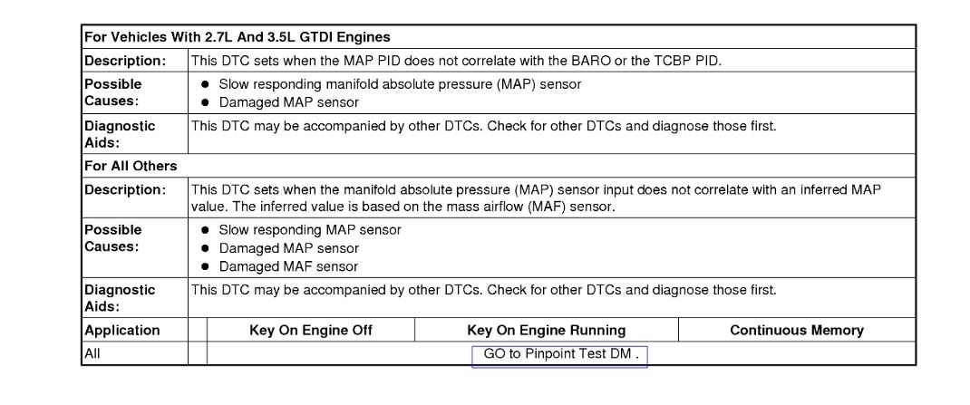

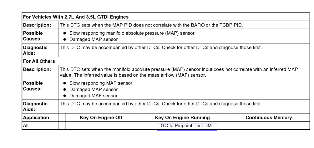

That makes a big difference.
Okay, if you have less than 50,000 on your car, this is all warranty. You have a 5 year 50,000 warranty on check engine lights.
The mass air flow sensor has a fault. I posted a flow chart, picture and the part for you to view.
Possible failures are
P0106
Descriptor
Probable Causes
Flow chart for the failure.
