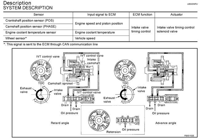

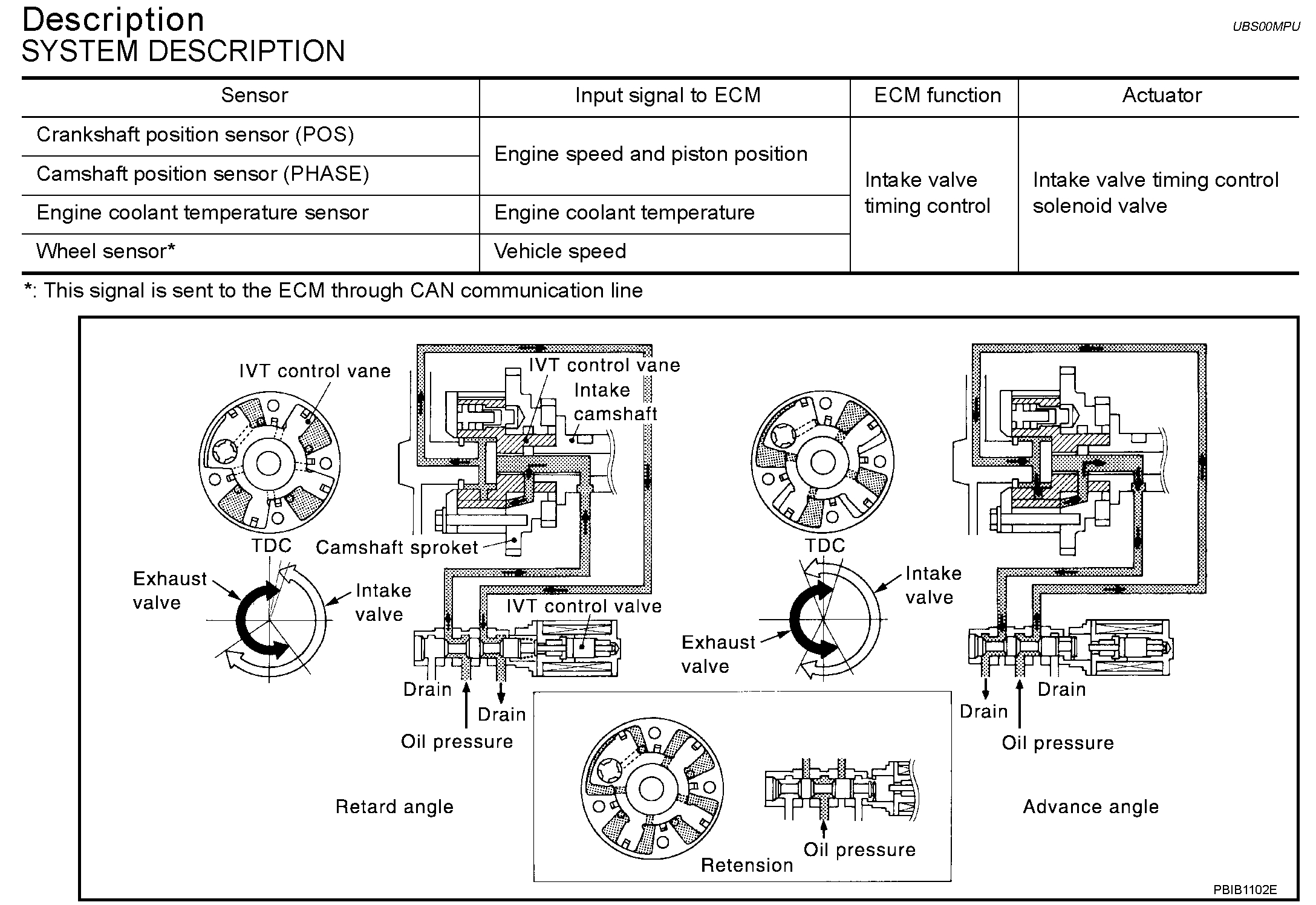

SYSTEM DESCRIPTION
This mechanism hydraulically controls cam phases continuously with the fixed operating angle of the intake valve.
The ECM receives signals such as crankshaft position, camshaft position, engine speed, and engine coolant temperature. Then, the ECM sends ON/OFF pulse duty signals to the intake valve timing control solenoid valve depending on driving status. This makes it possible to control the shut/open timing of the intake valve to increase engine torque in low/mid speed range and output in high-speed range.
pic 2

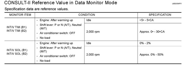

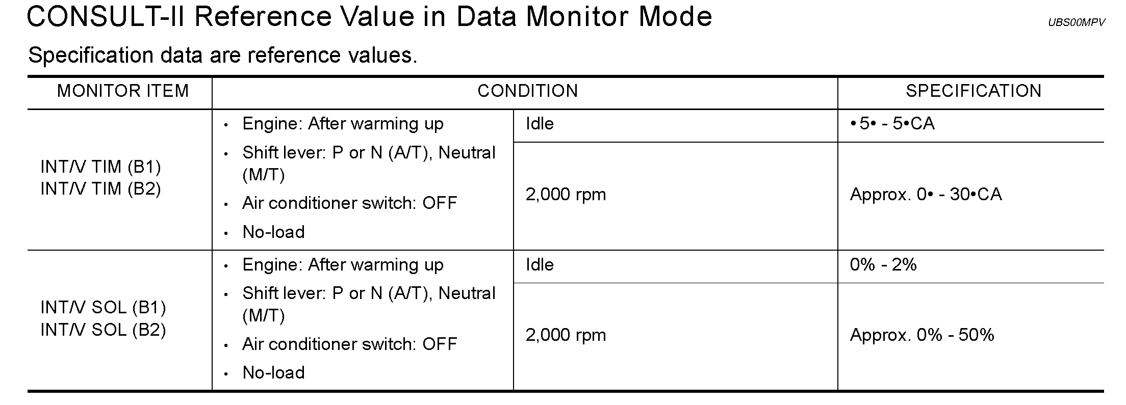

CONSULT-II Reference Value in Data Monitor Mode
pic 3

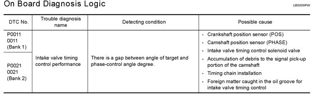

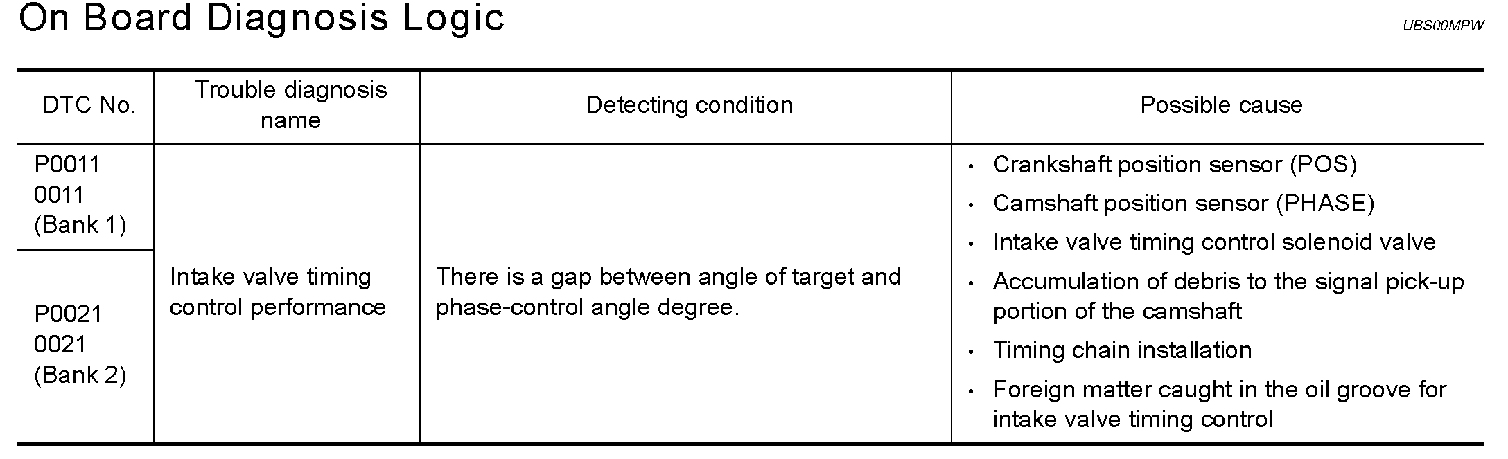

On Board Diagnosis Logic
pic 4

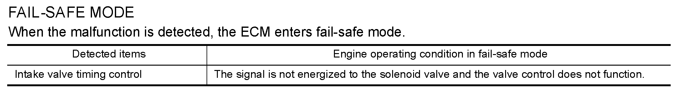

FAIL-SAFE MODE

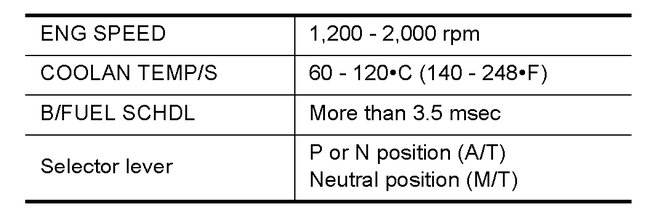

TESTING CONDITION:
Before performing the following procedure, confirm that battery voltage is between 10 V and 16 V at idle.

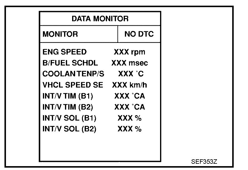

WITH CONSULT-II
pic 5
1. Turn ignition switch ON and select "DATA MONITOR" mode with CONSULT-II.

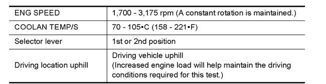

2. Start engine and warm it up to the normal operating temperature.
pic 6
3. Maintain the given conditions for at least 6 consecutive seconds. Hold the accelerator pedal as steady as possible.

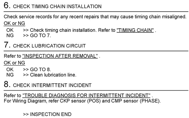

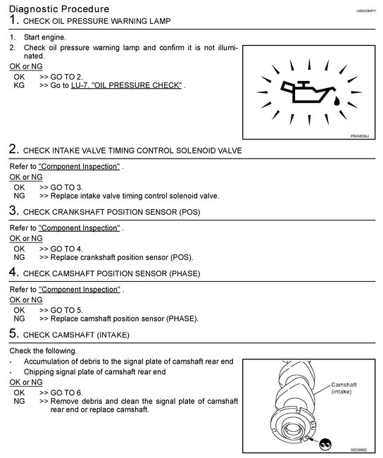

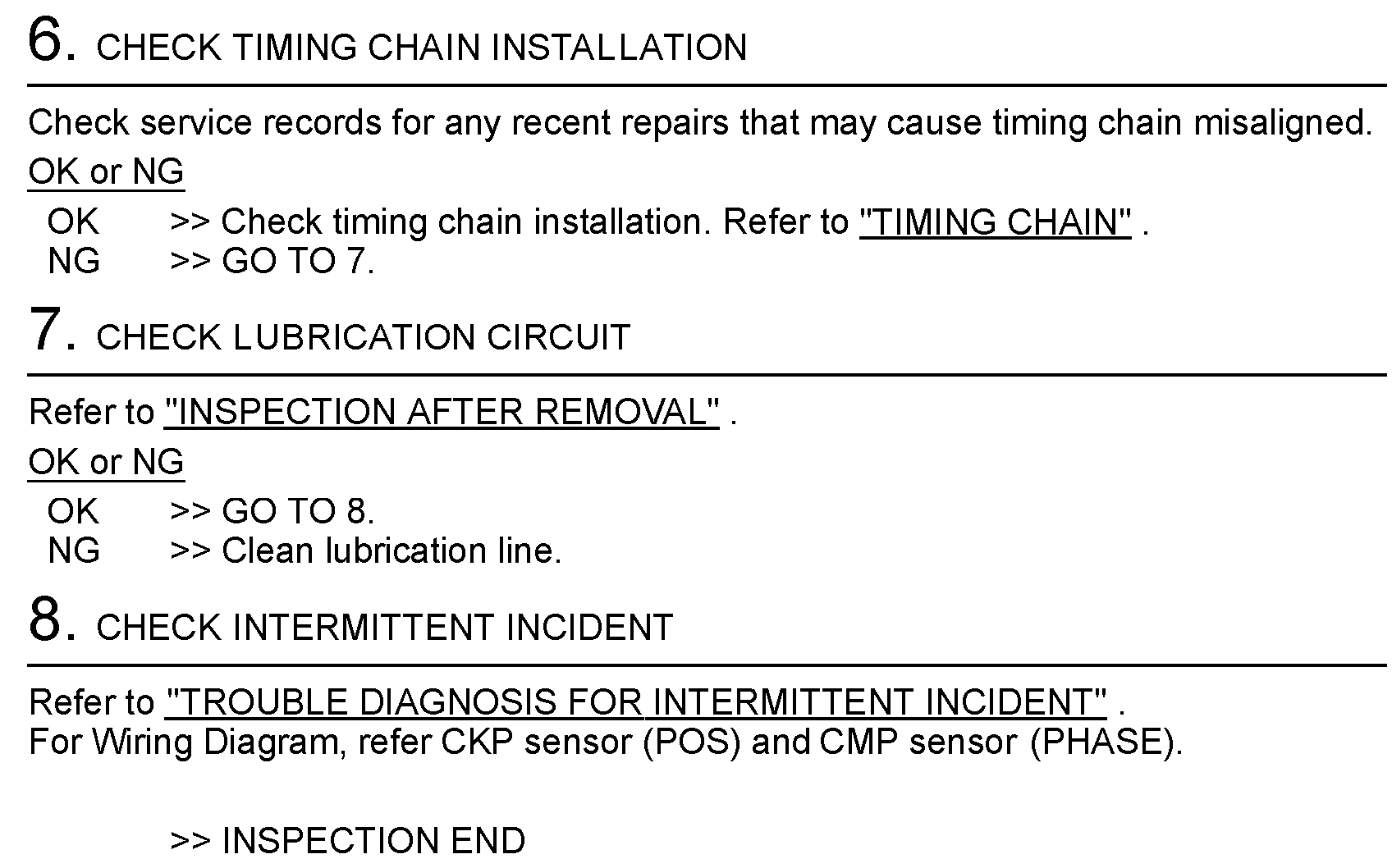

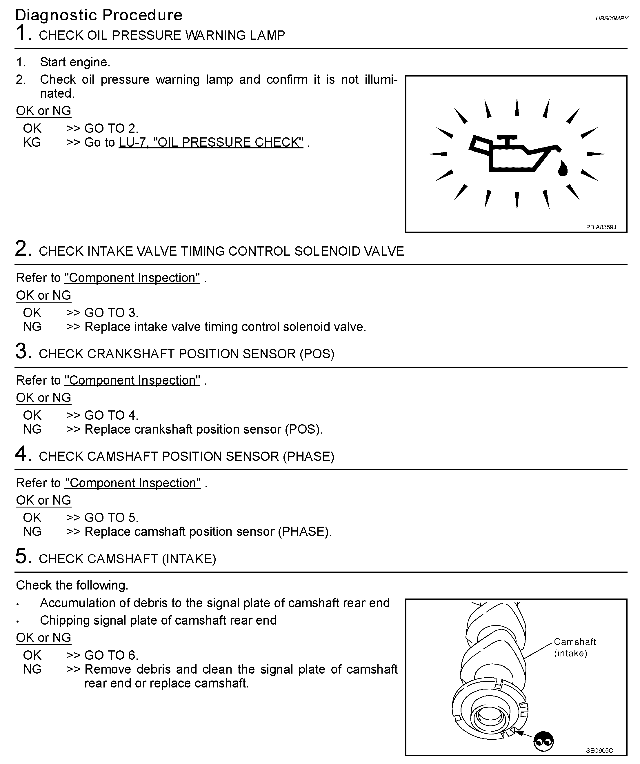

Diagnostic Procedure (Steps 1 - 5)
pic 8
Diagnostic Procedure (Steps 6 - 8)
pic 9

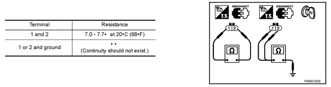

INTAKE VALVE TIMING CONTROL SOLENOID VALVE
1. Disconnect intake valve timing control solenoid valve harness connector.
pic 10
2. Check resistance between intake valve timing control solenoid valve as shown.
If NG, replace intake valve timing control solenoid valve.
If OK, go to next step.

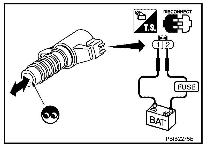

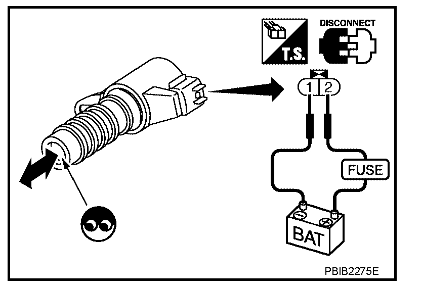

3. Remove intake valve timing control solenoid valve.
pic 11
4. Provide 12 V DC between intake valve timing control solenoid valve terminals and then interrupt it. Make sure that the plunger moves as shown in the figure.
CAUTION:
Do not apply 12 V DC continuously for 5 seconds or more.
Doing so may result in damage to the coil in intake valve timing control solenoid valve.
NOTE: Always replace O-ring when intake valve timing control solenoid valve is removed.
I added these directions in case you feel comfortable do it. Please let me know if you have questions or need additional information.
