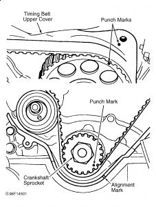

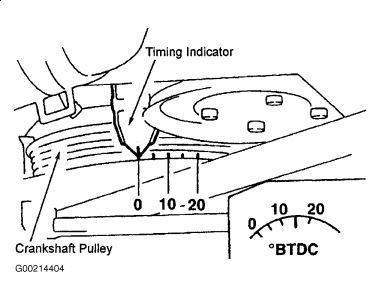

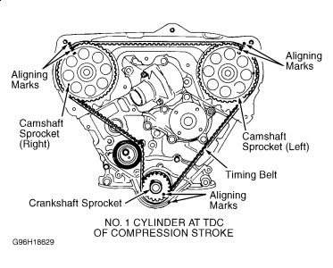

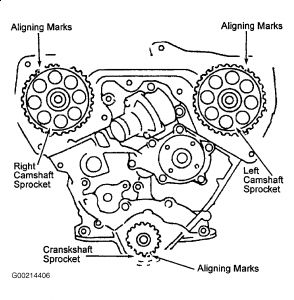

I am working on a 2000 Xterra, doing a timing belt. The mark on the crankshaft sprocket is in place, but the mark on the block to match the sprocket is NOT! How do I find where to set my crankshaft to time.

This is what I have in my book
