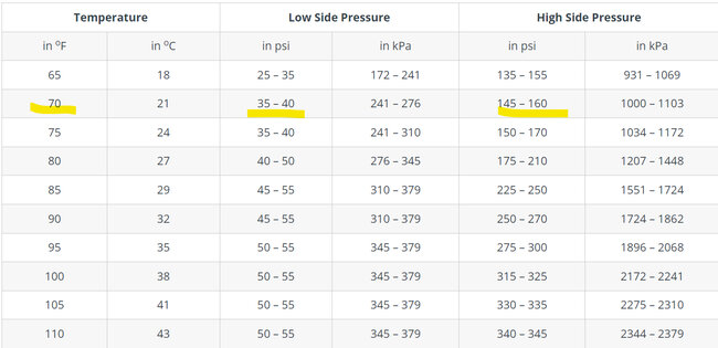

New question. Now that the truck is running good, I notice the A/C doesn't get as cold as it did before. Could I just add a can of Freon, or do I need to hook up the pressure gauges? Would one can overpressure the system?
Jul 9, 2023 at 8:07 AM
How long has it been since you've had any A/C work done? Vehicles this old will eventually develop a leak somewhere. Usually if it's something that has not been recharged in 20 years for example, and the system has slowly lost its charge and it's not a seal that completely failed, it's usually the fill valves that leak slowly over the years. You can add a can, or add half, let the system stabilize, see how cold it gets and go from there. Keep the A/C controls on the recycle or defrost setting so it doesn't draw in outside air. If you own a set of gauges it doesn't hurt to see what the pressures are at, with those sets the yellow center hose is to add refrigerant. That being a 1996, make sure to check the label first, in service info it looks like its R134A, but just look for a label. This is the pressure to temperature chart below for R134a if you do hook up the gauges.
And depending where your fill valve is, it's going to be on the Low-pressure side, sometimes companies put the fill valve on the compressor itself, yours shouldn't be, here is a guide to help recharge from those cans. If you're filling with a valve that is on the compressor, you just don't want to put liquid freon into the compressor. Turning the can upside down adds the Freon as a liquid, and right side up adds it as a gas. Just so you know about that. If you have one of the cans with a gauge on it, and the pressure is zero, then the system is completely empty, but it's probably like my truck, where it gets semi cool on really hot days. It's just low. Add some and then check how cold it gets, then if needed add a little more.
https://www.2carpros.com/articles/air-conditioner-how-to-add-freon
Jul 9, 2023 at 11:25 AM
I replaced the compressor with a new (not reman) Delphi unit in 2013 and had a shop evacuate it and fill with Freon. It ran cold for years and now after 10 years it is still cold but not as much. I can borrow the gauges at Oreilleys and get a can of Freon, should I get a can of oil or just add Freon?

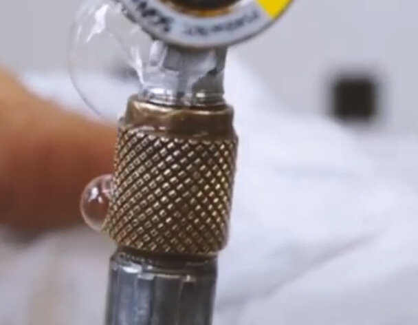

Well, if you want it to last another 10 years, the best thing to do is have a shop evacuate the system with an A/C machine. This way they can measure how much is taken out. If it's low on the amount that should be in there, then there is a leak somewhere and it should be found and repaired. That way the new refill will last, and you won't have to refill it every year. Because there's no way of telling when the leak actually started, so if it's a fill valve for example that section of line with the valve can be replaced. The fill valves are almost exactly the same as a valve stem on a tire. The one-way valve has those small seals on them that leak. If you have the vehicle off, and you put your ear real close to the valve while taking the cap off, you can almost always hear a small hiss of a leak. These leaks are overlooked most of the time because when the A/C machine is on both fill valves (High side and Low side), the leak is not detected. You can also spray each fitting of the A/C lines with soapy water in a spray bottle, and the leak will bubble up. dish soap works the best.
If the system is still running semi cold and the compressor is still cycling, you can find a leak with soapy water.
Most leaking areas are any connections, the front AC condenser in front with the radiator (they leak a lot at the soldered bent connections), fill valves, compressor seals.
You can find the leak, do the repair and then have a shop vacuum it down and refill it. Or you can just add a can and see how long it lasts. So there's a couple options here. I'll bet you can find a leak pretty quick. If you do, take a video of it for us. Here's a soapy A/C leak picture. Sorry for the long post.

I think it just needs a little Freon, no major leak. Should I add some PAG oil and what type, PAG 46 or other?
Jul 10, 2023 at 9:13 AM
No don't add any oil, the only time you add oil is when replacing a component, you drain the oil out of the part being replaced and add that exact amount back in. For a refrigerant leak, you just add the correct type of Freon. This guide will tell you everything you need to know, just add a little bit at a time while monitoring how cold it gets.
