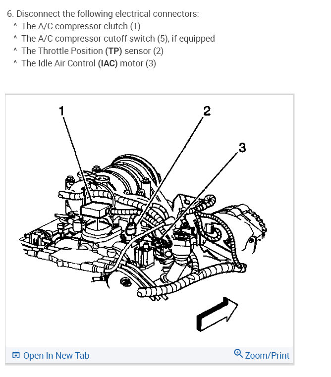

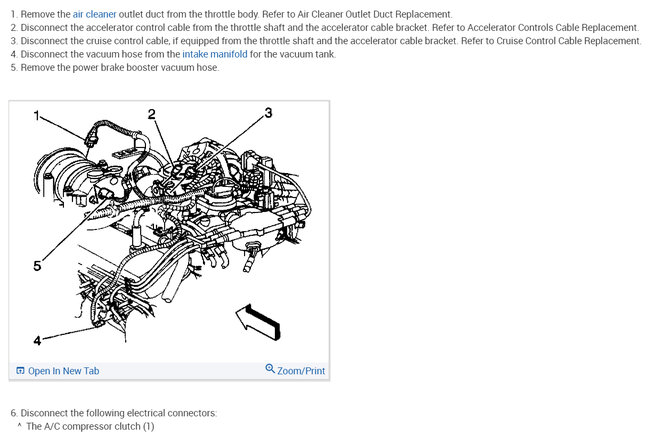

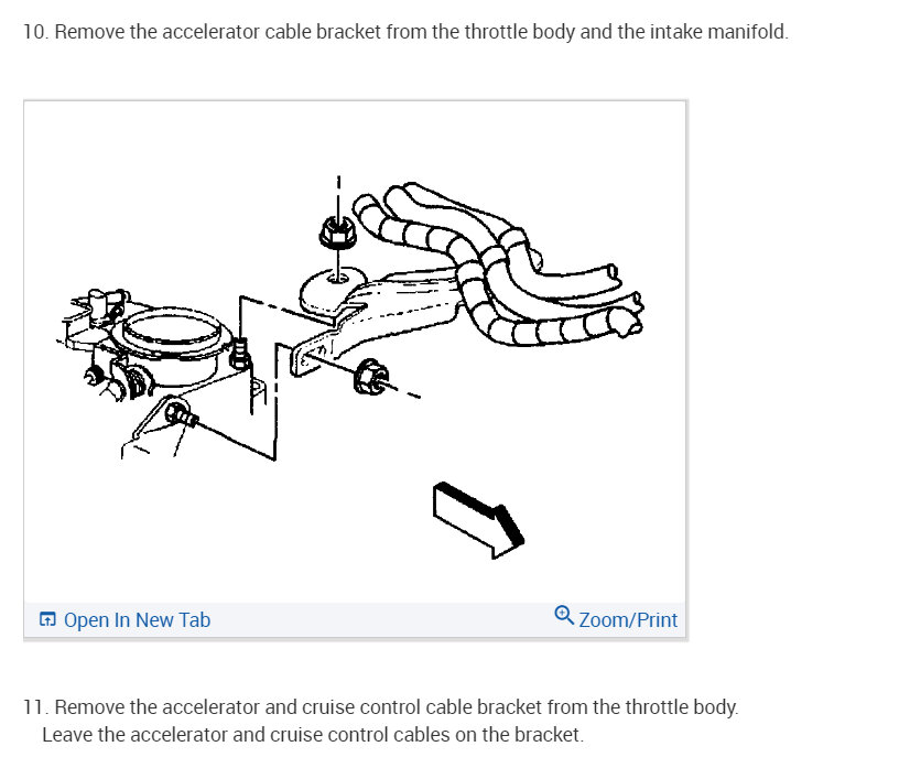

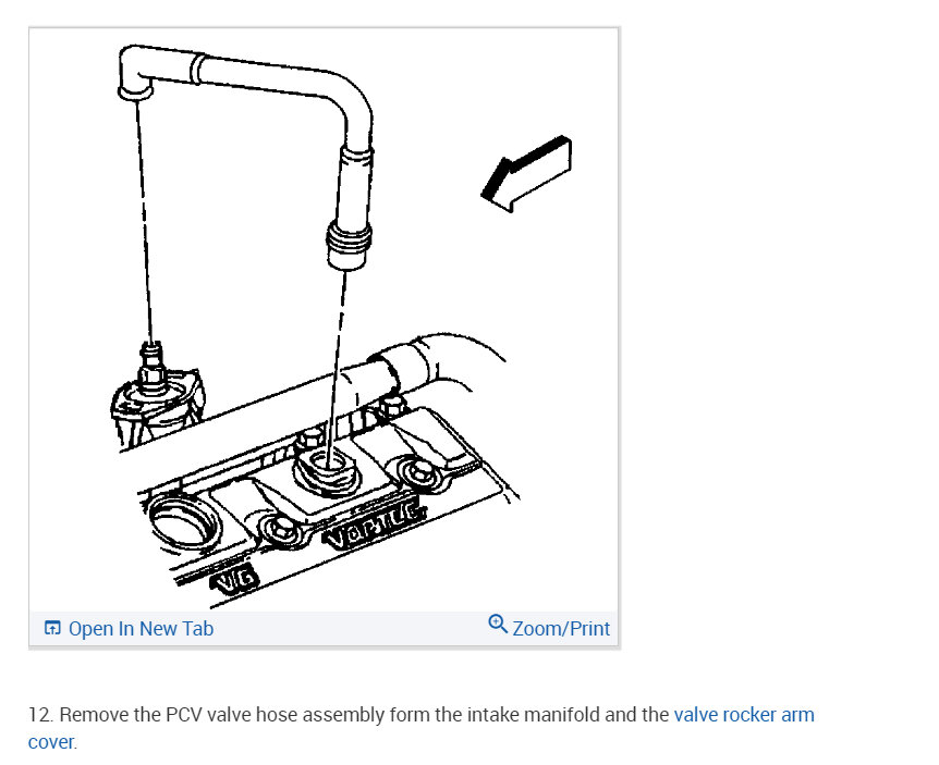

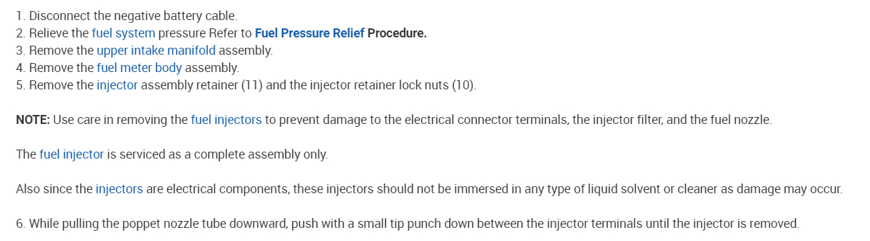

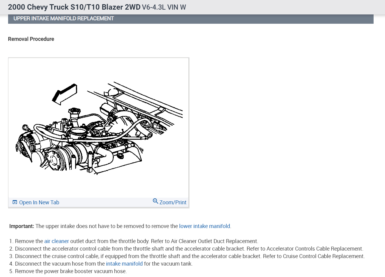

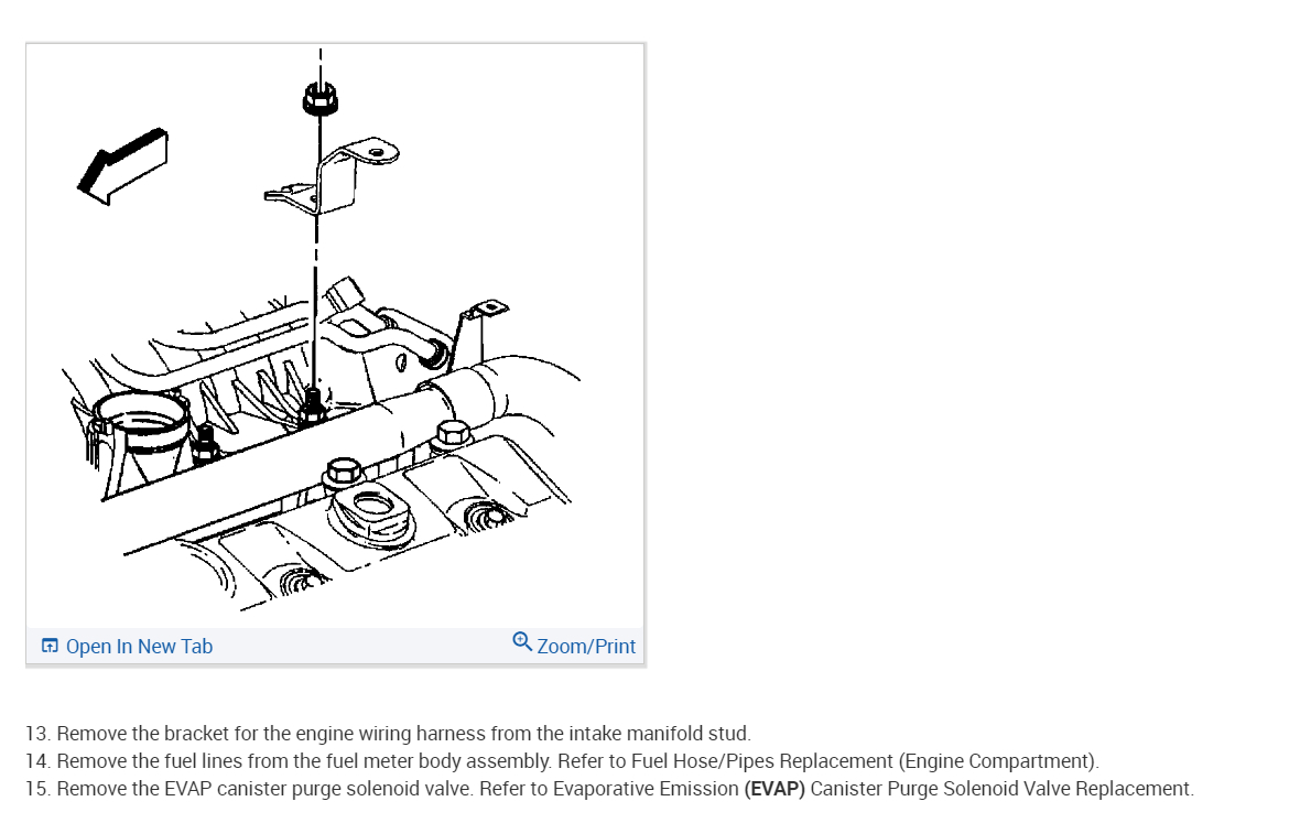

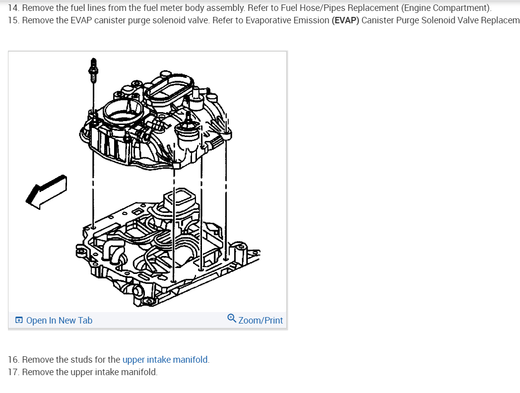

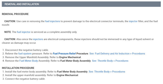

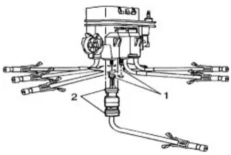

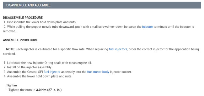

These engines had a big problem with the spider injector. Have you changed that out? Here is how the job is done. Also, this guide may help as well:
Check out the images (below). Please let us know if you need anything else to get the problem fixed.

Thank you for your reply, Ken. Your answer does not apply to my vehicle as it has a throttle body injection system with a distributor and old fashioned coil and spark plug wires. Is there a way to test for spark in the cylinder? Any other ideas why still missing? I suspect intake manifold gasket or head gasket but would like to troubleshoot to know exactly before unnecessarily taking engine apart.

Okay the system had a year split, so it happens. You can test the spark at the plug wire and replace the spark plug with a new unit in case it is cracked/defective.
Here is a guide to help you check the compression as well:
This one can help you check for vacuum leak use when the engine is cold only:
Please go over these guides and get back to us.

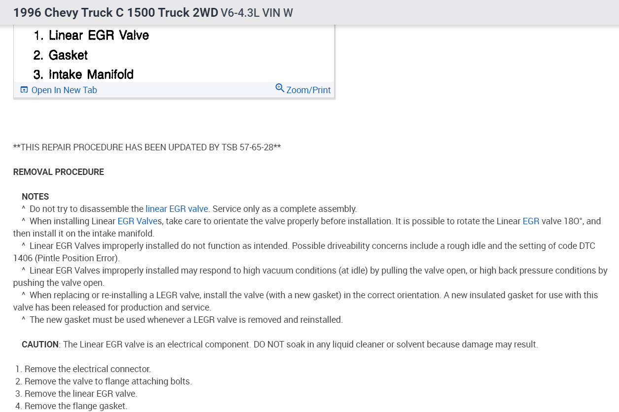

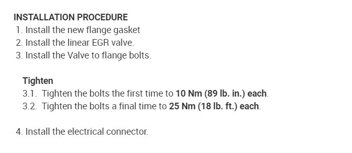

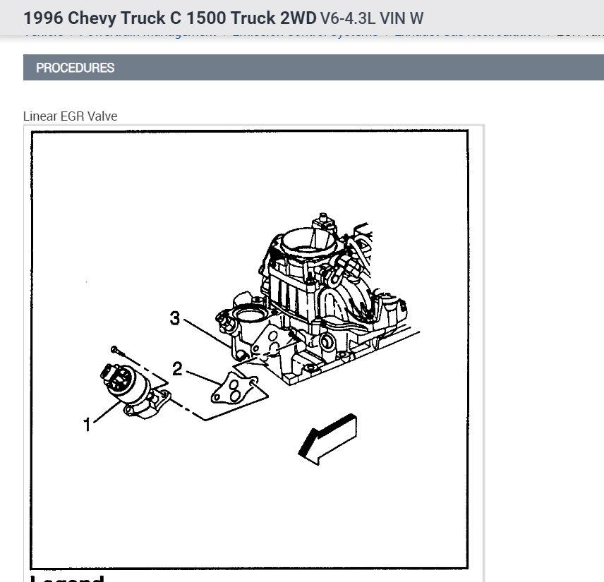

I had another thought, I have seen the EGR valve cause this problem, here is the location so you can remove it and test it by using this video. Also, it still shows this engine having a spider injector. Can you please upload an image of the throttle body so I can confirm? Please let us know what happens.
https://youtu.be/DqUCbbKdWf4
Jun 9, 2023 at 3:50 AM
BILL93240
  • 62 POSTS
I already removed the EGR valve and cleaned it with some WD40 spray, so it is not stuck and the valve springs freely. The EGR valve in the video looks different, mine doesn't have a dashpot. I will try to upload some pics of the engine this weekend if I can.

Yes, it will, you can rent a fuel pressure gauge for cheap at the local auto parts store. The spider injectors go out all the time in these engines btw. I would get the AC Delco unit.

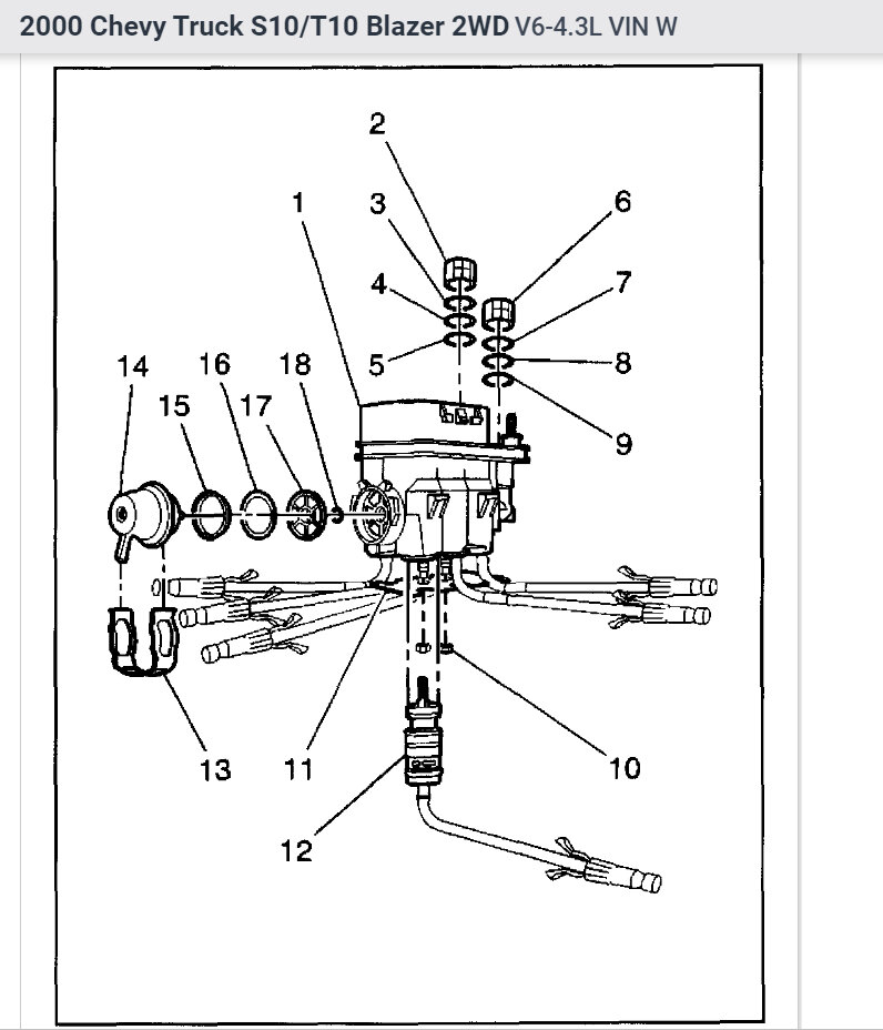

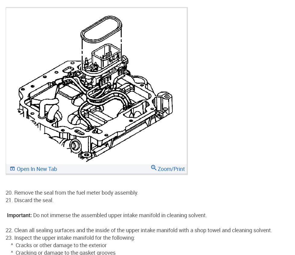

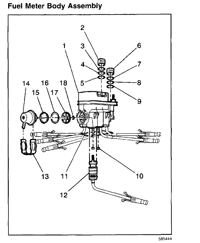

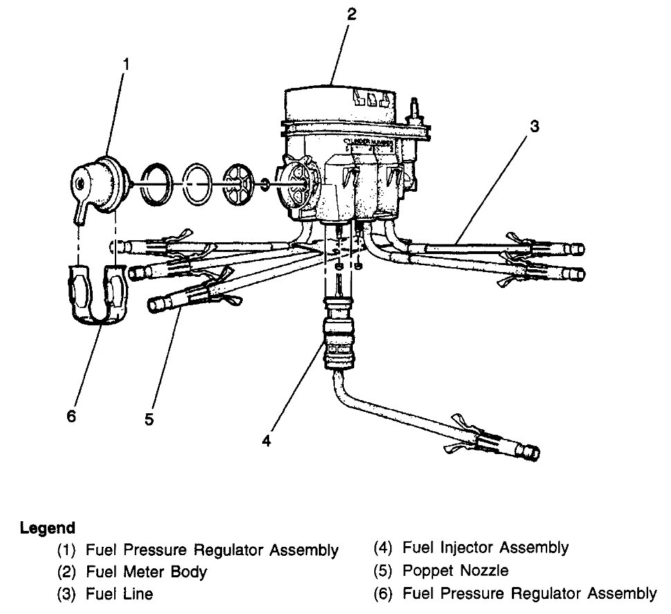

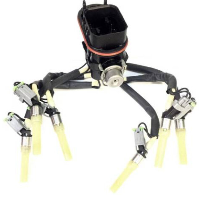

Hello these spider injection systems are known failure components, because of the plastic poppets at the end of each injector line. There is an updated kit where there are electrical wires running down to the end of each injector now. And they act as a regular port injection system. Its a huge difference and update, because these thing is just going to keep getting worse as you go. GM sells the updated unit. You just take out the entire injection unit and put the new one in. You have to bend the new lines to fit, so take your time with it, but its worth it. The truck will run a lot longer and you wont have anymore fuel injector issues at all.
Here you can see there are fuel injectors at the end of each line with electrical connectors instead of plastic poppets
Jun 14, 2023 at 2:26 AM

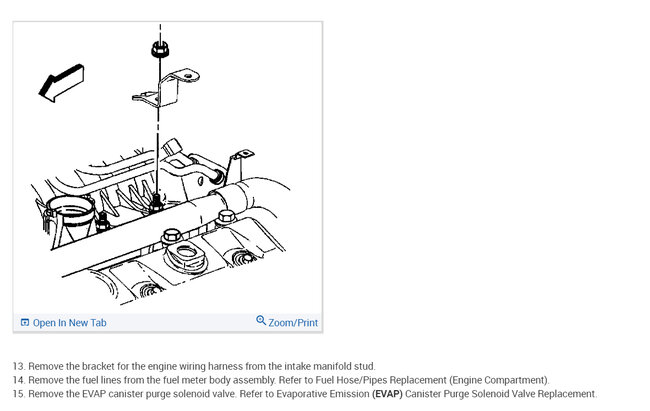

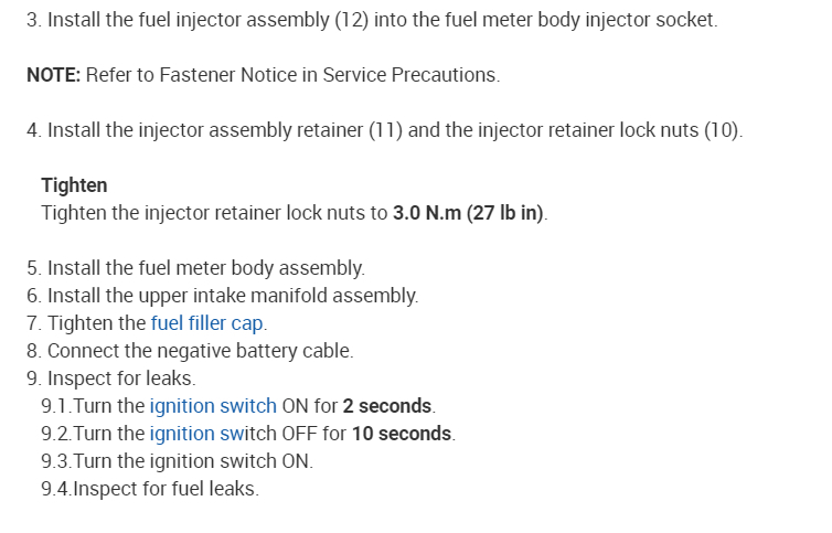

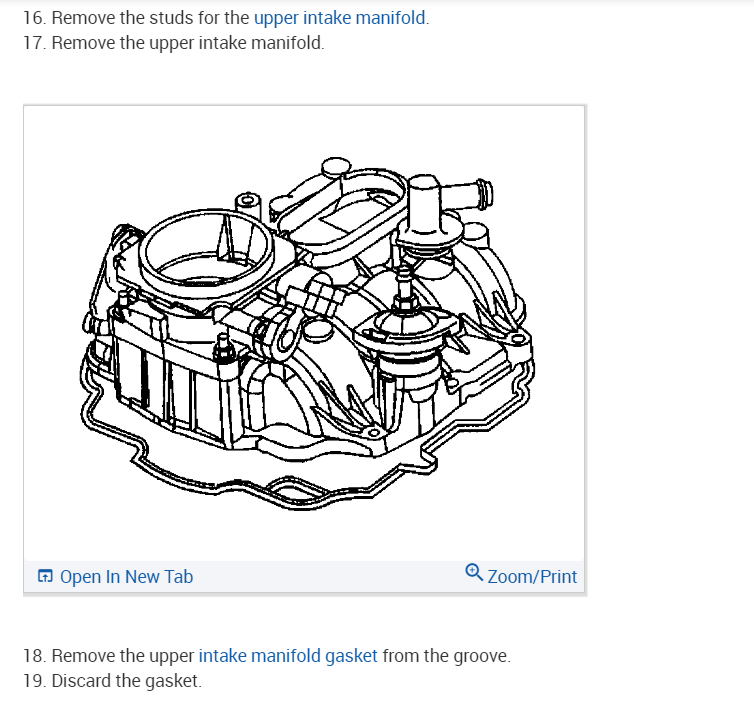

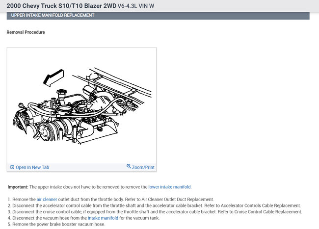

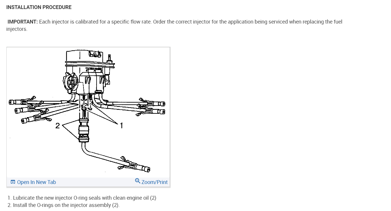

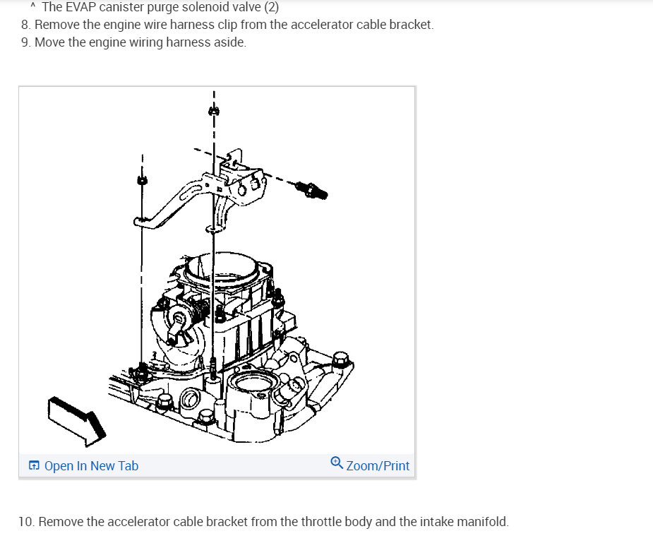

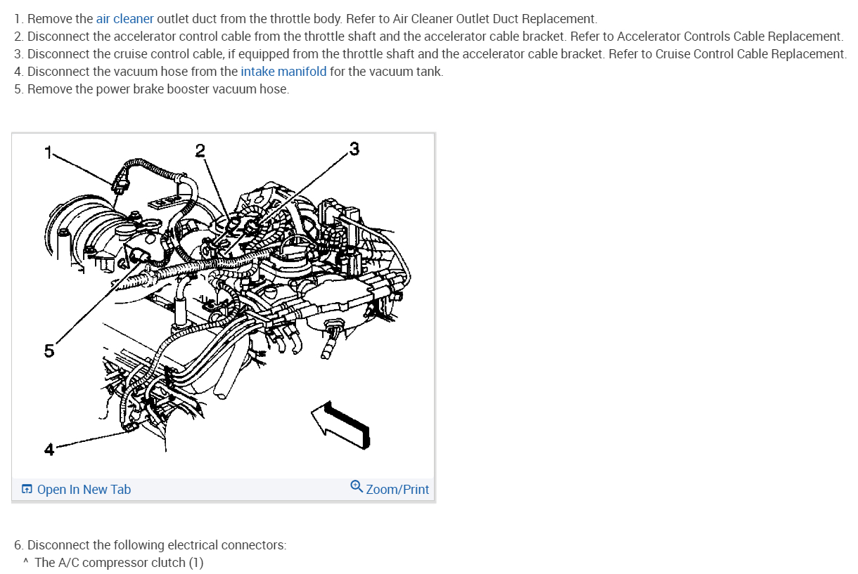

Well, I don't know if there was a recall or not, there are Technical Service Bulletins on using the correct solvents for cleaning the poppets and a revised injector balance test procedure. But they wouldn't honor any recalls from 1996. With a capable scan tool, you can do a fuel injector balance test which is what we do now for any suspected injector issues, it consists of monitoring the fuel pressure while pulsing each injector a certain amount of time, one at a time. And if there is a fuel injector that drops more or less fuel pressure than the others then you know that injector has a flow rate issue. This being a 1996, that was the first year for OBD2 switch over. I have seen the injector balance test done on these with one of the Launch scan tools I believe it was. I can check on that for you.
Below is a picture of the injection system you have now, you can see there are no solenoids at the end of the tubes like on the updated unit. This has just the poppets at the end of each tube which opens when the correct fuel pressure is reached. The solenoids are all in the upper electrical unit.

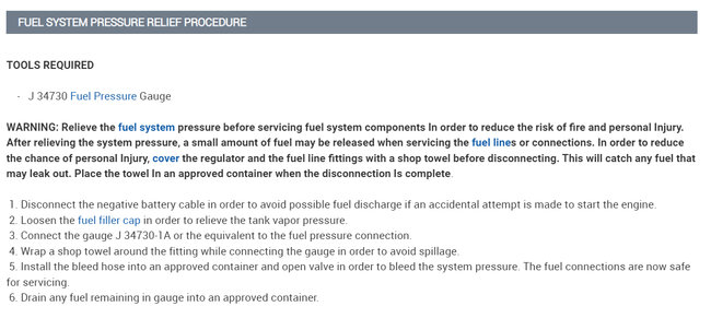

You can remove the entire unit and try to clean out each of the poppet nozzles. But as for testing, you can swap the number 2 spark plug and wire to a different cylinder and see if the code follows. If it doesn't, you can do a compression test on that cylinder or a leak down test and see if the cylinder is sealing well. Besides that, it comes down to fuel injection to that cylinder. I will dig up some info on pulling out the fuel metering unit if you want to try to clean it. For the updated unit, you can google it, it will come right up. Just put in 1996 gm updated spider injection unit. I see some from about 160 to 400 dollars. The OEM from GM would be the best, depending on how long you are planning on keeping the truck. But I will post some more info on cleaning the unit you have now shortly.

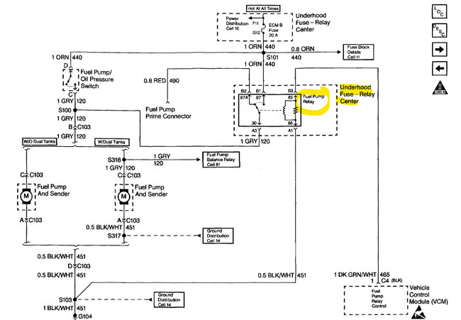

Diagrams 2,3 are for relieving the fuel pressure by pulling the Fuel pump relay and cranking the truck over, it will run for a second and then stall out. Now the fuel metering unit is under the upper intake manifold. I have never attempted to clean these units out, so I'm not sure how difficult it will be. There are probably videos on doing it but try the other testing first with swapping some ignition components to other cylinders and see if the code follows, if you do a compression test, do one cranking and then one running and compare it to another cylinder. If you have a scan tool that can read live data, you can look at the Long and Short Term Fuel trims to see if the ECM is taking away or adding fuel due to an issue. If you have an injector that is not flowing well, you will have positive fuel trim numbers, and the opposite if an injector is flowing too much fuel.
