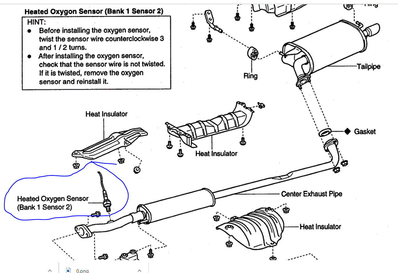

Can you please provide the procedure on how to replace the oxygen sensor on Bank 1 Sensor 2, the one after the catalytic converter? By any chance, does the passenger car seat have to be removed?

The oxygen sensor is mounted on the exhaust system and on the exterior of the vehicle. It is located after the catalytic converter and before the resonator. See pic 1 for location.
Now, because there is a wire attached to it, you can't use a standard socket for removal. You have two choices. First, try to remove it with an open-end wrench. In all honesty, they are usually rusted in place and that type of a wrench usually will round off the hex, so don't allow that to happen if it seems too tight.
Second, you need to get a socket designed for the removal and install of an O2 sensor. It will be open on the side allowing the wire to be routed out of the socket. That is the best choice of tools.
You don't need to remove the seat. Also, when looking at the attached pic, make sure to read the text in the box.

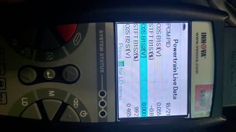

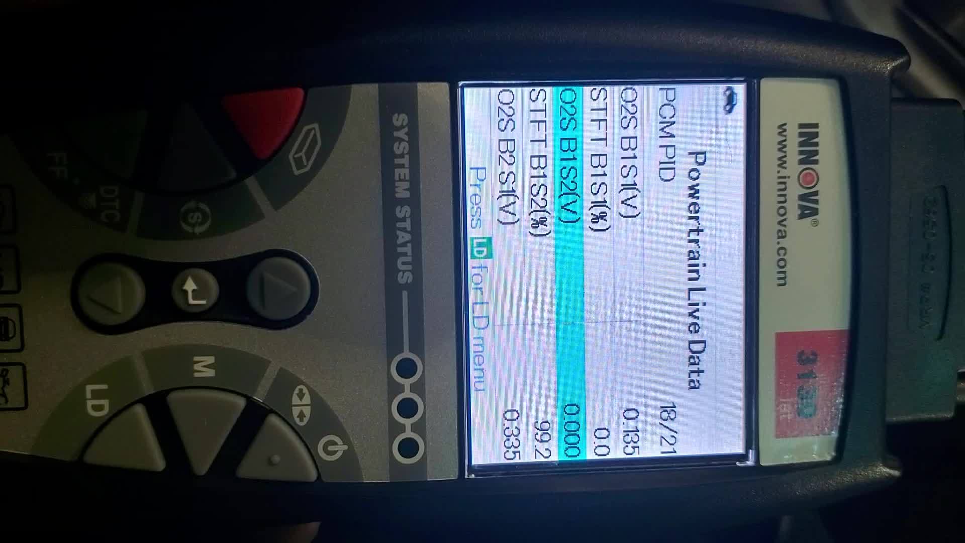

Btw, how can I even determine if the downstream O2 sensor needs to be replaced for sure? I don't have a check engine light on. The live data on my scan tool indicates that the voltage for my upstream 02 sensors fluctuate just as they are supposed to. However, my downstream O2 sensor (Bank 1 Sensor 2),which is highlighted in blue in the attached video, remains flat at zero (0.000) both at idle and with the RPM raised above 2500. So what does that tell us? Does it mean that the O2 sensor is faulty? Is it even possible that the O2 sensor could be faulty, but not necessarily trigger a check engine light?

Like I mentioned in my previous post, there is no code, in fact, there is no check engine light on. The Live Data on my scan tool indicates that the voltage for the downstream O2 sensor is zero. Have you seen the very brief video I had attached in my previous post?

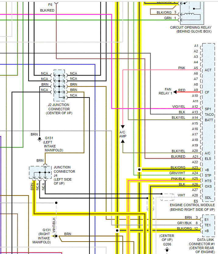

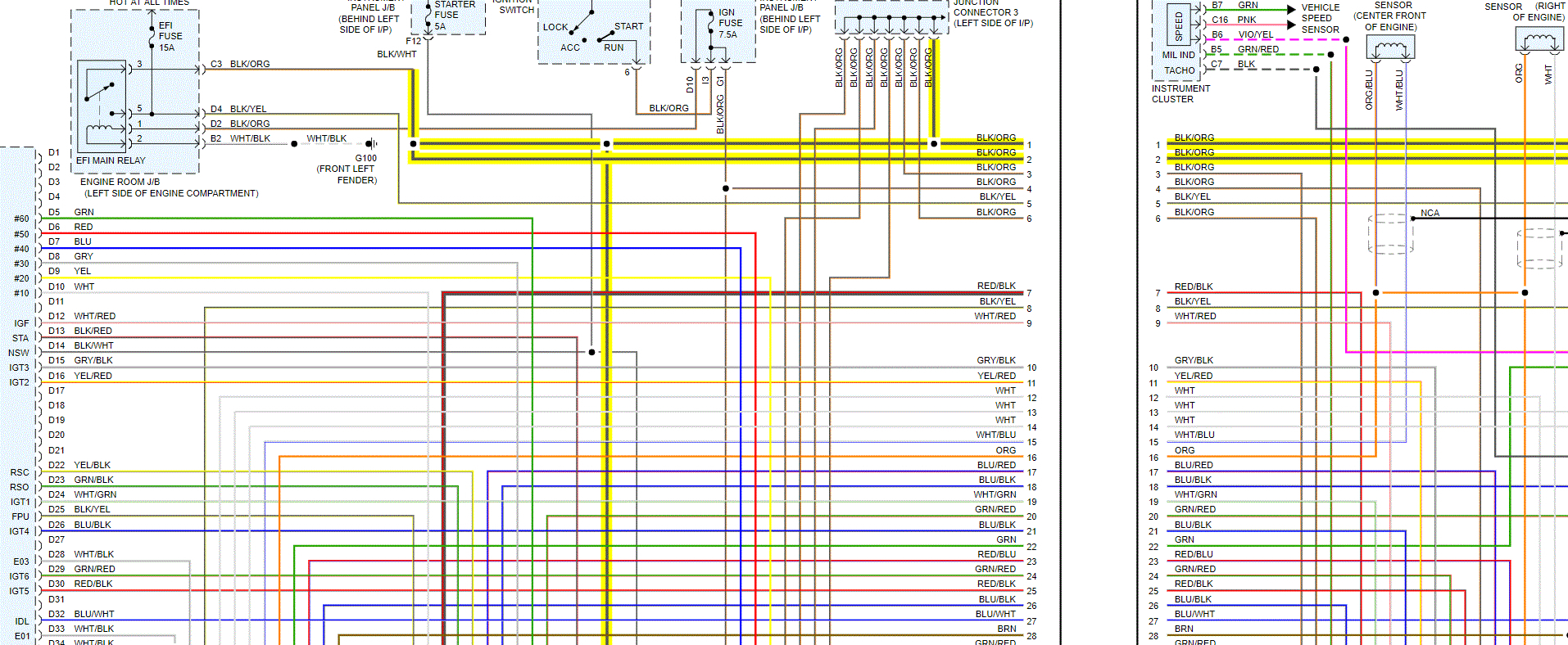

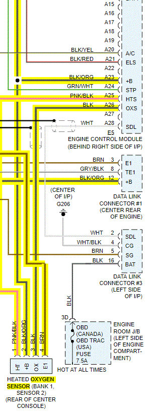

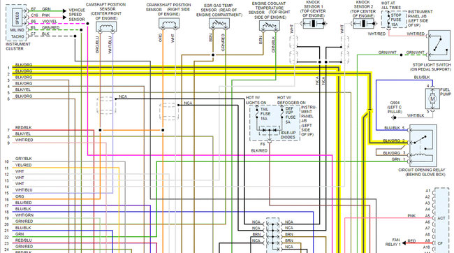

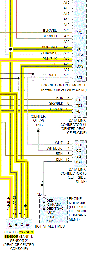

  • 110,248 POSTS

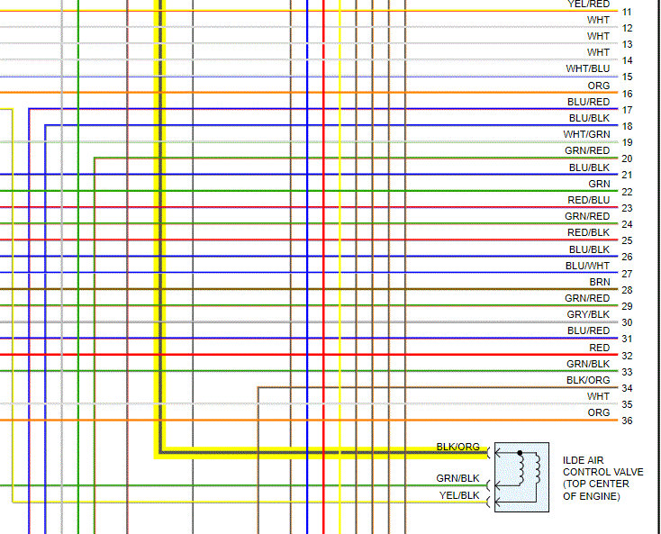

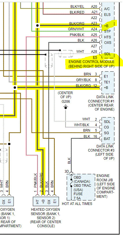

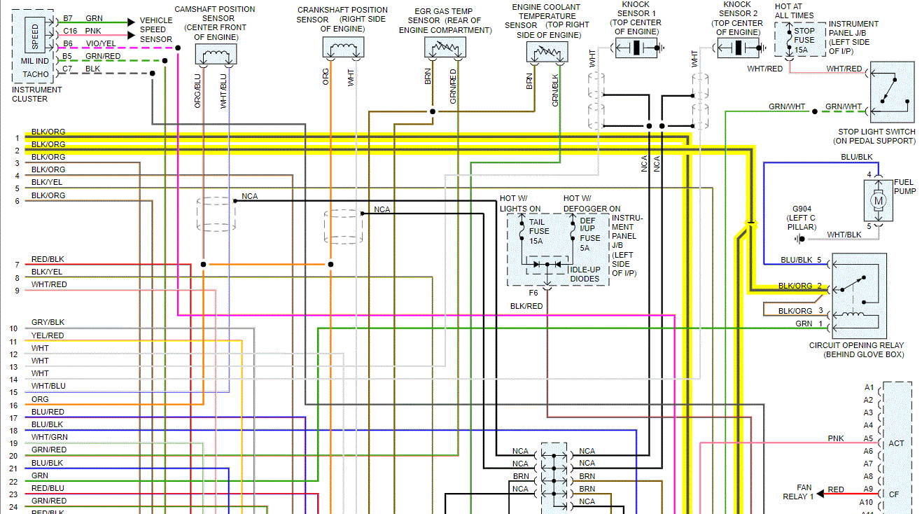

When I trace wires, I have to follow a wiring schematic. They don't specifically tell you where the wire runs through the vehicle. However, it shows where the wires go to.
I attached several pics below. I started at the O2 sensor in question. I highlighted the wires from the sensor and traced them throughout the schematics so you can see where each wire goes. I don't know if it helps, but take a look through it and see if it helps you find the locations where the wiring goes. The pics are in order. If you could picture them laid out, one on top of the other, that is what I had.
I hope it helps.

Just so that I understand, is the purpose of tracing the wiring is to conduct a continuity test or is there something else? As far as this car is concerned, there is no functioning downstream O2 sensor. Hence, what would be the downside of driving this car without a downstream O2 sensor?
Please let me know if I have this correct. From what I can figure out looking at the schematics, #1 (pink/black) and #3 (black) wires are connected to the ECM. The #4 (brown) wire is connected to the Junction Connector, where in the world is that? Is there a diagram that shows its location? Now, when it comes to the #2 (black/orange) wire, it's very confusing, because it seems like it's connected at several spots. Can you please explain what the deal is with that wire? Where is it connected to in reference to the downstream O2 sensor.
Thank you!
Cheers!
Apr 6, 2021 at 4:59 AM
  • 110,248 POSTS
The brown wire is connected to those things under the instrument panel (see pics). The black/orange does jump. It branches from the circuit relay.
My manual doesn't show exact locations. Just general ones.
I hope you understand. As far as driving without that sensor, the car will run fine, but you may notice a decrease in fuel mileage. That is how the computer determines the air-fuel ratio that is needed.

From what I understand, the voltage for the upstream oxygen sensors is supposed to fluctuate between 0.1 - 0.9. For the downstream oxygen sensor, my understanding is that the voltage is supposed to be steady, however, what kind of voltage should I see? At one point, for the voltage, I saw a reading of 0.020, 0.015, and 0.010 briefly. What does that mean?
I conducted a continuity test for the downstream wiring that are connected to the PCM and they all passed. What should be my next step?

  • 110,248 POSTS
There should be a 5 volt reference to the sensor. The ohms should be between 11 and 16 ohms.
AVALON1995
  • 121 POSTS
Is it supposed to be 5 volts or 0.5 volts?
As I mentioned, the continuity test passed and the resistance was within spec. So, at this point, what else should I do to rectify the issue?
  • 110,248 POSTS
Since this is sensor 2, it should remain somewhat steady around .5 volts.

AVALON1995
  • 121 POSTS
Let me recap some things for you, since it looks like you may have forgotten the details.
There is no code whatsoever and there is no check engine light either. The live data on my scan tool indicates that my upstream oxygen sensors are in good operation as their voltage fluctuate between 0.1- 0.9. However, for my downstream oxygen sensor, the voltage remains flat at 0.000 and that is where the issue is. At one point on a different day, the voltage reading was briefly at 0.015, but almost all the time, it remains flat at 0.000. I have attached the video for your reference again.
The resistance for the downstream oxygen sensor falls within spec and the continuity test for the wires that are connected from the wiring harness to the ECM have passed.
So, at this point, what else can I do to troubleshoot why the downstream oxygen sensor shows no voltage? Would replacing the oxygen sensor resolve the issue despite the resistance falling within spec?
