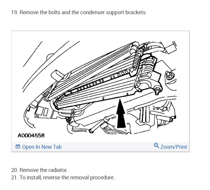

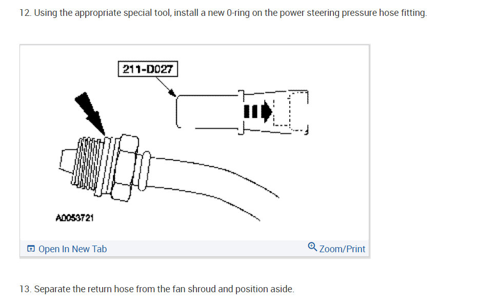

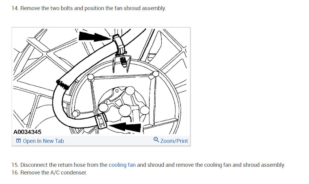

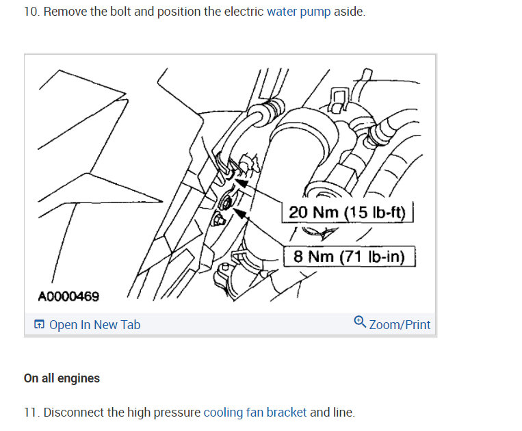

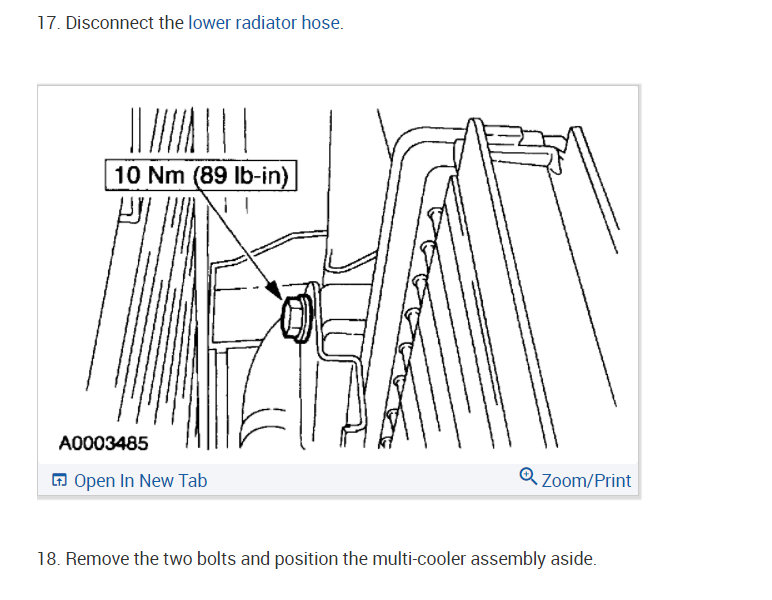

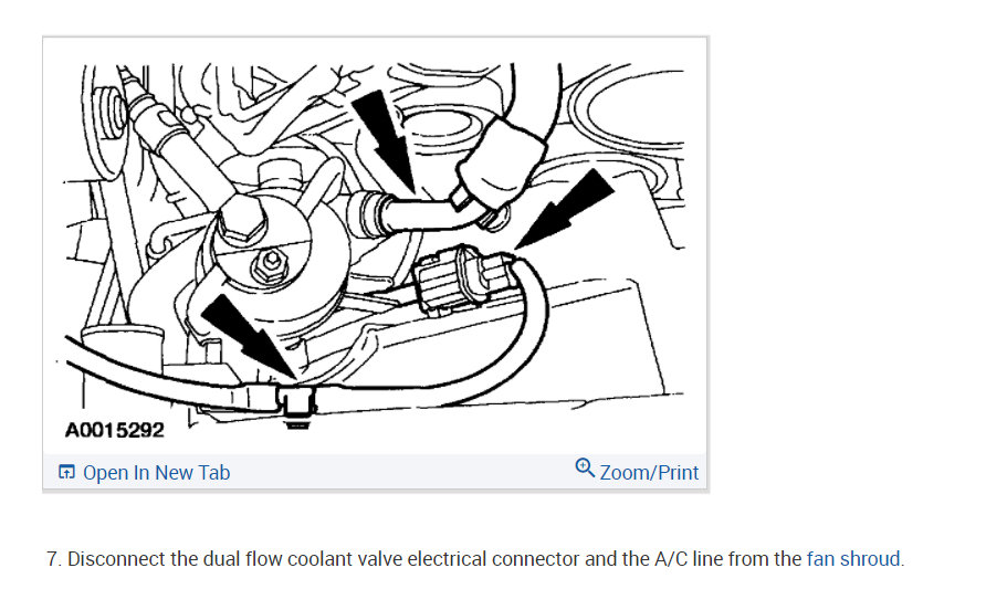

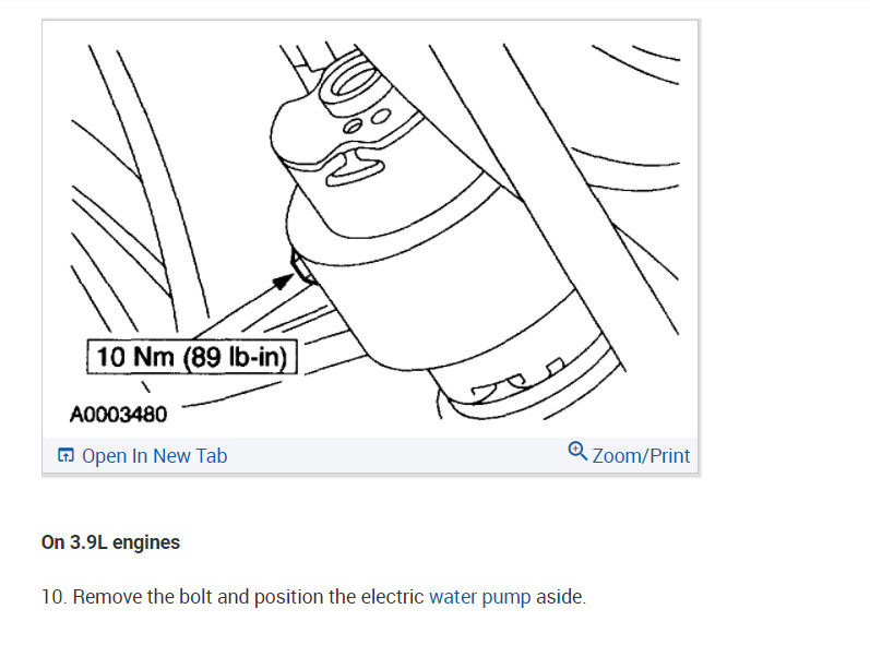

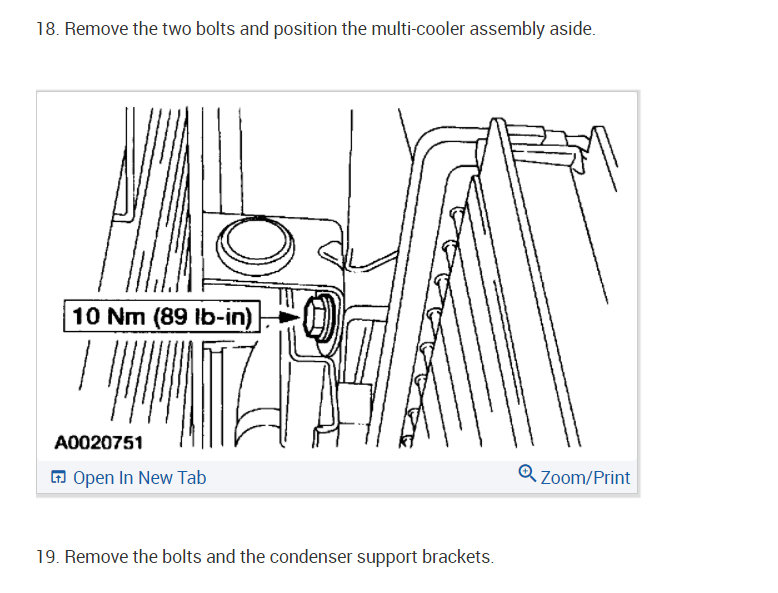

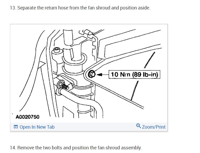

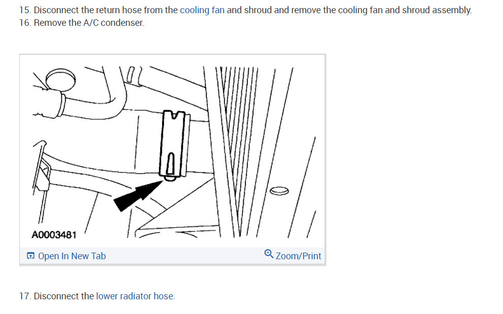

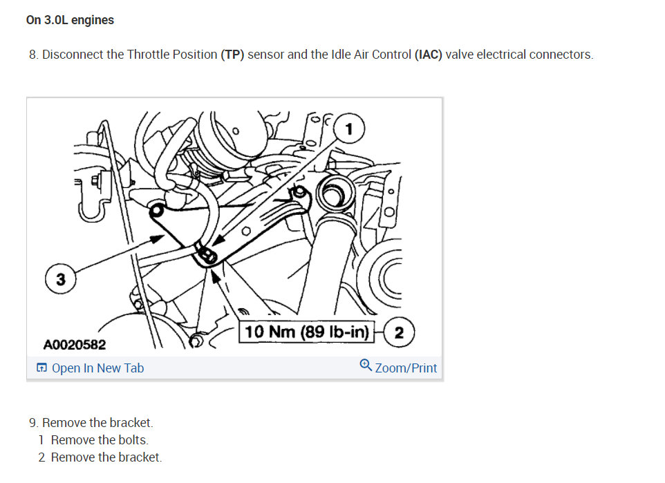

Good morning,

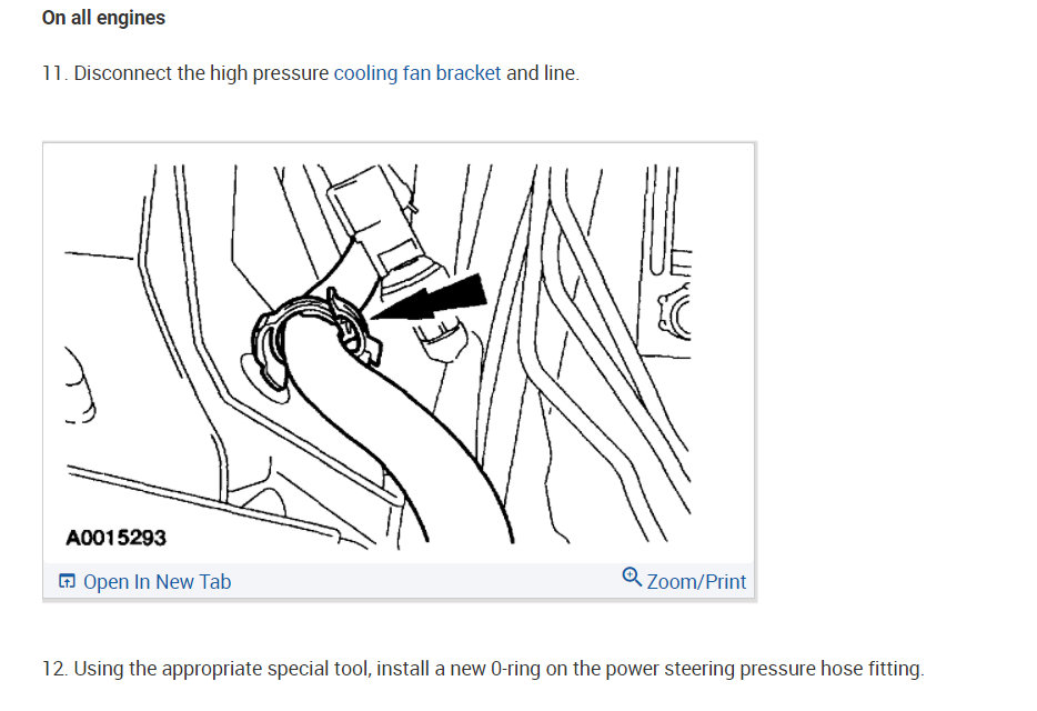

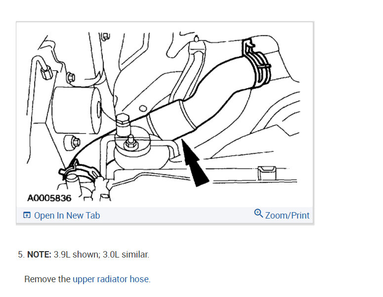

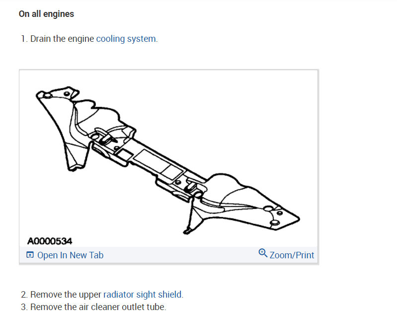

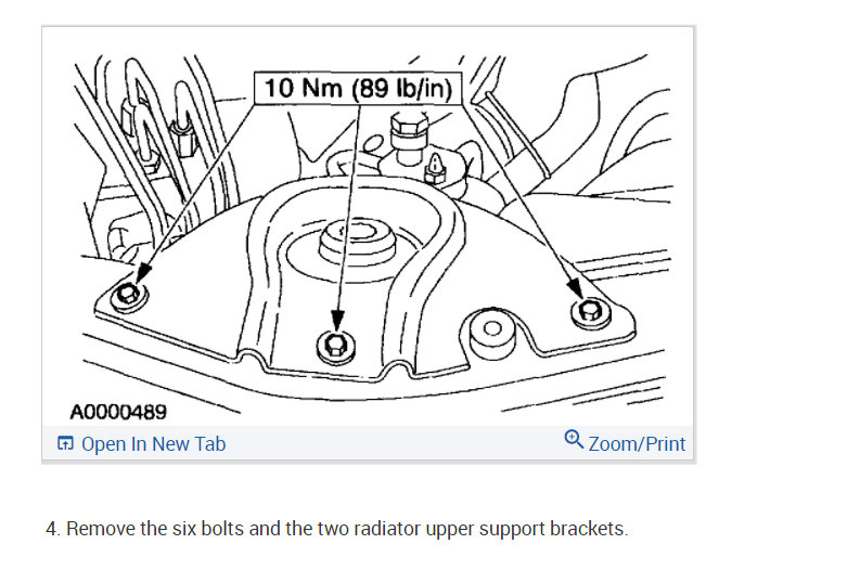

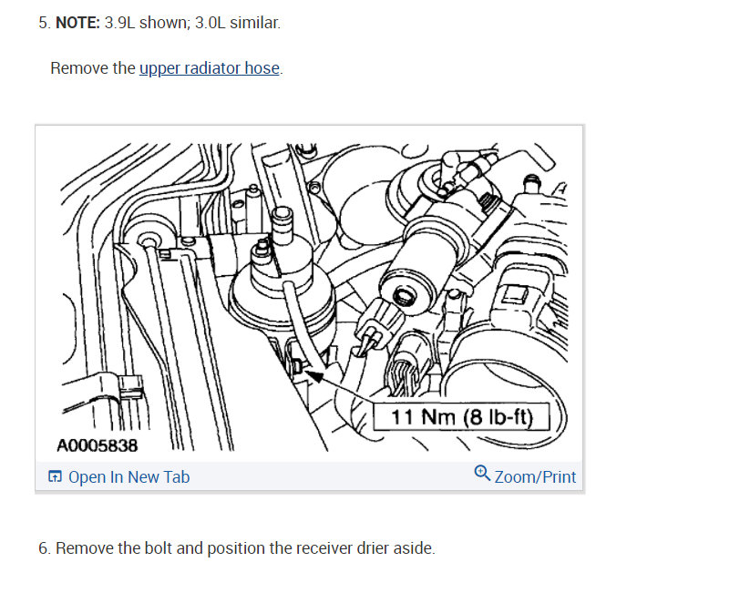

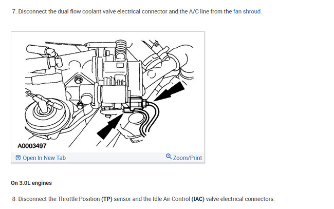

From your description, it sounds like the radiator is clogged with debris.
Normal flushing does not get rid of the debris. It needs to be rotted out. The issue with that is price. It is cheaper to replace the radiator than have it rotted out.
https://www.2carpros.com/articles/how-to-replace-a-car-radiator
I attached the procedure below for you to view.
