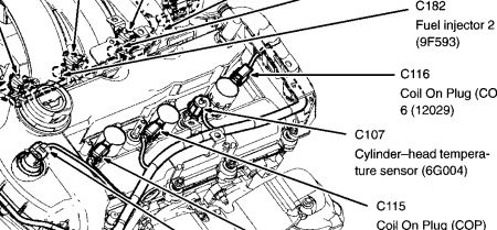

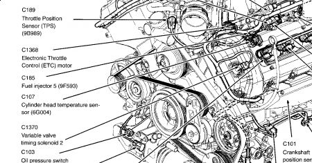

do you know the location of the CHT sensor i have a pictrue but it look like it was under valae cover it is not there.i think i found the plug,it runs under the platum.i may have to take that off?
updated 4/14/10
i found it under the platum left side thank you.I think i got the turh from
the kid.He said he has been driving the car with the light on for 5 weeks went in fail safe mode and then he over heated it.I got it and pull codes p1299,po356 coil,po302 cly.2 misfire.p2110 TAC System Force Limited RPM,p2107Throttle Actuator Control Motor Procssor.I put in new coil cleared all codes P 1299 came back,put in new CHT sensor unhook battery no codes.Road test fail safe mode back on?no codes any way to reset this fail safe mode?
Apr 14, 2010 at 6:06 AM
2CARPRO JACK
  • 11,533 POSTS
3.0 L engine it is under rocker cover, 3.9 it is under the intake, and yes the manifold has to be removed to change it.
https://images.2carpros.com/forum/automotive_pictures/1639_30l_1.jpg
https://images.2carpros.com/forum/automotive_pictures/1639_39l_1.jpg
Apr 14, 2010 at 6:45 AM
