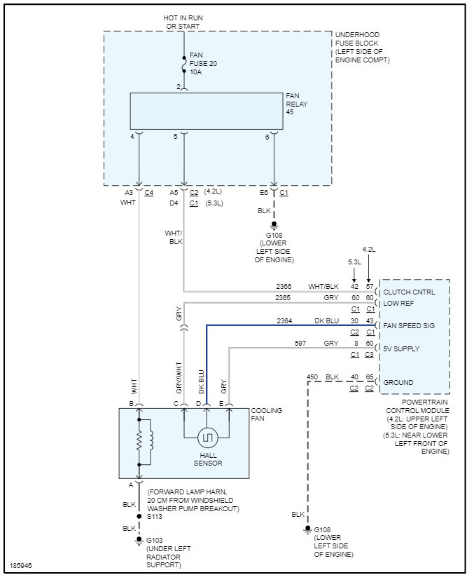

I was driving down the highway doing about 65 and noticed temperature gauge starting to rise, that was early this morning. so, I pulled over to let the truck cool down added fluid and went on my way. it's has been 3 or 4 times now overhearing the truck seems to run fine but here the past couple days when I start truck it's shudders a little then shuts off. I have to do this like 3 times before the truck stays running and runs fine... any ideas would be greatly appreciated, thank you..

It sounds like you could have a blown head gasket, but can I ask when the engine is overheating. can you hear the radiator cooling fan working? If not, I would check the fan fuse #20 under the hood, if so, let's do a head gasket test by following this guide:
This guide may help as well:
https://www.2carpros.com/articles/engine-overheating-or-running-hot
Here are the wiring diagrams for the cooling fan so you can see how the system works. Check out the images (below). Please let us know what happens.
