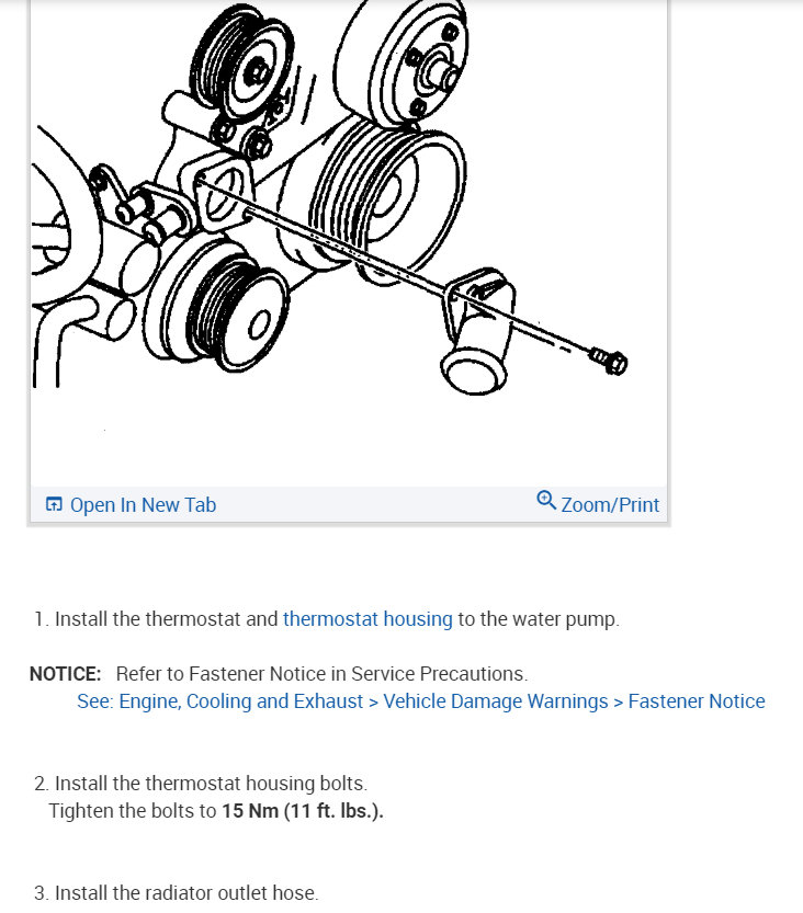

My truck just started over heating. It runs good but the temp gauge rises very fast. Whats going on?

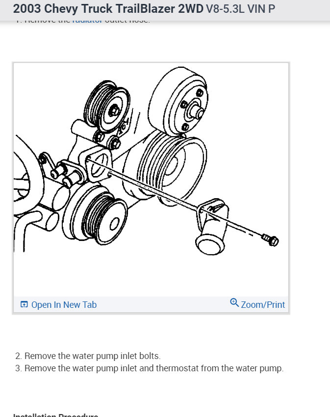

This sounds like the thermostat is stuck closed which is common here are two guides to help you fix the problem with diagrams below to show you how on your car.
This guide will walk you through the repair with diagrams below.
and
https://www.2carpros.com/articles/engine-overheating-or-running-hot
Check out the diagrams (Below). Please let us know what you find. We are interested to see what it is.

Thank you for this post I had this problem and had to get a thermostat from Amazon for $32.00 all fixed I love this site.

In the fall temperature gauge started to raise I have yet to let it overheat. It was okay in winter because of cold temperatures. Now that it is hot out have to address the issue. Top heater hose from radiator is warm bottom will burn your hand is this a sticky thermostat? I don't have the money to chase problems on this car. I have had it for eleven years.

Verify cooling system is full. If low on coolant then pressure test the system to check for leaks. If any leaks then repair and recheck. Verify fan is working properly. If all is okay then replace the thermostat.
