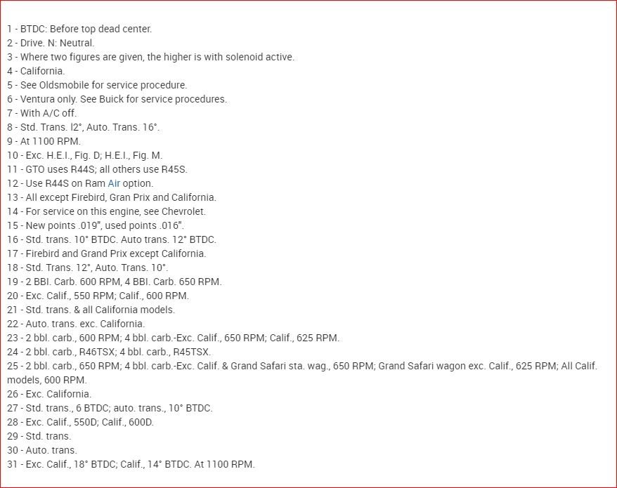

My car runs about 240 during highway drives, when I slow down to get gas the car heats up and then vapor lock occurs. I have replaced the radiator to a four core, water pump to a high flow, replaced the thermostat to I believe a 160 or 180 degree or less in an attempt to keep the car running cool. Flushed and replaced the antifreeze. I also replaced the clutch fan, with a new one. The car still runs hot and continues to vapor lock when running slow or in bumper to bumper traffic. I need help!
May 30, 2019 at 12:19 AM
Hi Issac,
Nice car.
Where do you have your timing set? I have battled a number of older cars and overheating and come to find out, it was the idle was the issue. Basically, it is running too rich and gets hot quick.
The last one was my father in-laws 1956 Lincoln Mark II and it did exactly what yours does. I bumped the timing up and overheating stopped.
Main reason I would look at this is because it seems like you addressed everything in the cooling system.
If this doesn't pan out, your only option may be putting a high speed electric fan on it or even a pusher fan in front of the radiator. However, before going there, get an infrared temperature meter and check all around the engine and make sure you don't have a restriction.
Let me know what your timing is set at and we can go from there.

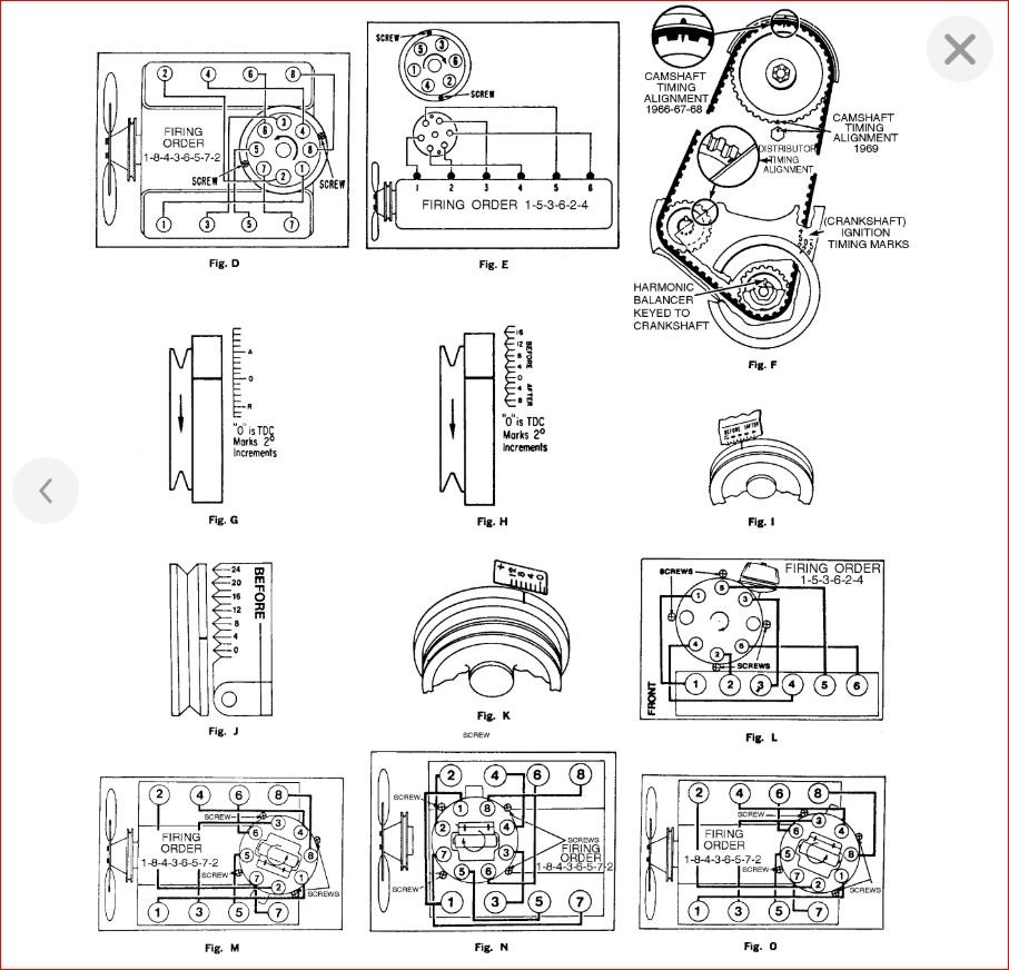

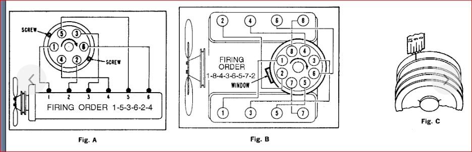

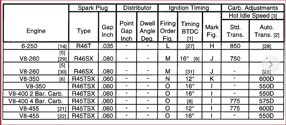

Thank you for the suggestion, would that entail using a timing light and shining it on the engine marks? I’m not a very experienced backyard mechanic. Please let me know and thank you.
May 30, 2019 at 11:14 AM
Yes. This is exactly correct.
Here is a video that takes you through the entire process. They get very detailed but the important thing you need to follow is how to set the light up, how to check the base timing (idle/initial), then how to adjust the timing by moving the distributor.
One important thing when setting your base timing is to remove your vacuum line from the distributor. This is the vacuum advance and will effect your setting so you want this unhooked.
Once you set your base timing, the advance will take care of itself. I suspect that your base timing in low which is causing your total timing to be low which is why you are overheating while driving down the road.

Okay. We need to go back to how the engine is tuned and running. The engine may be running well but if the cooling system cannot keep the engine cool then it is most likely tuned to rich. I mentioned it earlier but I fight vapor lock on my father in laws 1956 Mark ii. The cooling system is not the issue, but when I bump the timing up a little it runs better and cooler.
Where is the base and total timing set? I know you had it checked but I am wondering if you can advance the timing and see what happens with the vapor locking?
