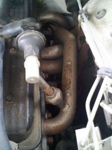

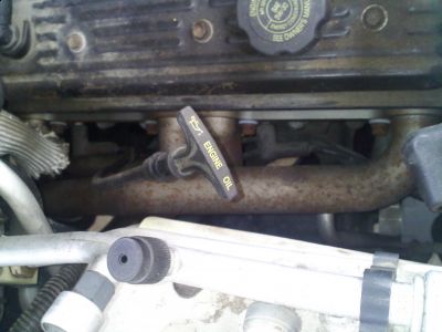

DRACOGI123
I have a 1993 Trans Am, after I installed headers I noticed that the car started running ruff and hesitated when I accelerated. Need help please, what should I do. Thank you so much in advance.....
Jan 9, 2020 at 4:34 AM (Merged)
DOCFIXIT
  • 18,828 POSTS
Where O2 sensors installed?
DRACOGI123
Good question, I'm not sure unfortunately I did not install the headers so I'm not sure where the 02 Sensors were installed. I have uploaded some pics for better view. Thanks you so much....
https://images.2carpros.com/forum/automotive_pictures/426147_Left_Side_Header_2.jpg
https://images.2carpros.com/forum/automotive_pictures/426147_Right_Side_Header_1.jpg
DOCFIXIT
  • 18,828 POSTS

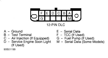

Going to need to jack up and see if O2 is installed. Also check for codes find ALDL under dash next to column.
https://images.2carpros.com/forum/automotive_pictures/198357_Graphic_224.jpg
jumper from term A to B key on engine light will flash. so flash, flash pause flash is 21. post codes
