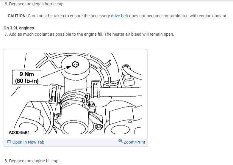

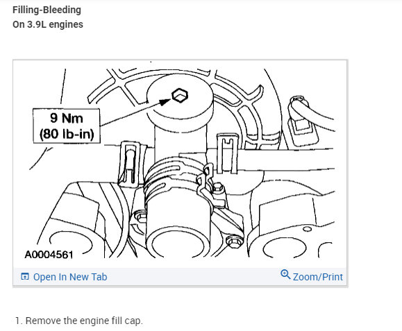

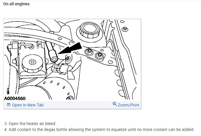

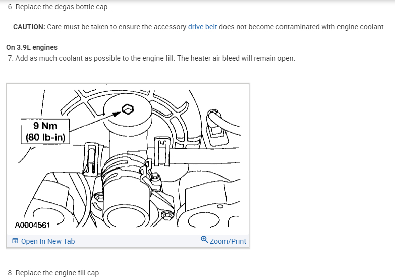

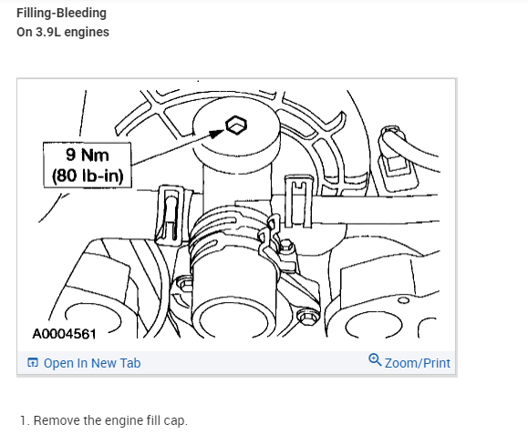

The idea that the upper hose collapses is interesting. Is the hose in good condition? Also, have you ever replaced the radiator cap? When it does this, it leads me to think there isn't enough coolant in the system. That would also explain the heat.
Since the heater is all over the place, something is either restricting flow, we have a weak pump, low coolant, or there is still something blocking it.

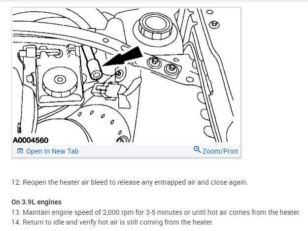

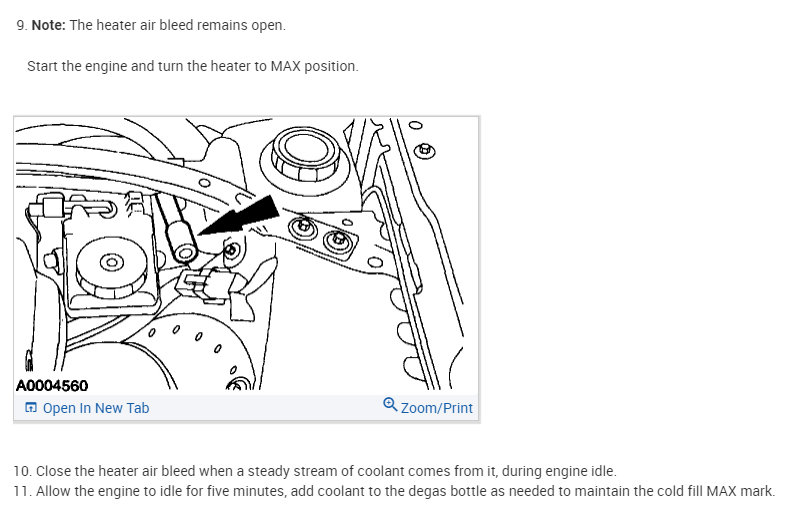

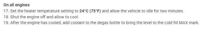

Take a look at the pics below. They are the bleeding procedure I have. See if it is the same as what you are doing.
Aug 28, 2022 at 12:59 PM
ONEARMROG
  • 8 POSTS
Hoses are less than 3 months old and bled a tiny bit more air out, top hose was full and firm some heat from heater. I drove a 5-mile trip then five miles back. got on the highway and nailed it with no increase in either coolant temperature or heat. There is no real radiator cap, there is an engine fill cap and i have replaced that entire assembly and a degas bottle or reservoir and bought a new cap for it last night and installed it this morning the bleeding procedure is burned into my brains. I was able to acquire a shop manual and have bled this many times in the last 4 months, but did have 3 questions, they tell you to fill the reservoir until it equalizes and you can't fill anymore, I have no idea of what that means then it says to open the bleeder until it runs steady, but how far do I open it because i can make it run steady by how far i open it and if getting air in the system is so critical. why do they tell me to put the cap on and fill as needed while bleeding the air?

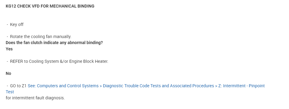

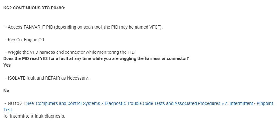

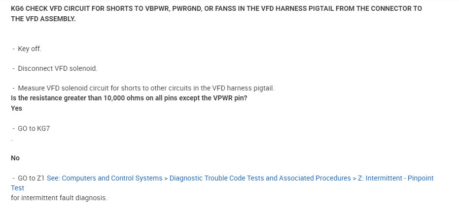

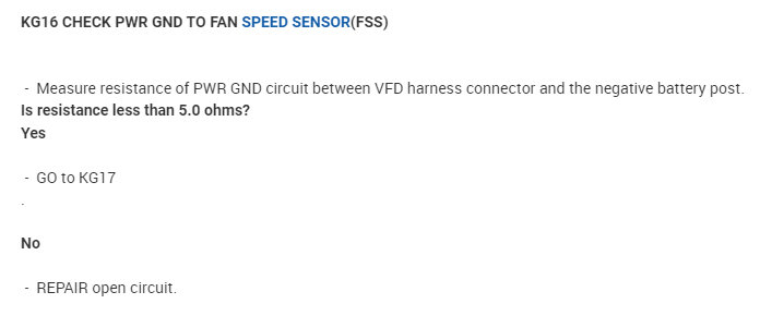

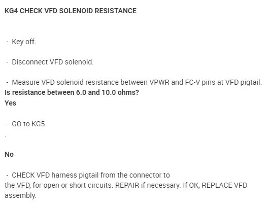

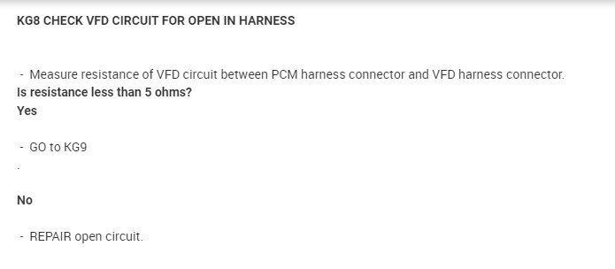

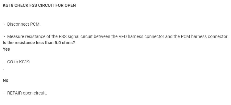

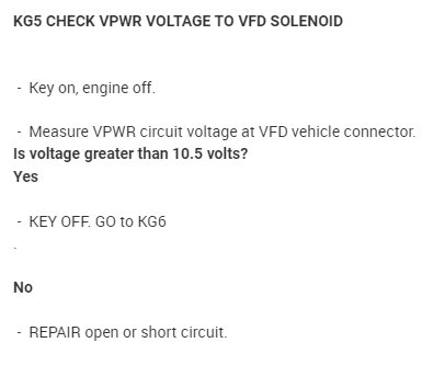

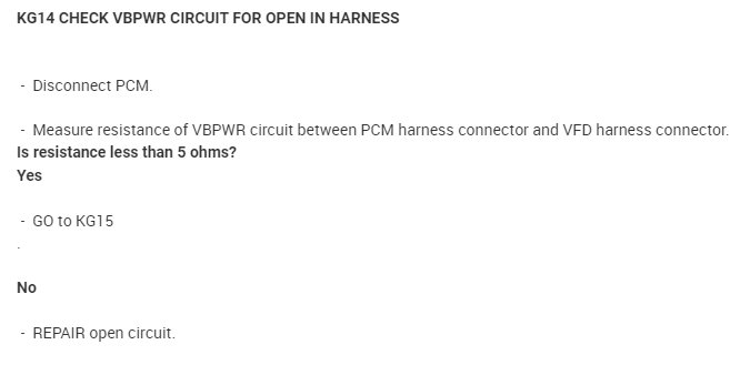

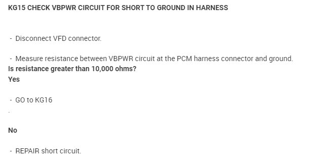

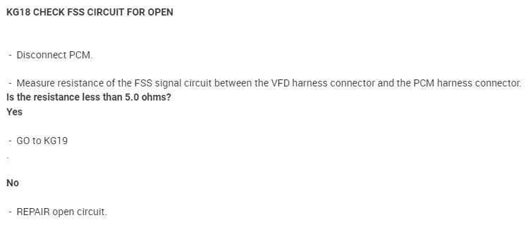

Like i said before, i think it may be a loose or cracked impeller in the water pump or my fan never seems to speed up with temperature and the actuator that sends more voltage to the solenoid to feed my hydraulic fan may have failed. I'm just looking for a way to discount or verify something so I can proceed onto being one step closer to being able to tear into this.
Aug 28, 2022 at 6:09 PM
  • 110,240 POSTS

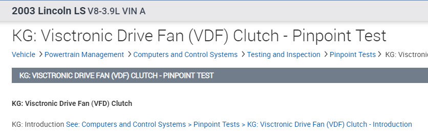

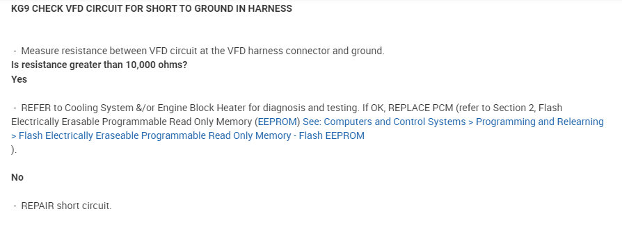

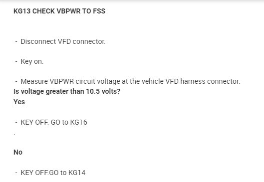

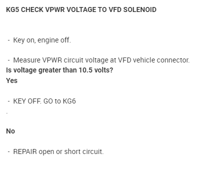

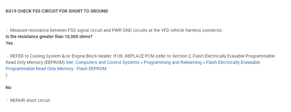

If the fan doesn't seem to respond, that doesn't sound like it's working. I agree. However, it shouldn't overheat at highway speeds.

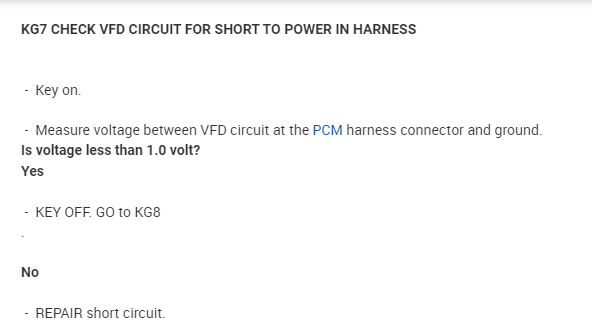

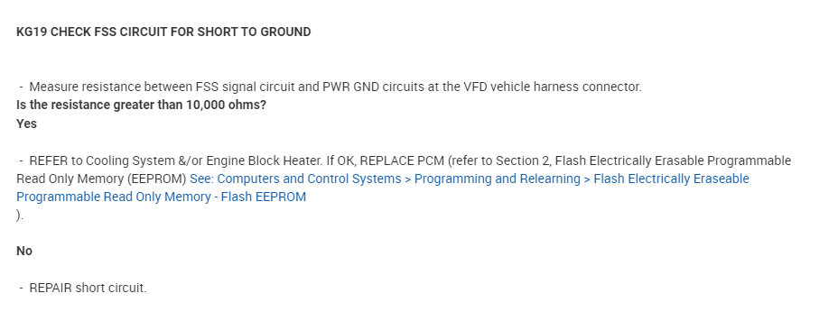

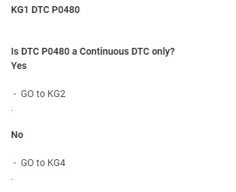

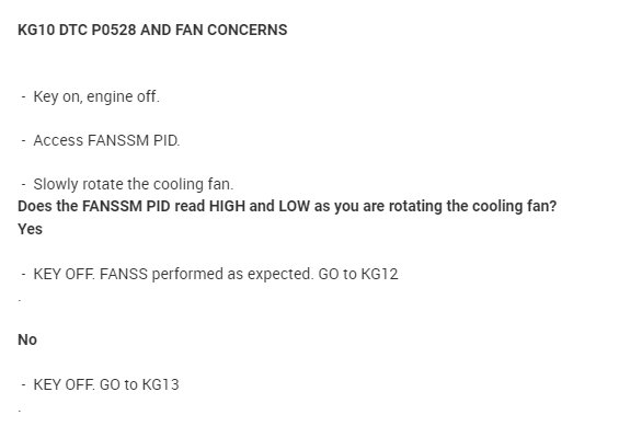

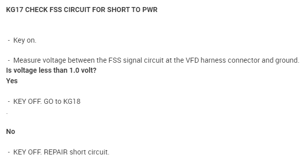

As far as the visctronic drive fan (VDF), I attached the diagnostics below to check the fan and the circuit. Normally, where there is an issue with the circuit, it will set a diagnostic code. That is what the diagnostics are indicating.
Take a look through the tests and let me know if you have questions.
See pic below.

Okay, i understood zero of that. I feel that if I could you would be contacting me for diagnostics not me contacting you. Car was getting close to overheating this morning and pulled over and let it run I still don't know how far I'm supposed to open the bleeder but opened it a little and Air was coming out so kept opening it and a lot of air and water was coming out did that several times and it cooled down on its own drove home did a little more and am going to do some more here in a minute. There are too many parts of the bleeding that I'm not clear ion # how far do i open the bleeder #2 how long should there be a steady stream running out of it before i close it, and how long should i have to wait for that to happen, what if it never achieves a steady stream or what if i open it too much , is there a too much ?? could be bleeding it according to the procedure bit since those two areas are not clear it may not be getting the air out, also when i shut my car off the AC receiver seemed to be vibrating so i waited and wiggled things around its coming from the ac drier or something attached to it so i turned the key on and off without starting and it stopped.
Sep 1, 2022 at 4:16 AM
  • 110,240 POSTS
The A/C issue is likely just the result of pressure in the system. As far as the bleeding goes, open it as far as needed for air to escape. Once you get a steady flow of coolant, you can shut it right away. If you are still getting air out of the system, that is the likely cause of the problem.
Let me know how it turns out.
