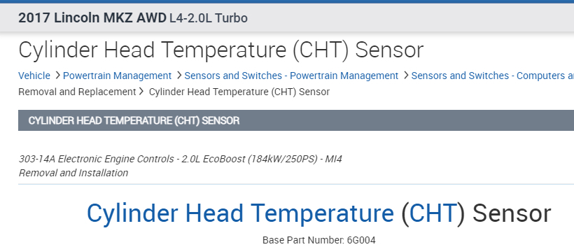

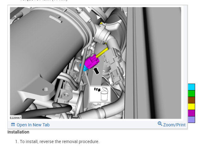

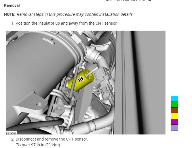

It sounds like the cylinder head temperature sensor (CHT) has shorted or failed internally. If it is jumping straight to overheating, we know that can't be accurate.
I attached directions below for replacing the CHT. You can try to simply replace it and check the wiring and connectors along the way, or you can scan the can-bus to see if there is a short causing the issue.
Here is a link that explains how to scan the can-bus:
Let me know your thoughts or if you have other questions.
