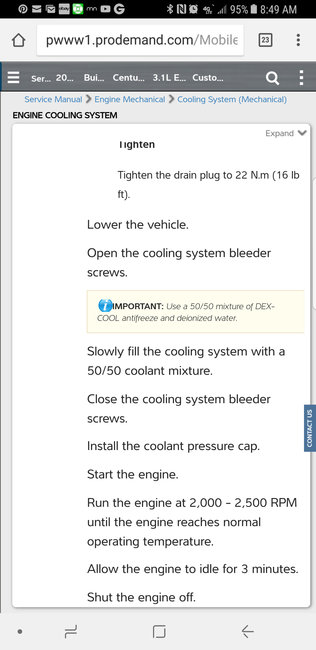

I think we have been bleeding it wrong. It has two bleeder screws. How do you bleed it correctly? Water pump was rusted when we replaced it.
Dec 12, 2017 at 12:01 AM
SATURNTECH9
  • 30,869 POSTS
Here is what I have about filling the cooling system after draining it:
Dec 12, 2017 at 12:50 AM

We are bleeding the coolant system and it seems like we are getting less air out of the bleeder and more coolant but we will see if this fixes it.
Dec 12, 2017 at 1:15 AM
SATURNTECH9
  • 30,869 POSTS
Keep us posted.
Dec 12, 2017 at 2:50 AM
CECE18192004
  • 28 POSTS
We were bleeding the cooling system wrong and putting air through the system still. It is fixed now after spending a bunch of money, but hey the whole cooling system is brand new now.
