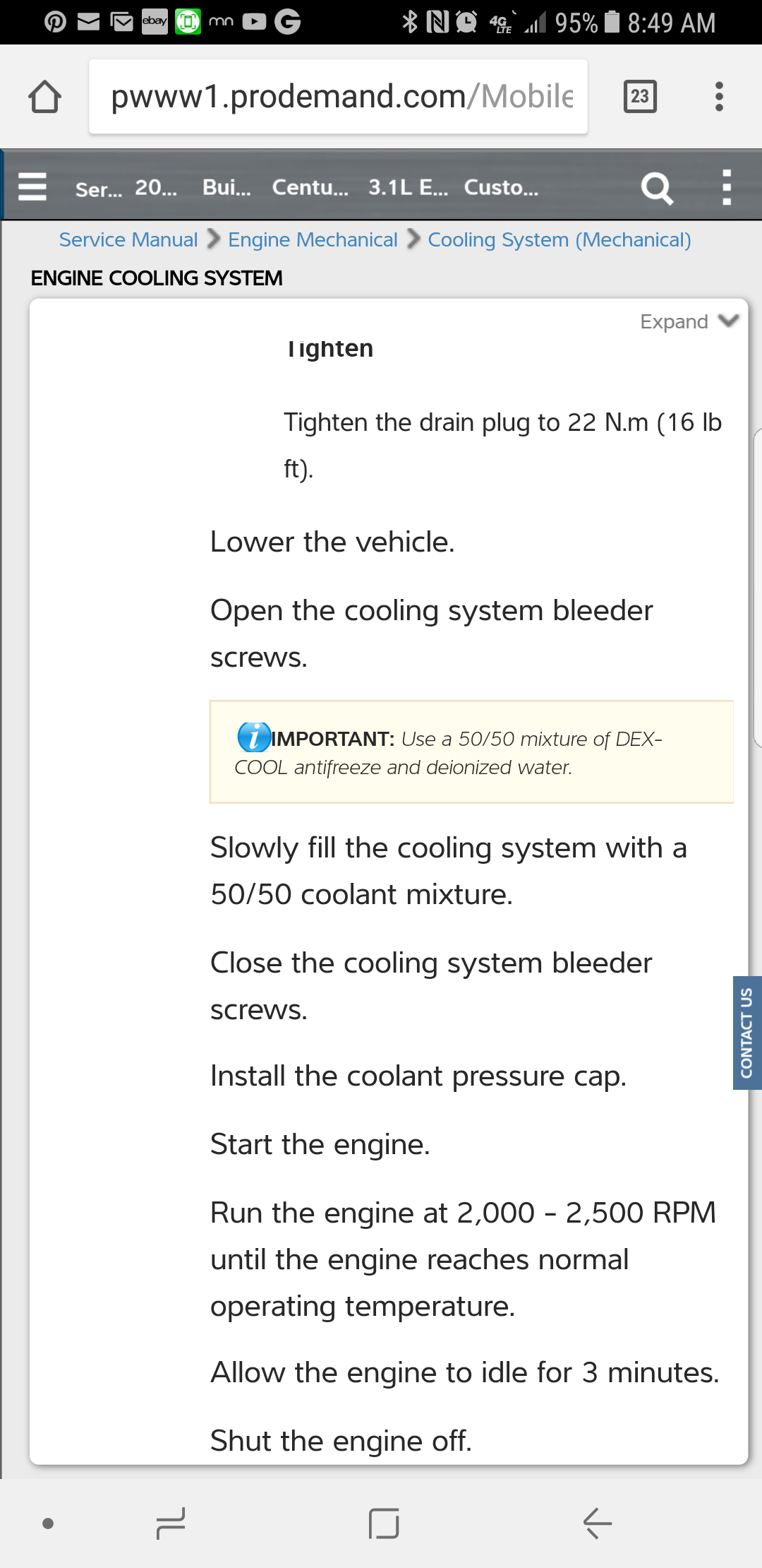

Here is a guide to help you with the heater

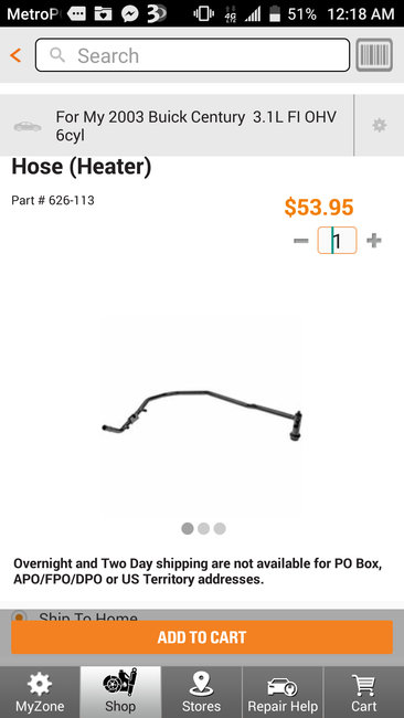

Well it's a metal hose that connects to the water pump that has one of the two coolant bleeders. The other end the heater core connects to it. Could that metal hose have a blockage?
Dec 12, 2017 at 1:17 PM
CECE18192004
  • 28 POSTS
This is the metal hose I am talking about?
Dec 12, 2017 at 1:21 PM
SATURNTECH9
  • 30,869 POSTS
It looks like a heater pipe with the bleeder screw highly unlikely it's clogged but if you want to check It you can.Are both the heater hoses getting too hot to hold at operating temp?
