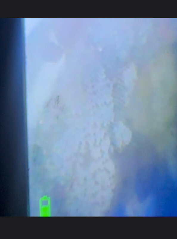

It is still overheating. I’ve done every test, and everything is coming back normal, but coolant is still coming out of the reservoir. Could it be a clogged cat? I stuck my borescope down the exhaust, and this is what I saw. It’s kind of hard to see but hopefully you can see enough to be able to tell.

That doesn't look very nice, almost looks like the substrate is damaged, that could cause it to heat up though. The white looks like it may have gotten very hot and fused the ceramic closed.

There was a hole in my exhaust manifold for a little bit, but I replaced it. I did use the exhaust weld stuff, but it wasn’t very long before I replaced it. Maybe some of that stuff fell in? So that's probably the reason I’m overheating still? That sucks I was hoping it was something way less expensive.

Plugged cat would hold heat in the head and cause it to heat up. You could cheat a bit for testing. Get a chunk of straight pipe and cut it just long enough to bridge the cat opening. Remove the cat and stick the pipe in place. That will quiet it down so you can run it in the driveway without the neighbors showing up all angry. If it stays cold, you have the answer. If you are not in a CARB state like NY or CA, you might be able to get one through Rock Auto for much less. The Walker 52507 is about $250.00 for the federal version.
