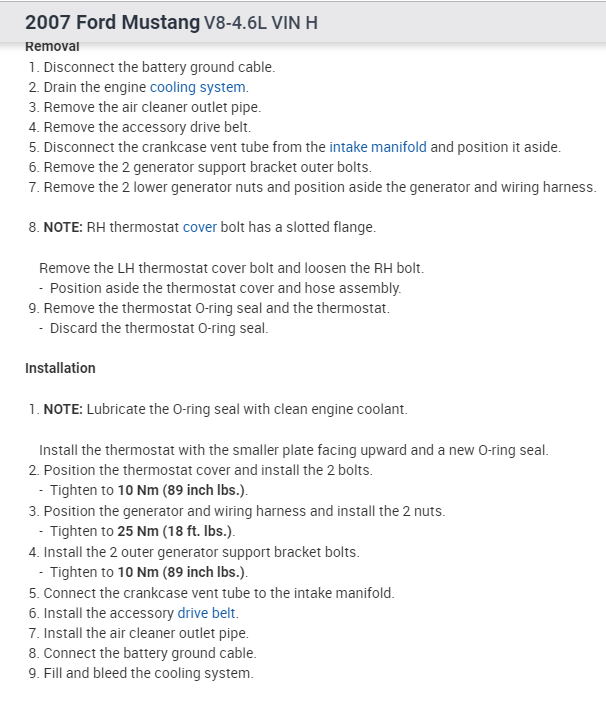

Hello, I'm new to truly working on my own car. my dream car I worked my behind off for, 2007 Mustang GT. She's started overheating. i bought a voltmeter with the light handle. The fuse is fine. I'm not exactly sure if I correctly checked the wires from the fan to the fuse box. But what steps should I take to fix this? How do I know if it's the fan or the relays or whatever it could be with the radiator system?

just a few questions first.Have you noticed if the electric fans have came on? Also, Do you know if the thermostat has ever been replaced? Here are a few tutorials for you to see:

Crazy storms today, so tomorrow I'll be able to run the car and drive a bit then check to see if the fans come on. I haven't been able to check them after reaching a higher temp to see if vans are on or off. Also, I'm sure the thermostat hasn't been changed yet. Planning on changing it just because it needs to be in the next few days to a week or so, and if that fixes it I'll be a happy camper! Will keep you posted. Thanks boss.

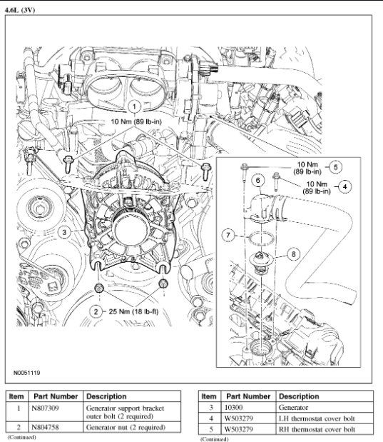

Here is a tutorial showing what's involved changing a thermostat:
I've also attached instructions and picture below.hope you're okay weather wise as I'm in CA and been dealing with a lot of rain for months.Thanks again for using 2CarPros and let me know if you have any questions.Keep me updated.
