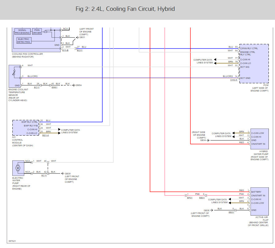

This car is a Hybrid. Overheating and believe it to be due to a faulty motor block type heater on the bottom side of the radiator that is specific to a Hybrid engine for the Sonata. How much do they cost and how hard is it to replace myself?

I am having a hard time understanding what you are talking about. Here is the wiring diagrams for you car for the cooling fan can you look at it to see which part you are talking about.
Check out the diagrams (below). Please let us know what you find.
