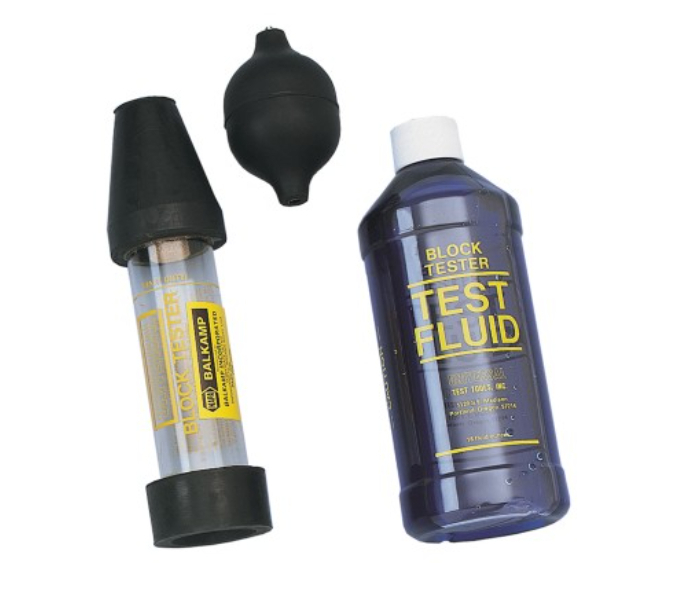

You can also try a chemical head gasket test at the radiator, I know you had the head gaskets done, but if there is a crack somewhere even in the engine block that the mechanic didn't notice it will be the same effect as a bad head gasket. The chemical test is cheap, and it will tell you if there are any combustion gases getting into the cooling system. I will post a picture of the chemical test to give you an idea of what it looks like. It's also called a Block Test.

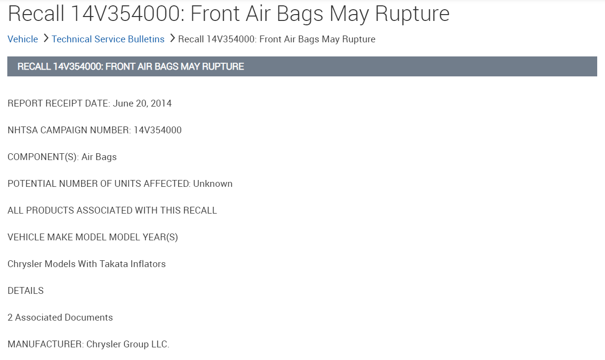

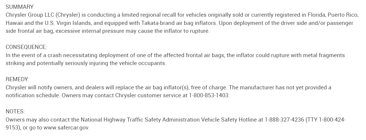

There was a Recall as well on one of the Air Bags too, just for your information, it is an old one (2014), so it may have been done already.

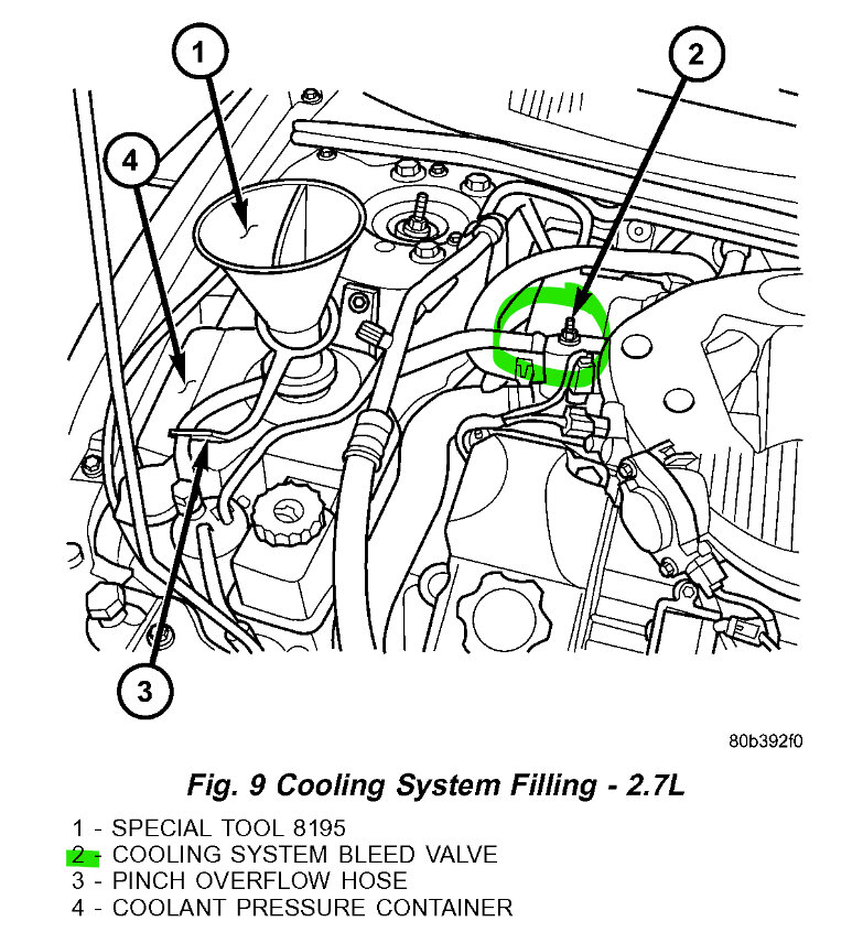

In the morning when the vehicle is cooled off, have you verified it's not low on coolant? There is a bleed screw, although since you've been having issues even before the work was done, I don't think that's the issue.

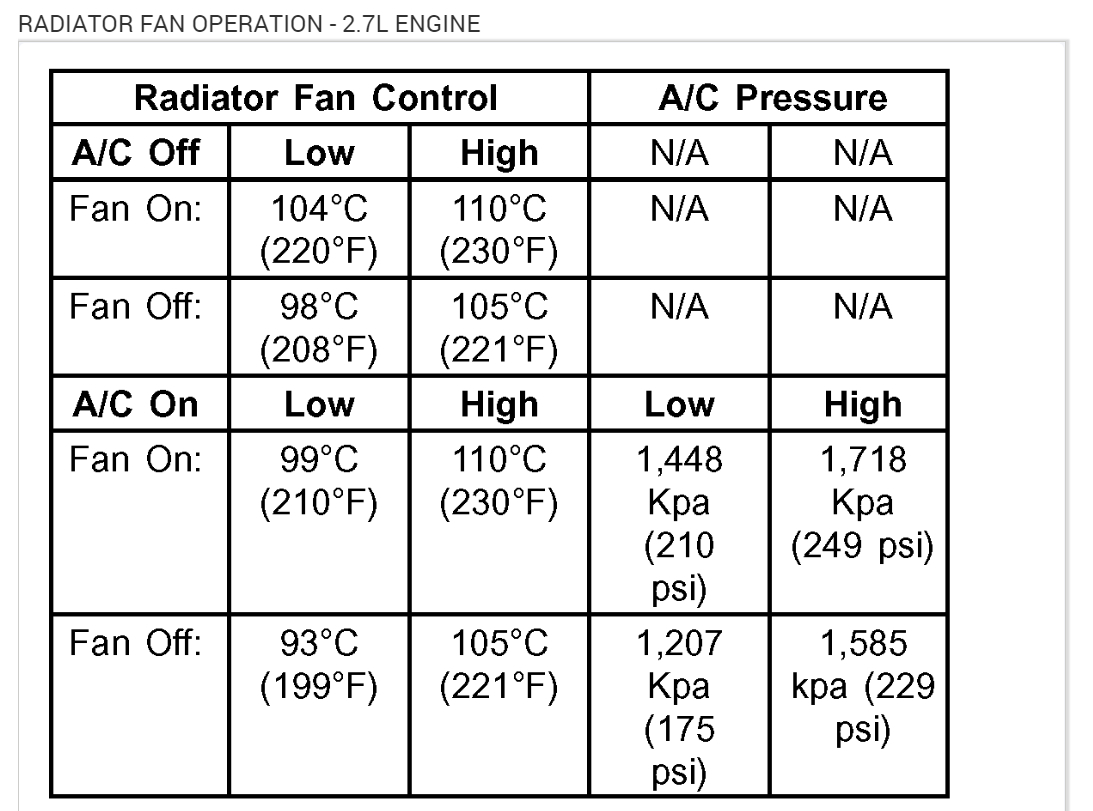

And if it's just at idle are the cooling fans coming on? Since the coolant temperature sensor melted, I would check the wiring harness in that area as well. Something is not right if it's still overheating. Either the fans are not coming on while it's sitting idle, or something else is happening. There are only so many things it can be. I'm assuming the Temperature gauge is going hot and/or the light is coming on. Make sure the wiring harness is not melted anywhere, causing the coolant sensor to possibly short out. If you have the means of verifying the actual temperature around where the coolant temperature sensor is, as well as the thermostat area to see if it's actually overheating or if the temperature sensor is giving a false reading. Both fans would be on high if the sensor is giving a false reading because that is the only means for the engine computer to determine coolant temperature. Check it with the A/C off.

Yes, the heads were taken in and resurfaced, no cracks found. It is overheating at idle, and the heater is not very warm whereas before this it would get blazing hot. The low-speed fans come on about halfway to the temperature mark and then the high-speed fans kick in, but the temperature continues to rise. I'll definitely check for gases, and I have a temperature gun I can use to check for faulty temperature readings.

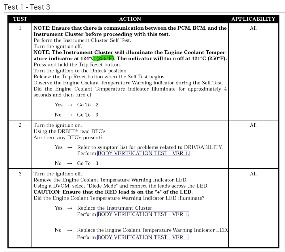

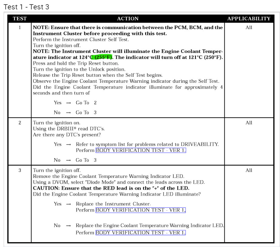

There is some Self-Test on the Instrument Cluster info, states that the light won't come on until 255 degrees, at that temperature, the air coming out the vents would be extremely hot.
