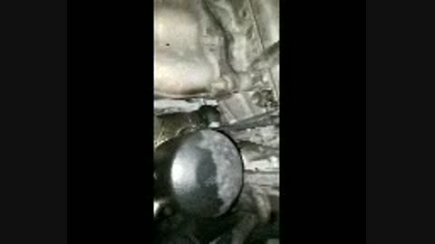

Yesterday I found that my coolant was gone, filled it up but car started overheating right away and shaking when I pressed the gas. Got it towed to my house and the next morning filled up the coolant again, took it for a five minute drive, there was little bit of smoke under the hood but temperature gauge was still in the middle of hot and cold, in the five minutes I drove it. It had also swallowed up about a quarter of the coolant, looked under the car and there was no leak under the coolant tank, but spewing on the passenger side (left side) of the under the hood. I wasn’t able to get a good visual, whatever is causing the leak was below the engine or to low down for me to get a good look. Left the car running idle, very little to no smoke in the ten minutes it was running on my driveway, it actually only really smoked up after I turned the car off. but coolant spewed out like crazy. Heater didn’t really warm up either. Checked the color of my oil to make sure coolant hadn’t mixed in and it was fine. My oil is still dark brown and regular, any ideas as to what part of my cooling system could be causing this? I’m thinking maybe a hose? The first night it overheated I suspected it was a stuck closed thermostat because coolant wouldn’t leak but the car overheated, the situation completely changed the next morning, suddenly a leak! Also noted that when the car was off i didn’t see any coolant spewing out. I know Subaru’s are infamous for head gasket failures, but it really could be any part of the system, please help!

Here’s a closer look under the car where it seems to be leaking (passenger side):
Nov 11, 2019 at 4:04 AM
SCGRANTURISMO
  • 4,897 POSTS
Okay, so it looks like it is leaking from the hose by the oil filter. You are going to have to drain the coolant from the cooling system, usually there is a petcock on the bottom of the radiator that you can unscrew to drain the coolant, if not, then loosen the lower radiator hose and with a bucket underneath, drain the coolant that way. Remove the suspect hose and inspect it. It would be a good idea just to replace the hose with a new one and new hose clamps, I recommend good quality worm gear hose clamps. Screw petcock back into the radiator, or re-install the lower radiator hose. Refill the cooling system with the coolant and check for leaks. Please get back to us with how everything turns out.

So I found a hose to replace it with, it seemed to work but now have another problem on my hands. The car has been running fine for two days since I replaced the hose but now when I press the gas pedal, I sometimes hear a rattling noise from the drivers side in front of the car. No coolant leaking, oil level is fine. There’s a smell in my car as well, i can’t really describe it. It’s accelerating just fine but there is a noise. Could this be a problem with my exhaust system?
