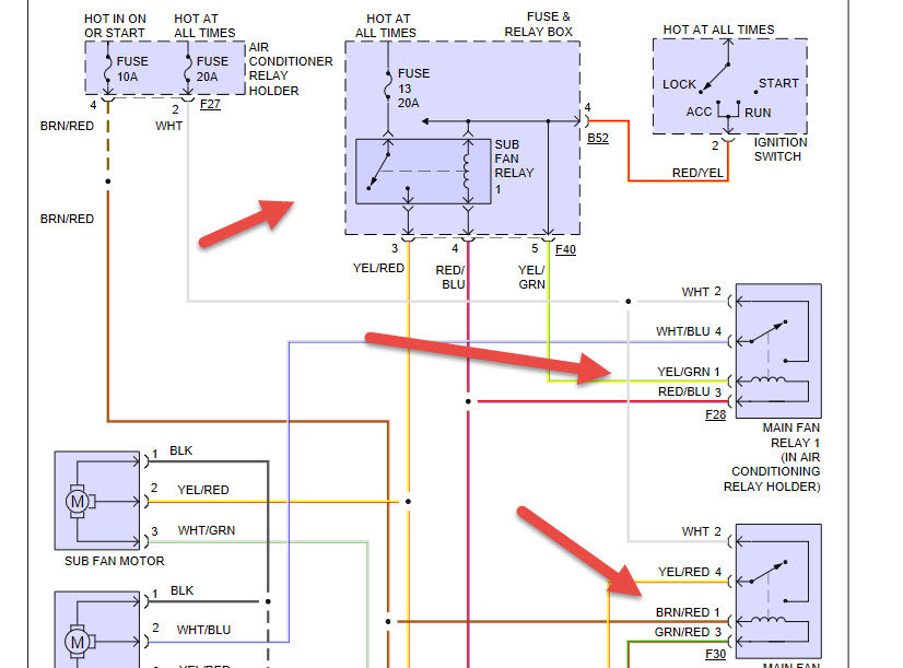

That car looks like thePCM tells the fans to come on via the coolant sensor. You may have a coolant sensor out of range. Otherwise you need to get a test light and see if the PCM is triggering the relay at the Green/red wire at the sub fan relay and the Red/blue wire at the main fan relay. Also check fuses 17,18 and the 2 fuses in the A/C relay holder

I just replaced my radiator with new thermostat and coolant. When the engine warms up,the cooling fan kick in but never shut off and do not know if this was existed before the repair and did not noticed it or just started after.So this is the basic trouble shooting I have done:
I turned off the engine and turn the ignition on only and the fan start to run and shuts off after i minute but it does not shut off while the engine is running.
Has anyone running into similar problem? I do not know if this is cooling sensor issue,relay or some thing else.

Check the thermostat if its the correct temperature for the engine.
Try the coolant temperature sensor could be out of range and telling the computer that the engine is gettig hotter than usual and computer constantly energizing the relay.

I have a problem with my radiator fan always running when ever the car has power. both fans come on and one goes from high to low. the temp guage goes to about 1/4 even when the car is cold.
I have tried to disconnect the temp sensor to see if that was bad but it would stay on. I bought a new ECU but that didn't work either.

check the a/c radiator fan relays . should be 3 (main fan relay #1 & #2 as well as Sub Fan Relay #2) . all located in the a/c relay holder, on left side of engine compartment.

Overheats constantly. I had it tested and was told it was the cooling fan relay. I cannot find it. where can I find a diagram that will show me where it is located?

there are four relays for the fans, one is called sub relay and the other three are in A/C holder. See picture.
