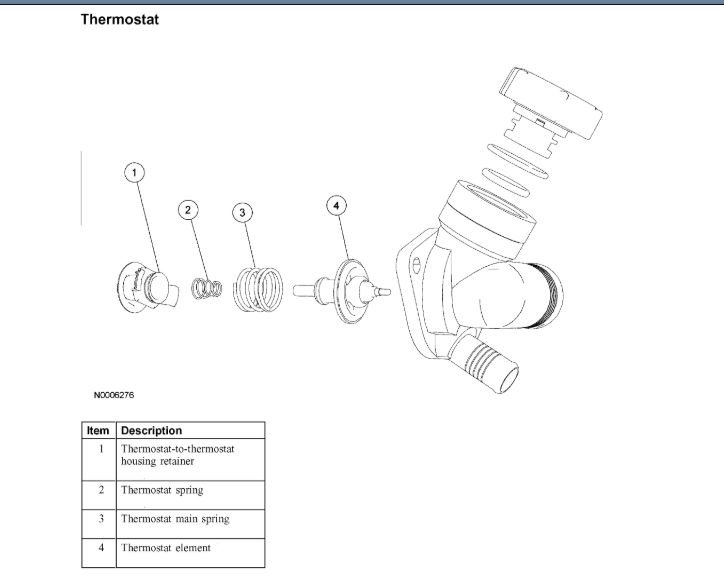

My temperature gauge goes up after I drive maybe a block or to and I pull over it drops midway. It constantly does this goes up and then drops after I pull over for 5 minutes. There is no smoke under the hood or the back tailgate.

This could be a thermostat that is bad or a clogged radiator that is not allowing circulation.
https://www.2carpros.com/articles/coolant-flush-and-refill-all-cars
Check your fluid level to be sure it is not low.
https://www.2carpros.com/articles/engine-overheating-or-running-hot

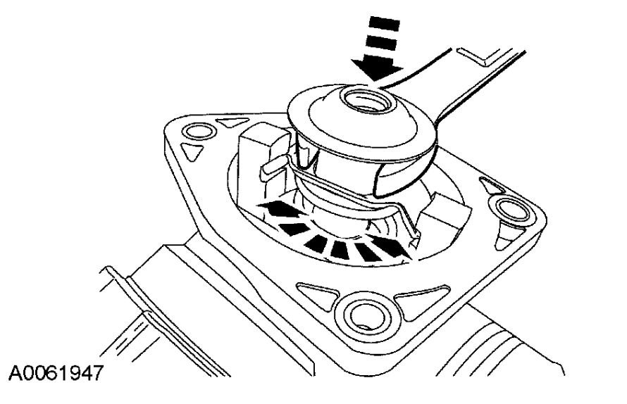

2. Remove the thermostat housing.
3. NOTE: Thermostat can be rotated in either direction to release it from the thermostat housing.
Using a 18 mm (0.7 inch) open end wrench, simultaneously push down and turn the thermostat retainer to release it from the housing.
4. Remove the thermostat spring, thermostat main spring and the thermostat element.

NOTE: The thermostat can be rotated in either direction to install it in the thermostat housing.
Using an 18 mm (0.7 inch) open end wrench, simultaneously push down and turn the thermostat retainer to install the thermostat in the housing.
