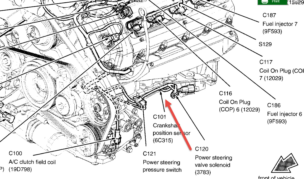

Car starts right up in in mornings. But if it sets for a couple of hours after it gets warmed up, it will crank over several times before starting.

check fuel pressure with a gauge auto parts rent it.

Fuel pressure is 45psi.

pressure is ok test to see if it holds preossure for at least 5 minutes if not it may be a bad regulator otherwise scan for codes and check crank sensor.

Fuel pressure drops from 45 to 30 psi in five minutes. Where is crankshaft positioning sensor located?

I also scaned for code and there wasn't any.

see pic for crank sensor these can go bad and not send a code.

I replaced the crankshaft sensor. But I still have the same problem.

fuel pressure shouldn't drop 15 ppsi in five minutes should be 10 or less check your regulator

Is that with the engine running

no at shutdown if you rev engine fuel pressure going up will be normal but not by a lot.
