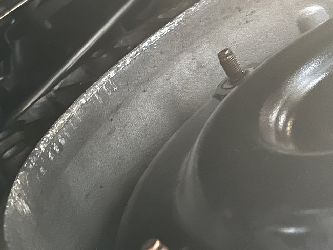

Apparently, I have to rebuild my engine again. The drive plate has worn down teeth and the bell housing have marks from it. I was told that means my crank and thrust bearing need to be replaced and that also is what caused my rear main seal to leak. I paid the machine shop that ended up screwing up my heads to grind my crank because they assured me, I could still use it because nothing was wrong with it. It all makes sense now because I had to replace the drive plate during the rebuild because it had a slight indent which I'm told was a contributing factor to my transmission needing to be rebuilt in the first place. So, I don’t really know what to do. I can’t afford to rebuild my engine again or to put a rebuilt one in. I just don’t know what I’m going to do at the moment.

If they cut the crank, did you use oversized bearings to match their cut? Also, how much in and out play is there at the crankshaft pulley?

Is cutting the same as grinding? Because they never said anything about cutting. All they said was $90.00 to grind the crank so I said okay, if it needs it then do it and then they told me I could use standard size bearings and everything which is why they didn’t bore the block and only honed it.

Grinding is the same. If they removed any of the surfaces, the original size would have allowed more clearance. Most times, the cranks are ground to.010, .020, .030, and even 0.40. If the crank was ground, I would have thought at a minimum a.010 oversized bearing would have been required.
If in fact the crank needed ground, I would have expected them to grind a specific amount to, you would know what size bearing was needed. If they took nothing, it didn't need ground.

So, they either lied and stole my money by not grinding it but telling me they did, or they set me up for failure from the beginning by grinding it and getting standard bearings? And actually, they got them for me. I just paid for them and then installed them after they gave me the block back.

I couldn't agree more. Also, I was correct. Crankshaft grinding always requires an oversized bearing. I've heard of having the crank polished which would allow the OEM size bearing, but not grinding.

Okay, wait. That sounds familiar so maybe that’s what they did. Whatever it was, it cost $90.00. I’ll have to take my skateboard over there tomorrow and ask them because they didn’t answer when I texted them today. Twice. Lol. Although, I do have a couple of theories. I had trouble with the woodruff key on my harmonic balancer. Looking at the pulley now, it looks banged up and it shouldn’t be because I only drove my car for a few days. My theory is that it’s my harmonic balancer behind all of it. I think it being damaged is causing the crank wobbling which made the flywheel hit the bellhousing. It probably also caused my oil leak. A leak which I thought was coming from my rear main only to find out that it’s actually coming from the back side of my upper oil pan. I found that out when I dropped my transmission the other day. My other theory is that either the crankcase, the oil pump drive that gave me so much trouble plus a valley full of oil, my leaking valve cover(all fixed except for the upper oil pan), or a combination of all 3, caused oil to leak onto the harmonic balancer which softened the rubber and caused it to chip off which made the crank wobble and made the flywheel imprint itself onto the inside of the bellhousing. If that's the case, then changing the balancer should fix the problem. That would spare me from having to figure out how to pay for parts for another rebuild. Are either of those theories plausible?
