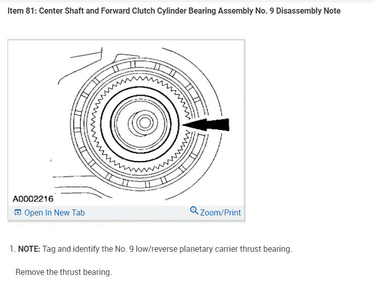

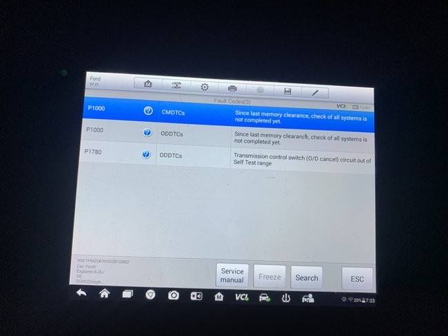

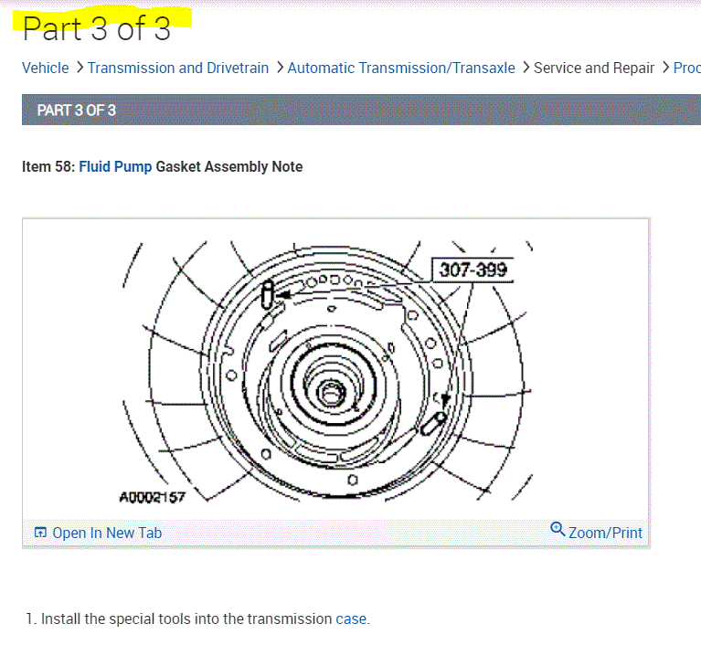

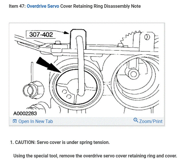

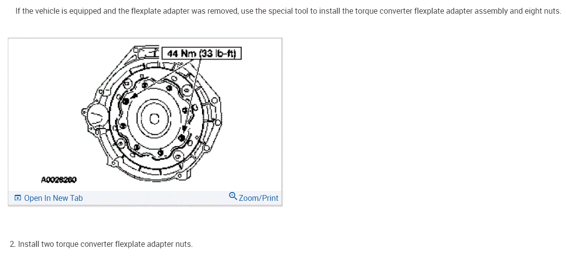

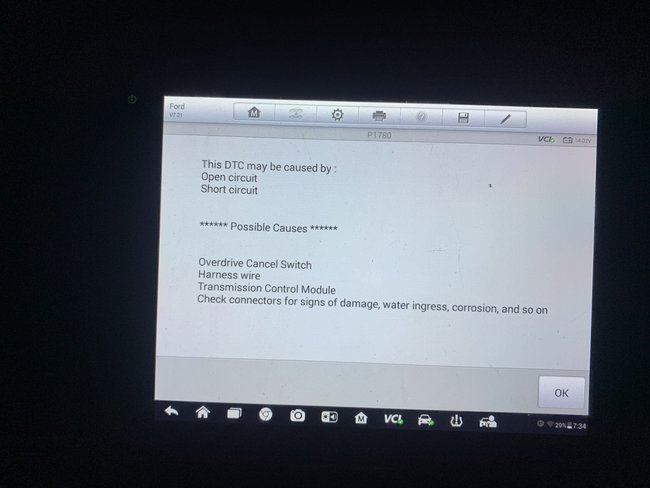

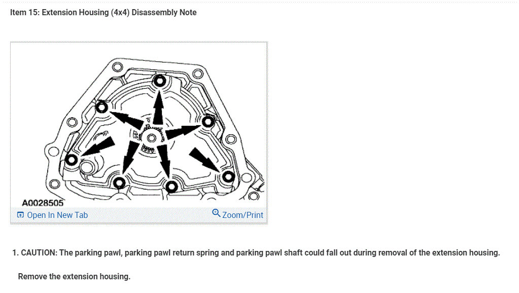

The overdrive button broke. Scanner says it’s not working and transmission keeps reverting to neutral.
May 1, 2022 at 12:24 PM
  • 110,251 POSTS
Ariana,

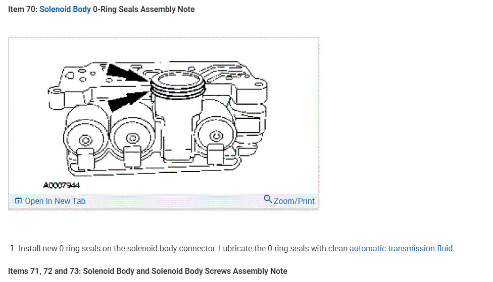

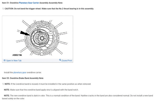

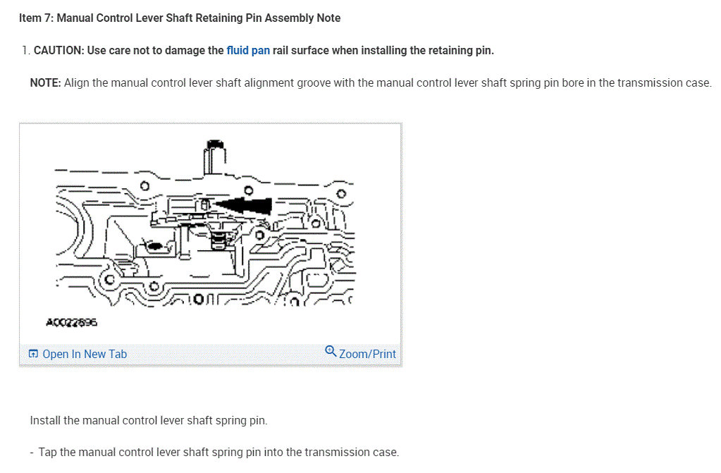

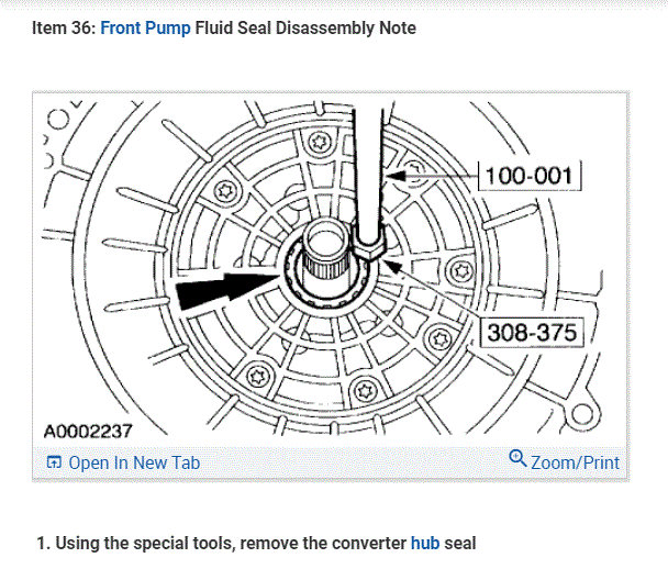

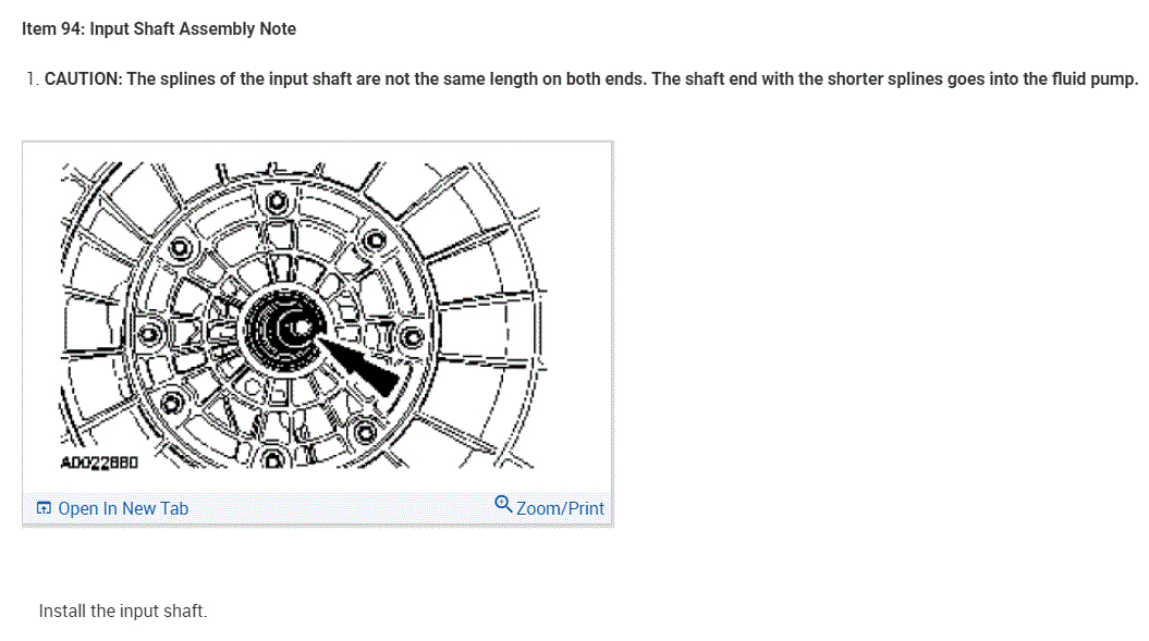

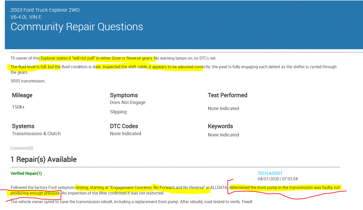

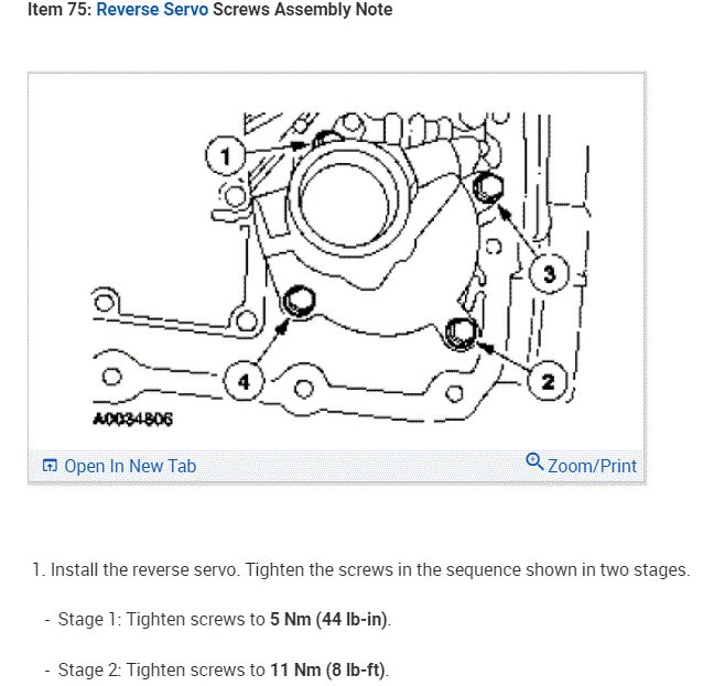

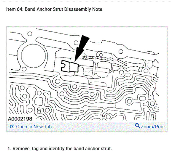

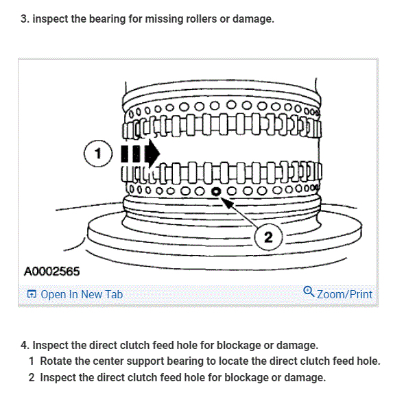

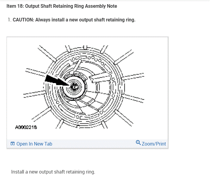

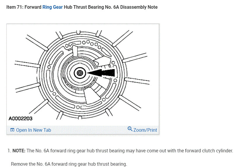

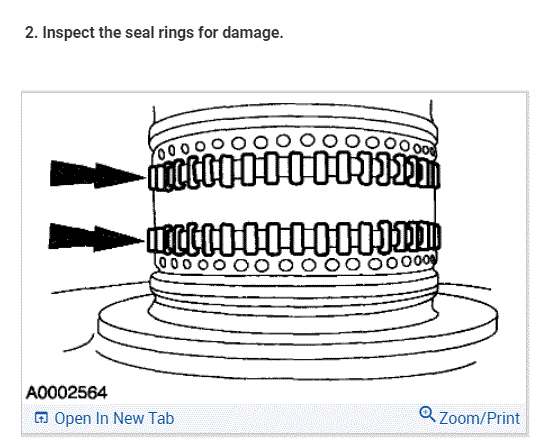

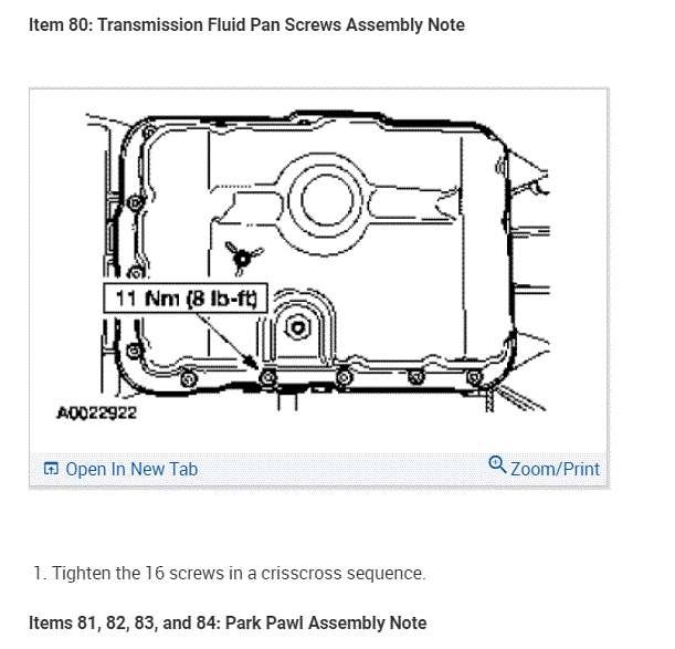

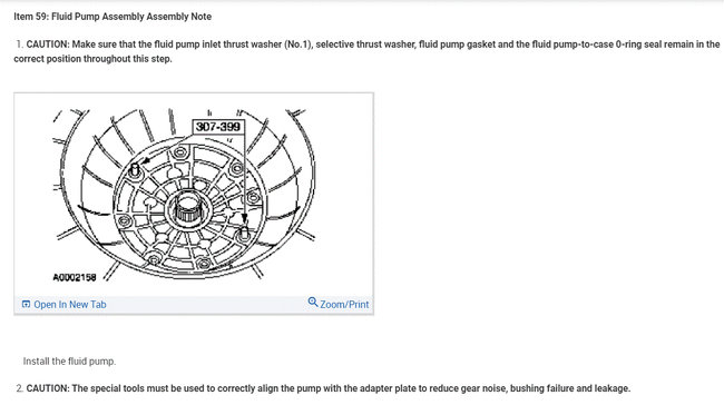

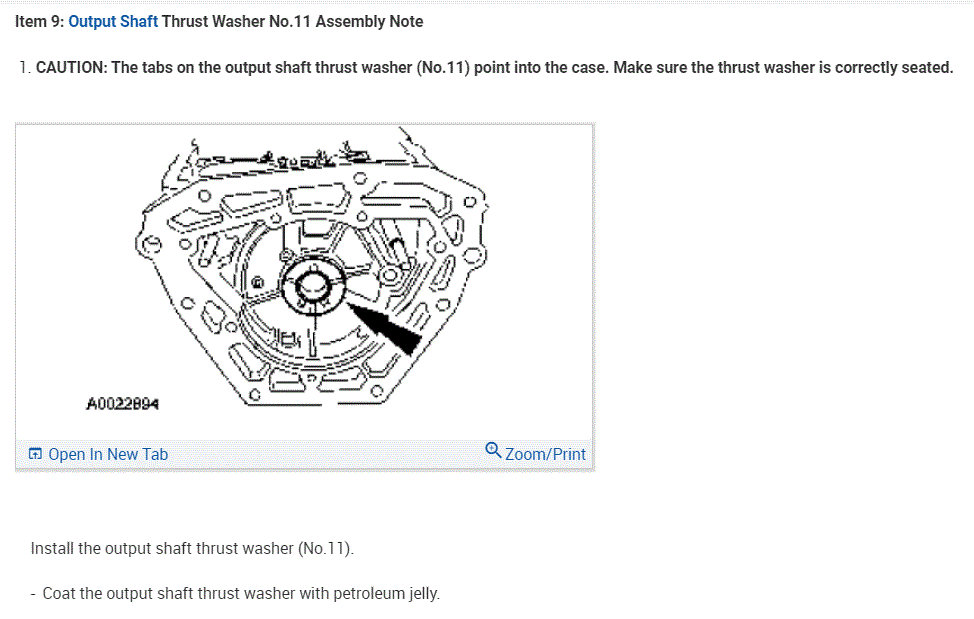

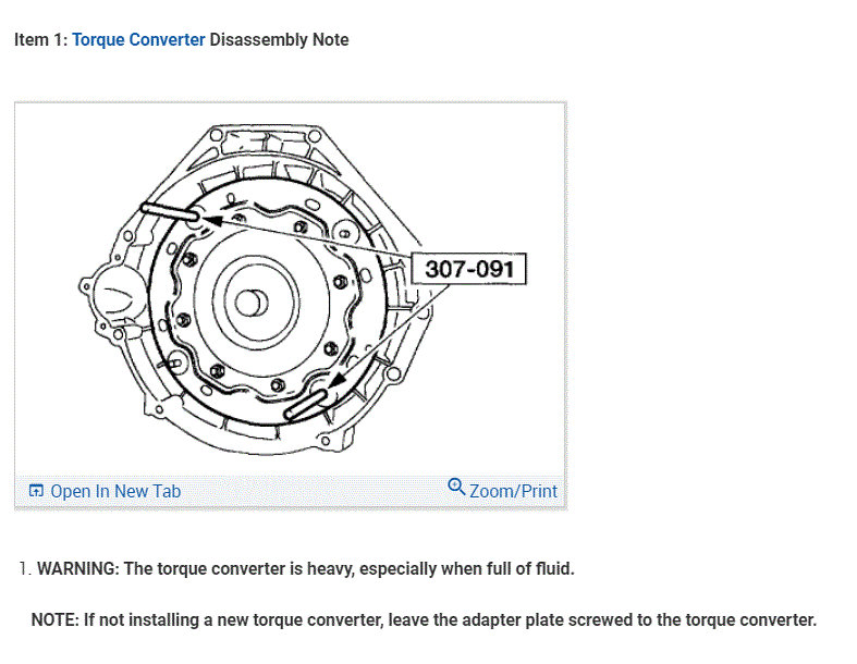

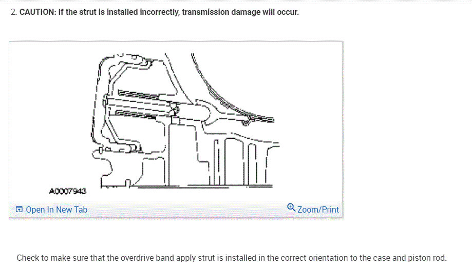

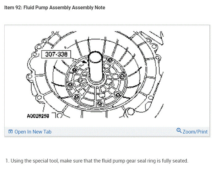

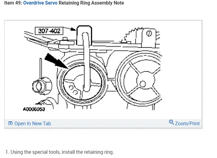

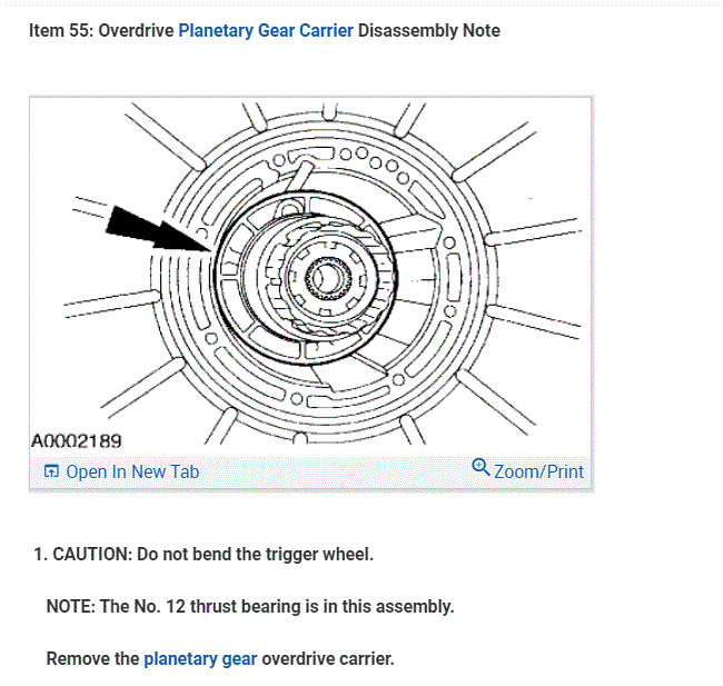

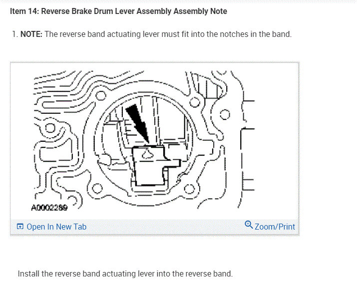

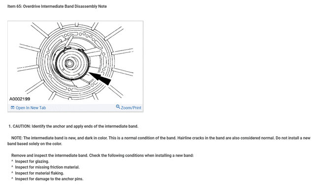

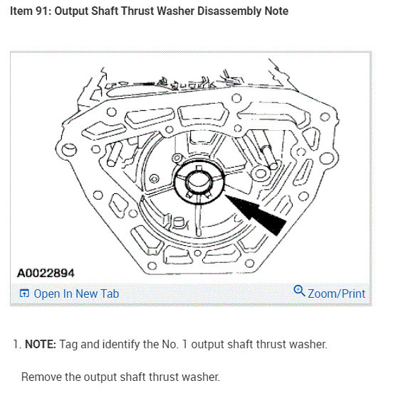

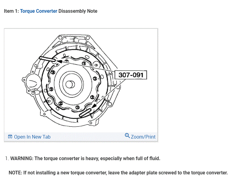

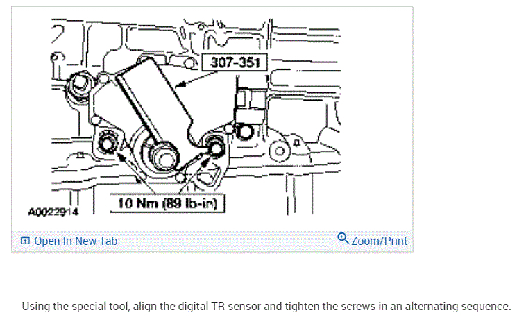

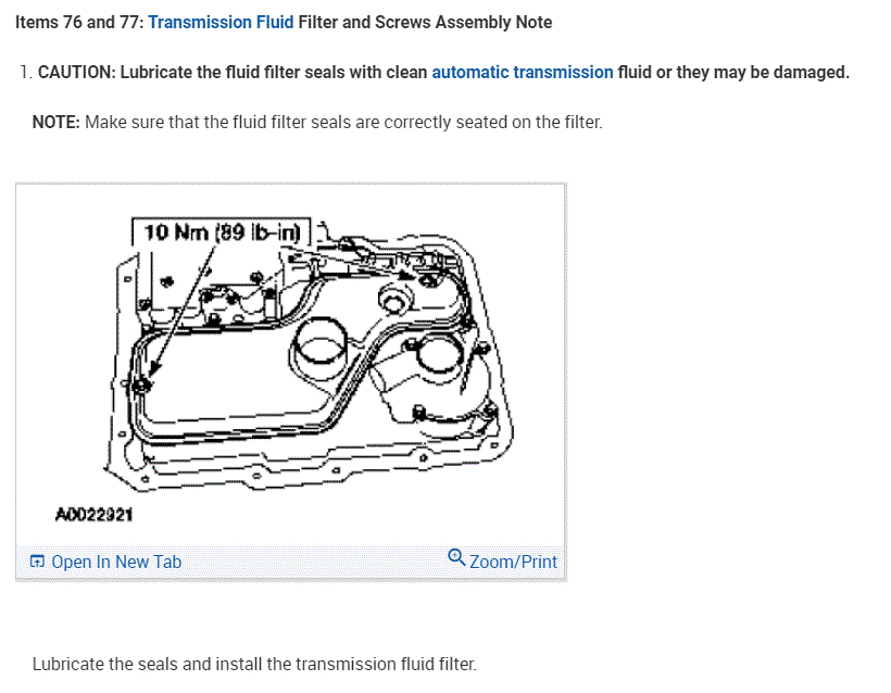

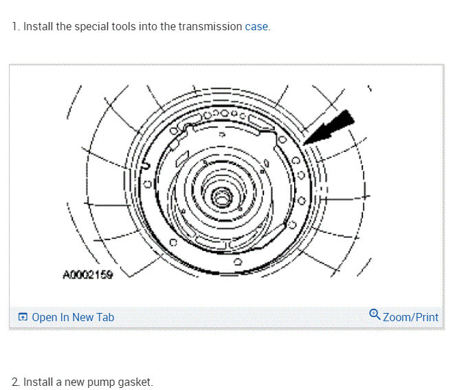

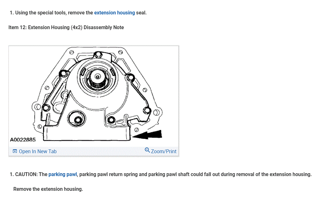

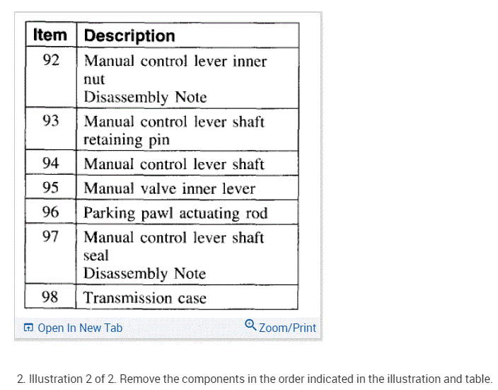

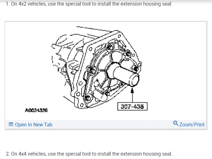

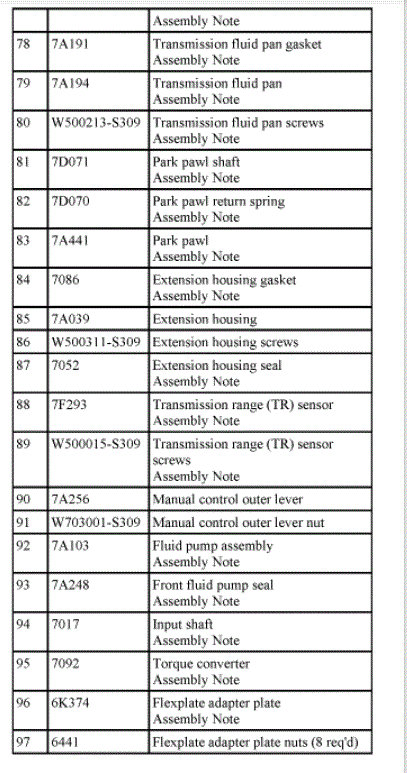

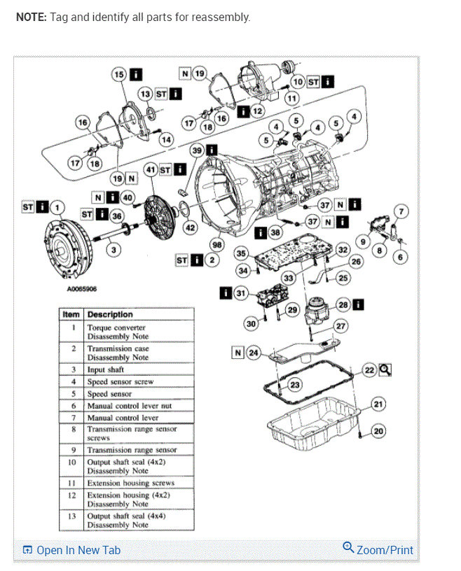

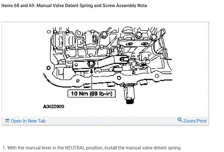

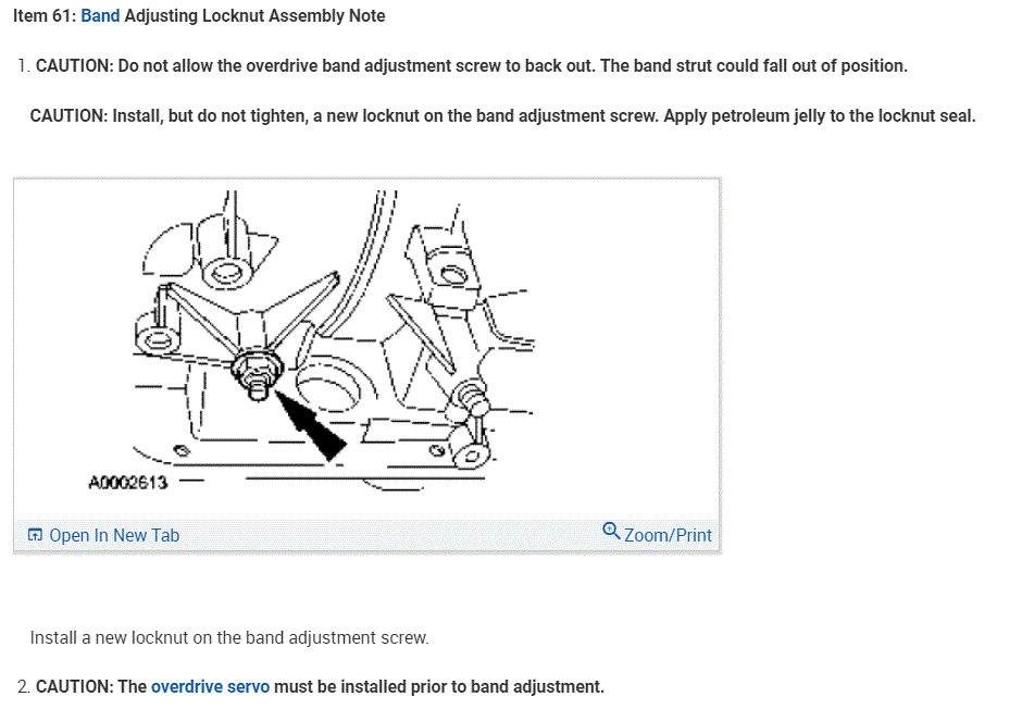

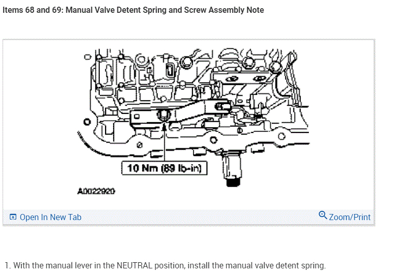

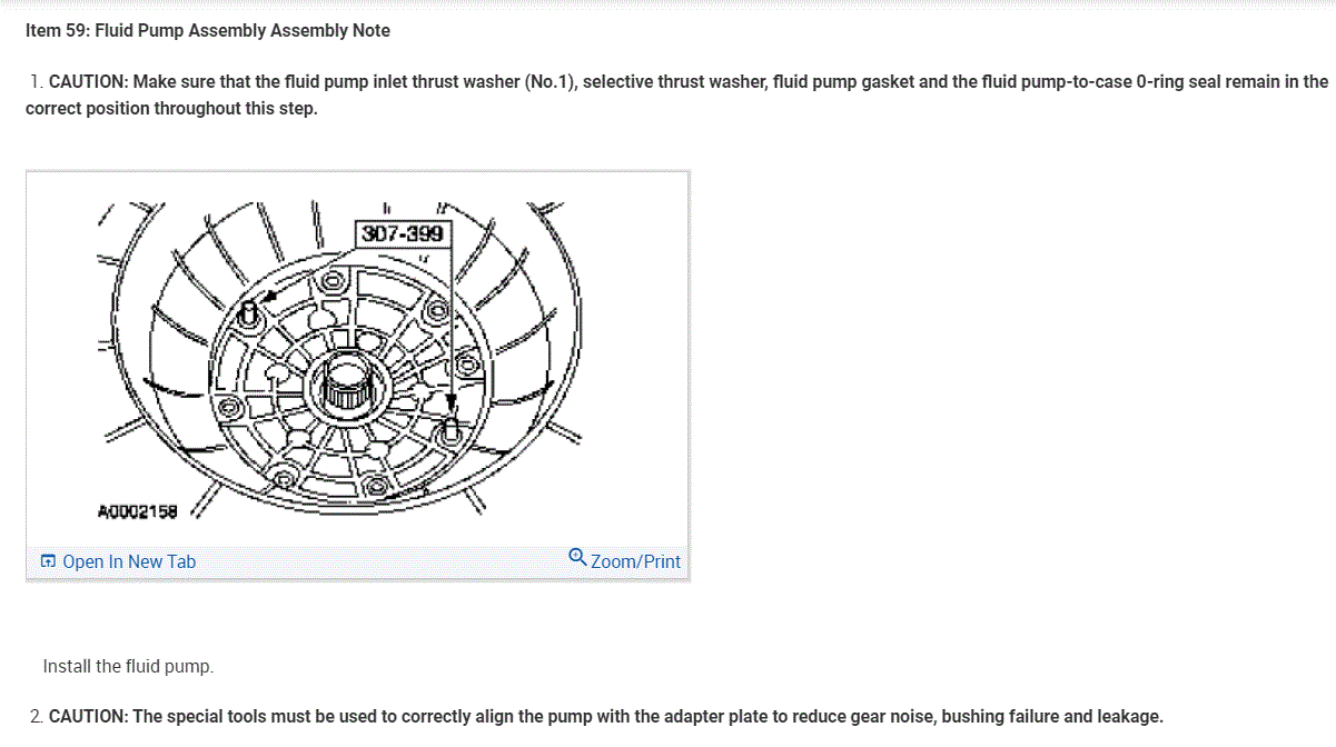

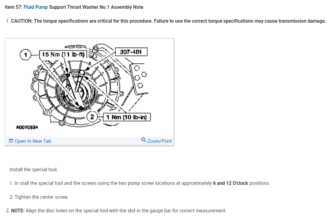

Welcome back. As far as the OD, if I recall, wasn't the torque converter rebuilt? Also, did you get codes specific to the switch or OD?

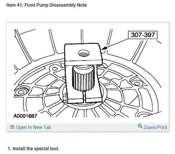

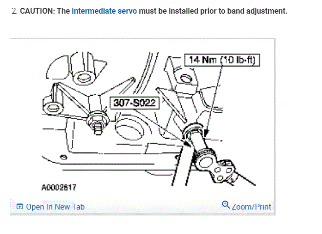

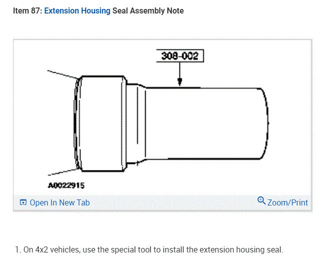

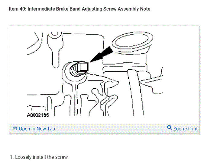

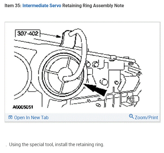

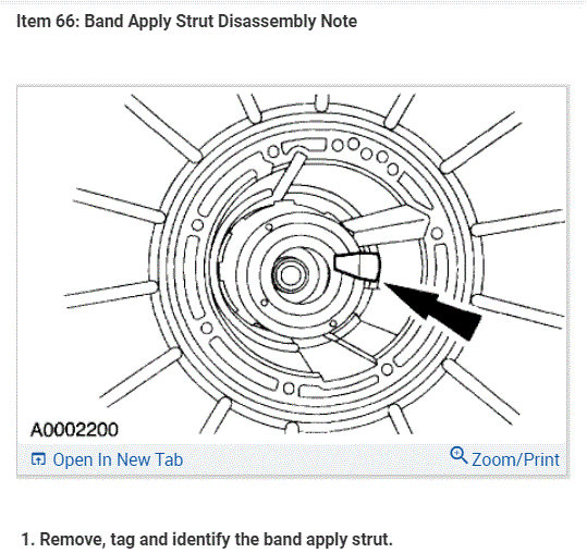

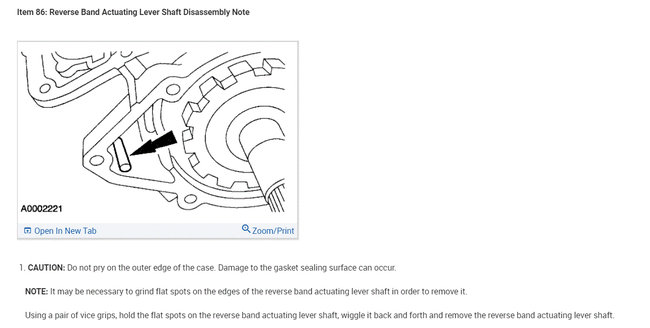

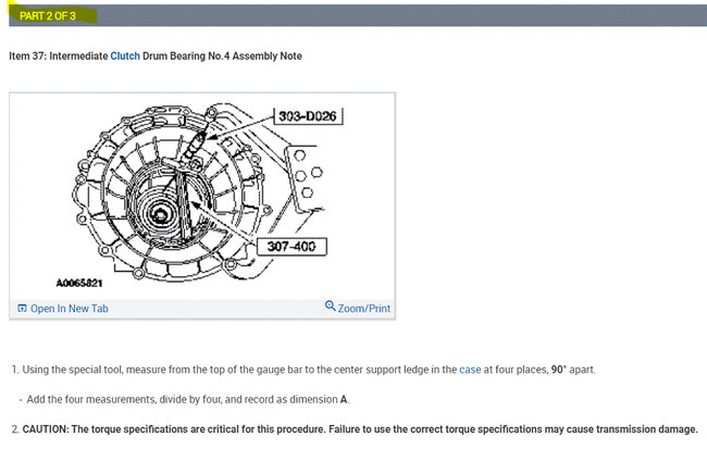

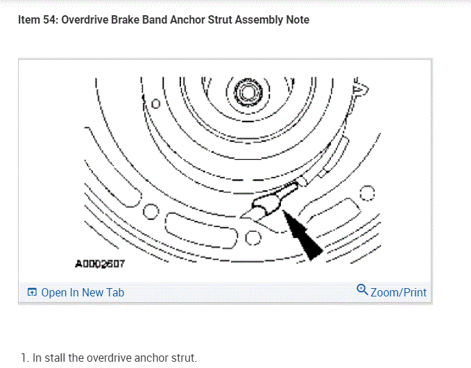

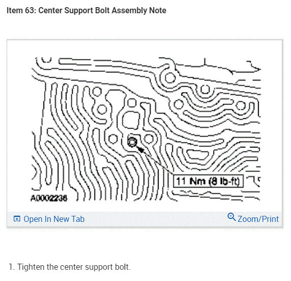

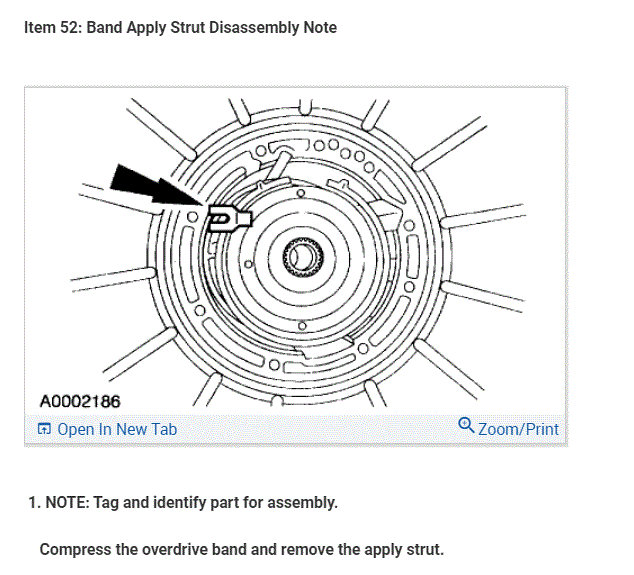

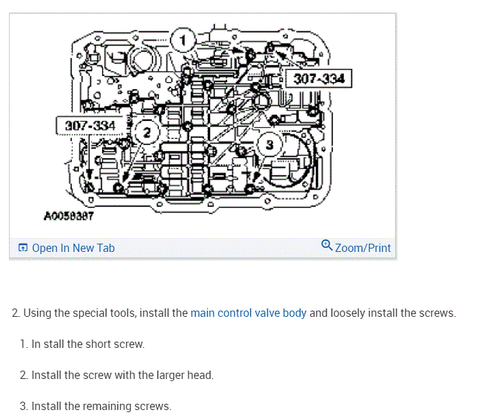

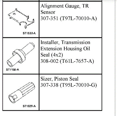

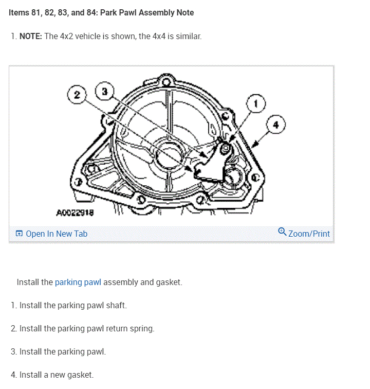

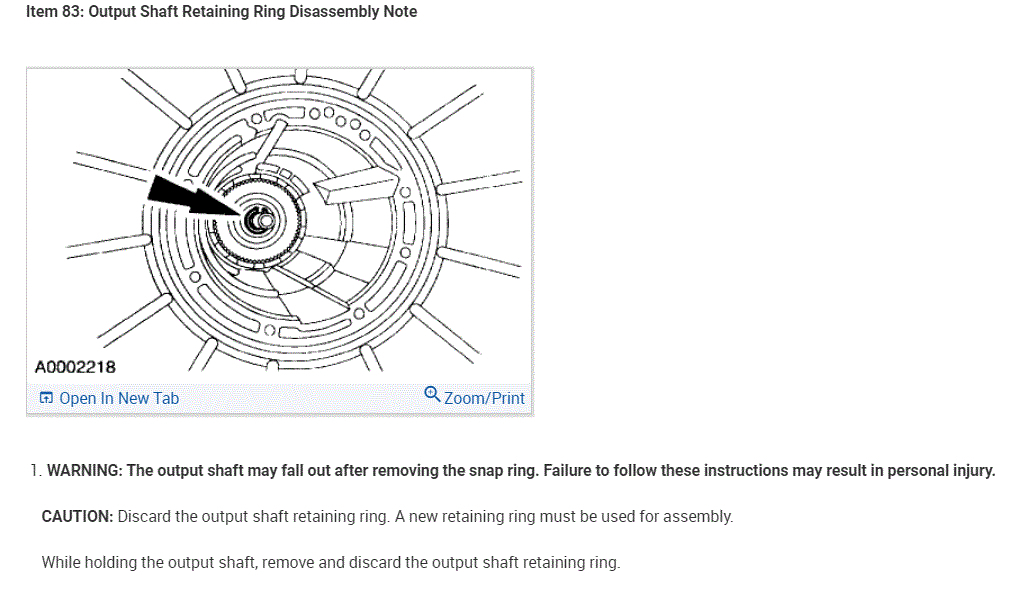

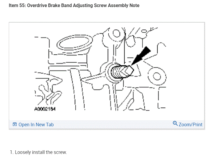

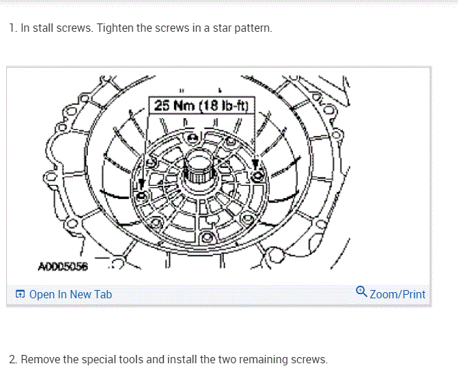

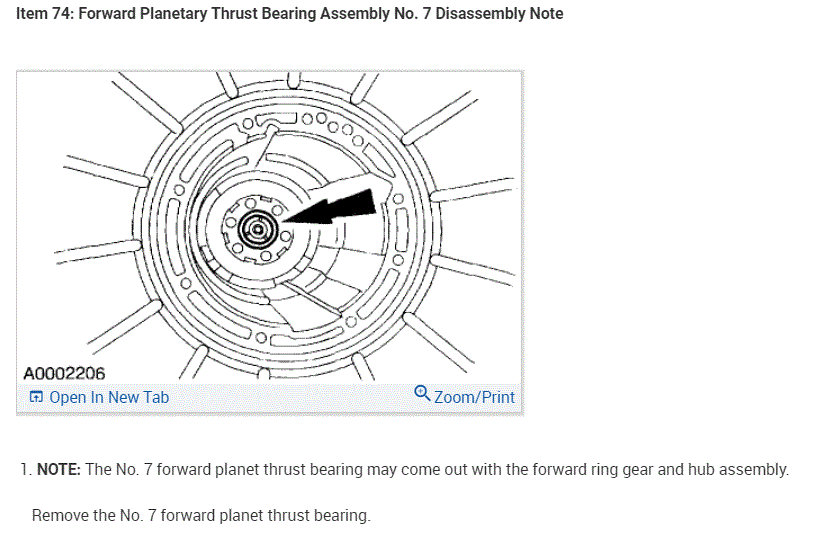

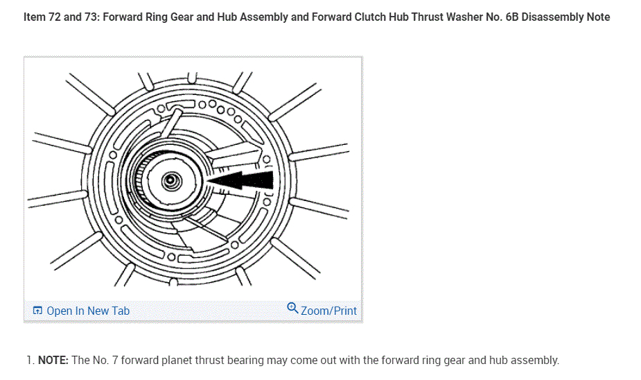

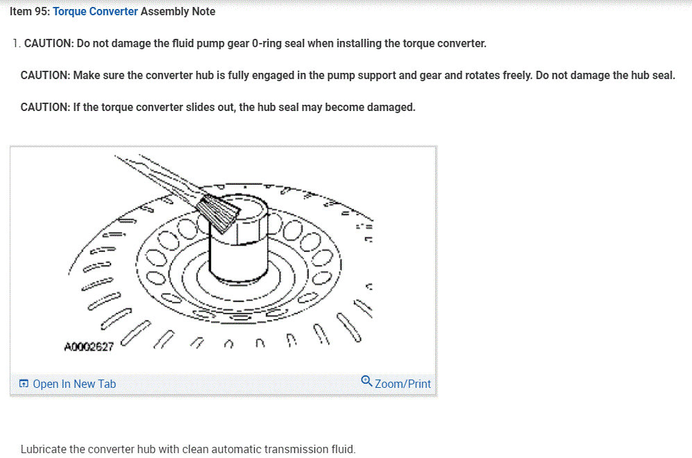

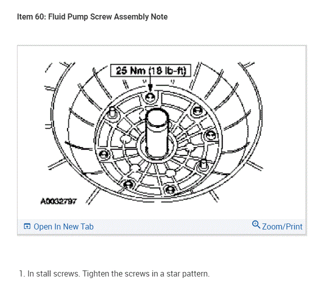

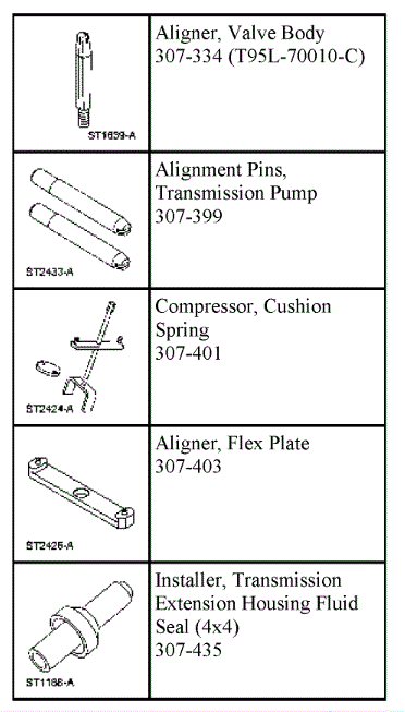

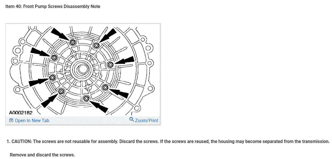

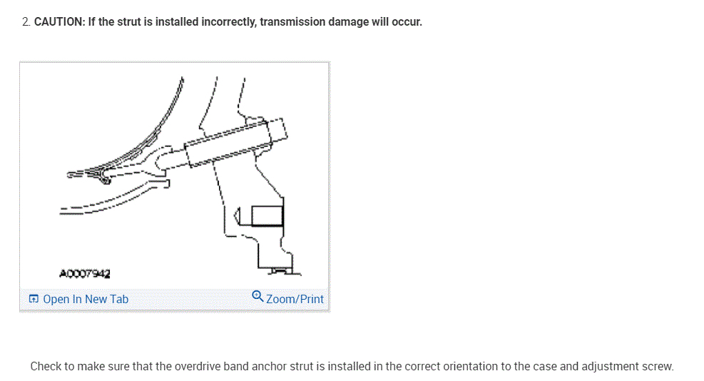

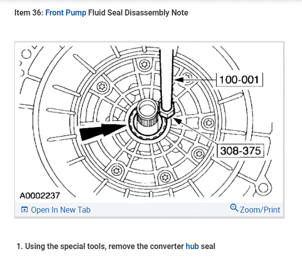

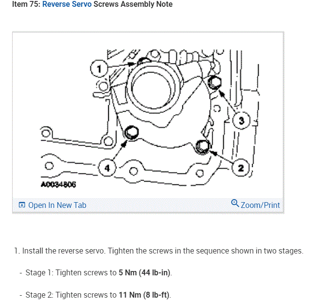

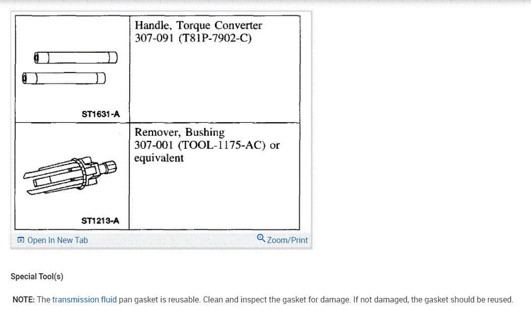

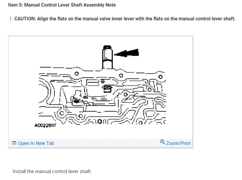

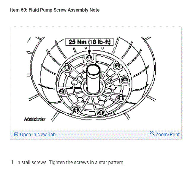

Also, please read through pic 1 below. I think you may find it of interest. Additionally, pic 2 shows the pressure regulating solenoids' location in the transmission. Since we know the fluid is clean and full and the filter is new, there shouldn't be any restrictions.
Let me know your thoughts.

Aamco told me the other day that my entire transmission was rebuilt with a new torque converter installed. And yes, the code was p1780, I’ll attach a pic.
May 1, 2022 at 10:57 PM

Hi Ariana,

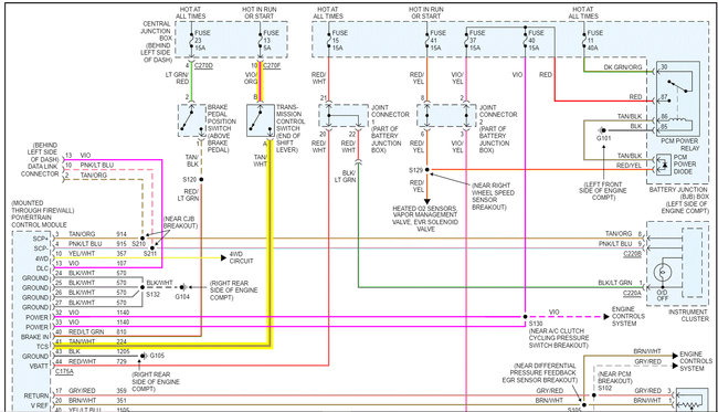

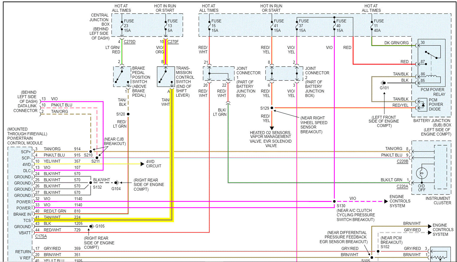

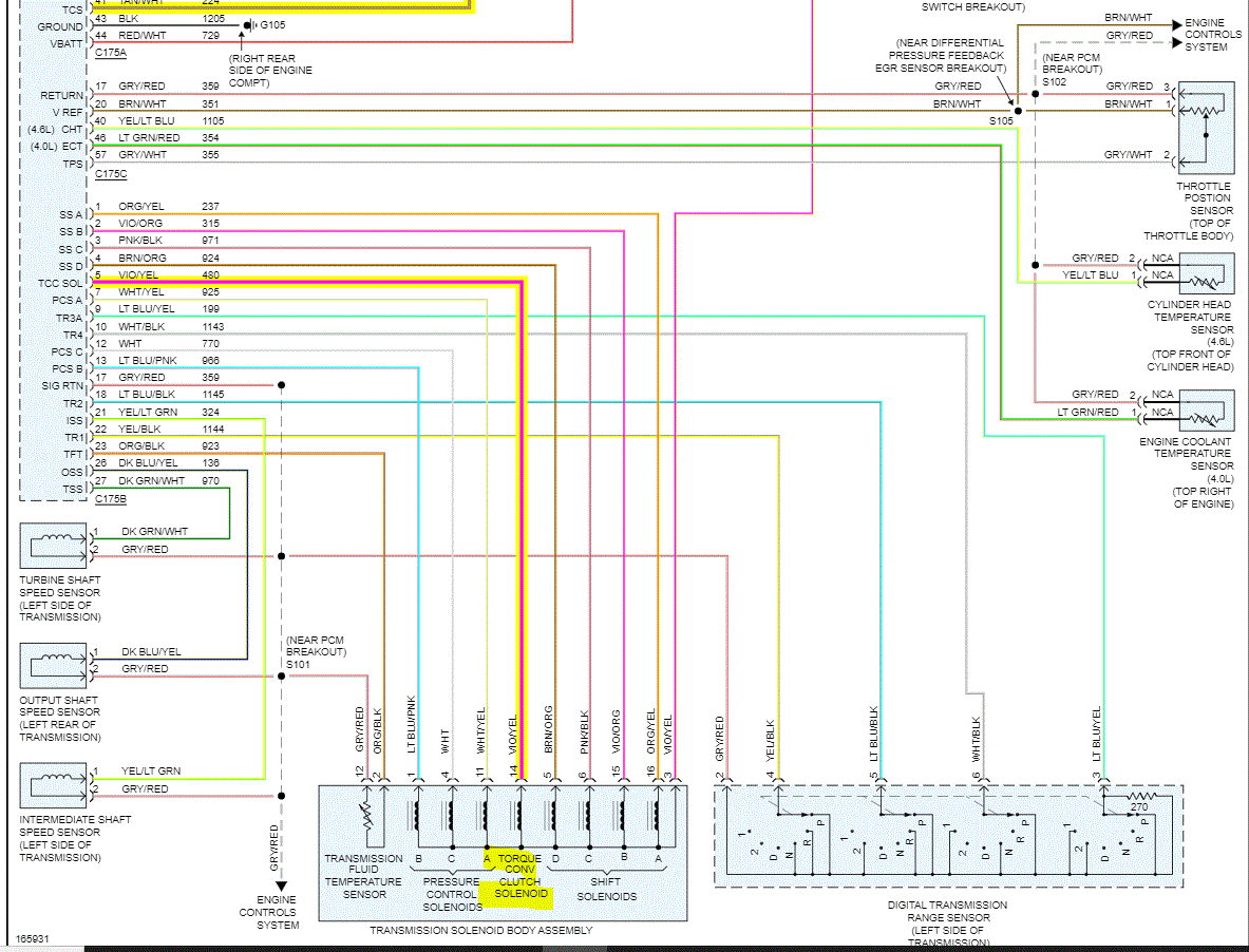

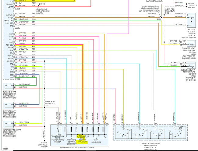

The code is for the overdrive switch, as you know. Have you checked the fuse for the OD switch? It is fuse 13 in the central junction box.
If you have already done that and it is good and has power, move to the switch itself and check for power in and out.
I attached the wiring schematic below for you to reference. I highlighted the fuse and wiring to and from the switch, and then the wiring from the PCM to the control solenoids.
May 2, 2022 at 12:48 PM
ARIANADANIELLE5345
  • 402 POSTS
Would that cause the shifting problem?
May 2, 2022 at 3:10 PM
  • 110,251 POSTS
No, that would affect the overdrive only. It is very unlikely it would prevent the transmission from engaging.

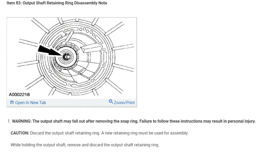

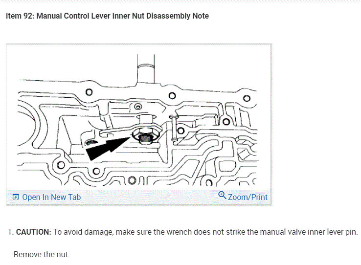

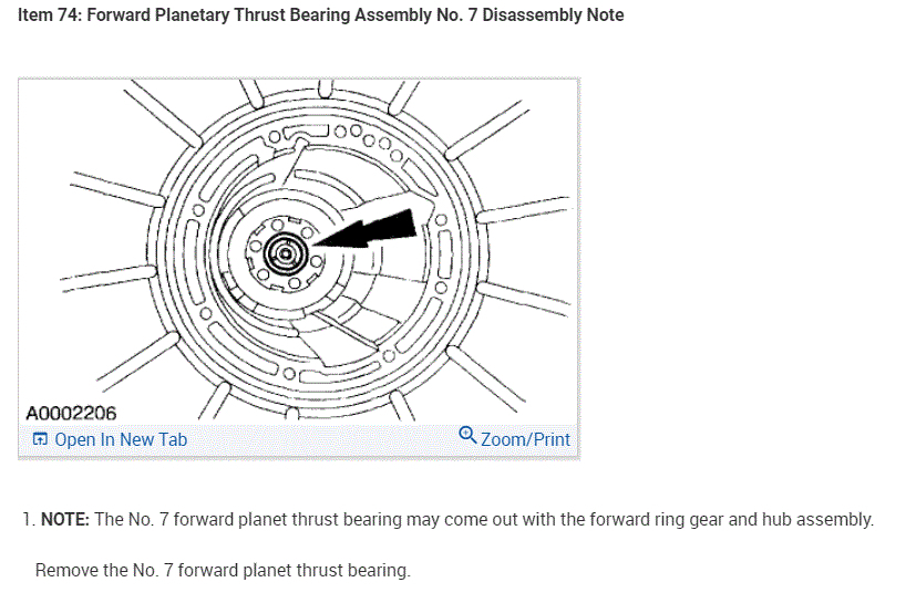

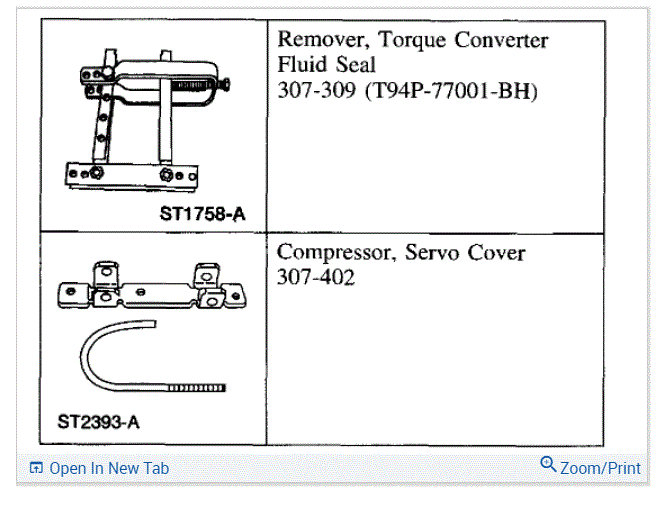

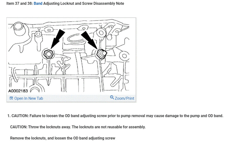

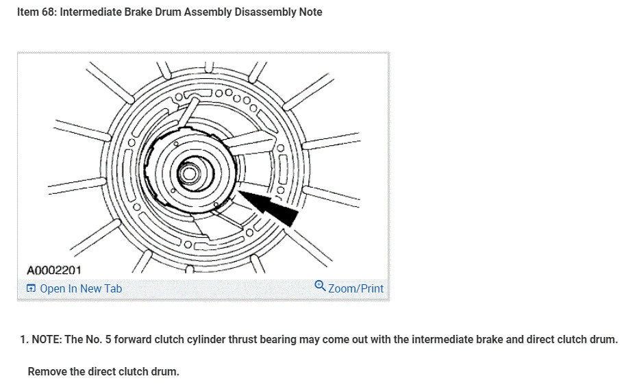

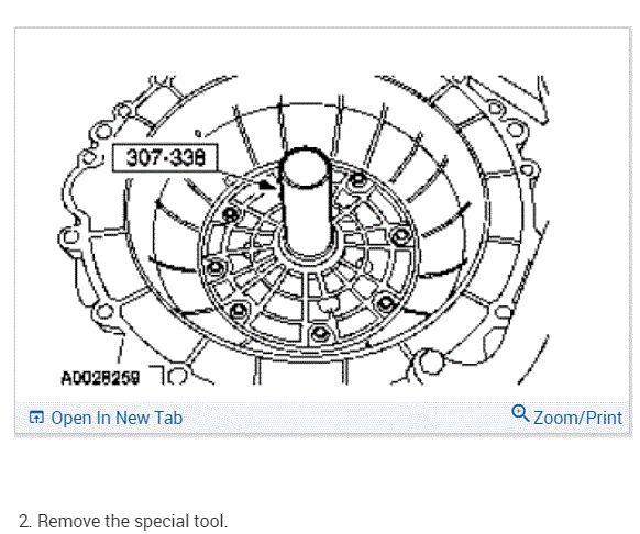

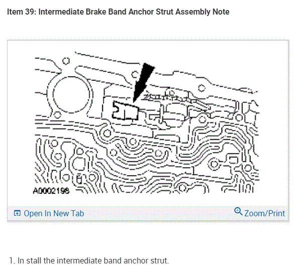

Ariana,

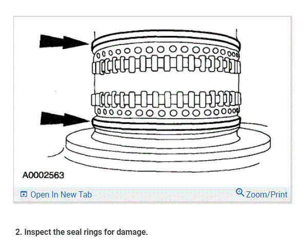

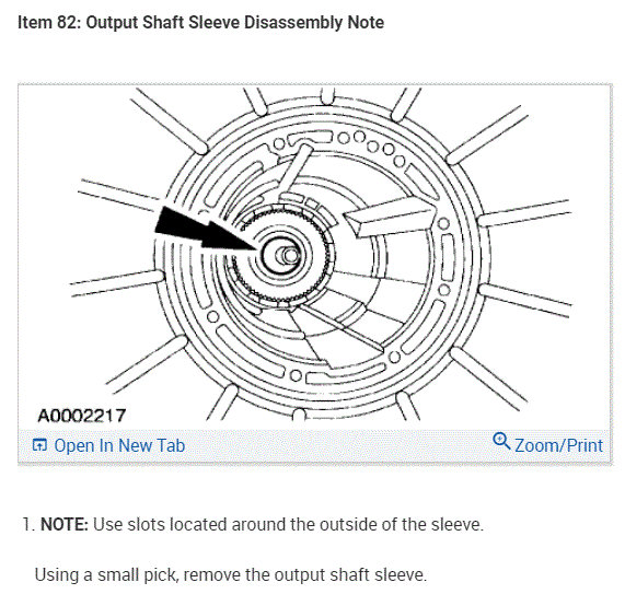

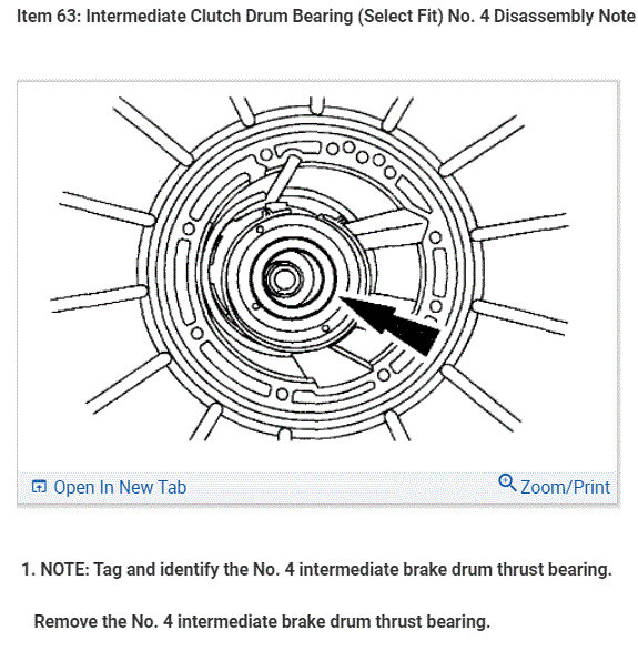

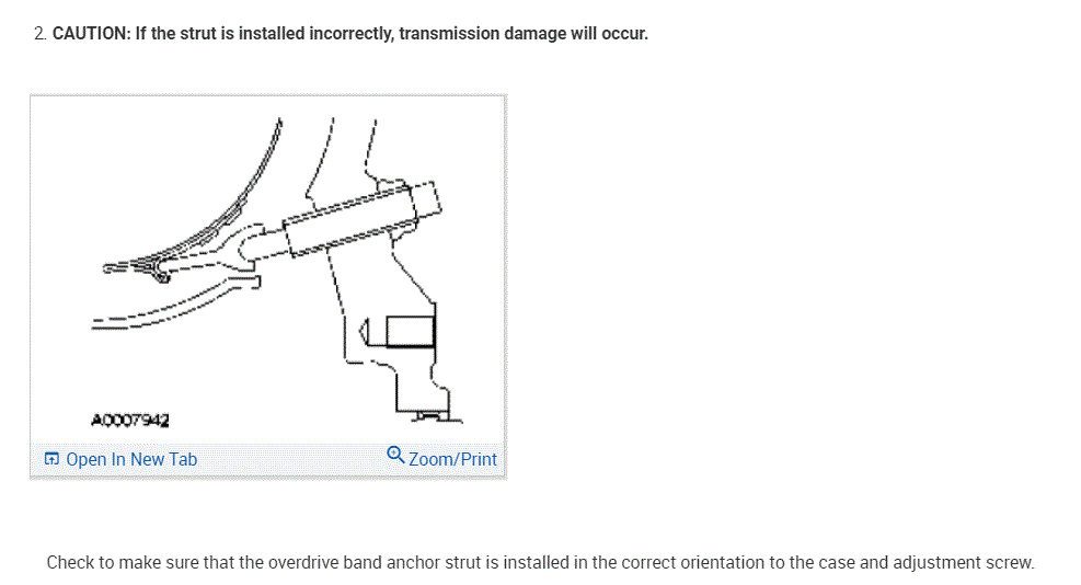

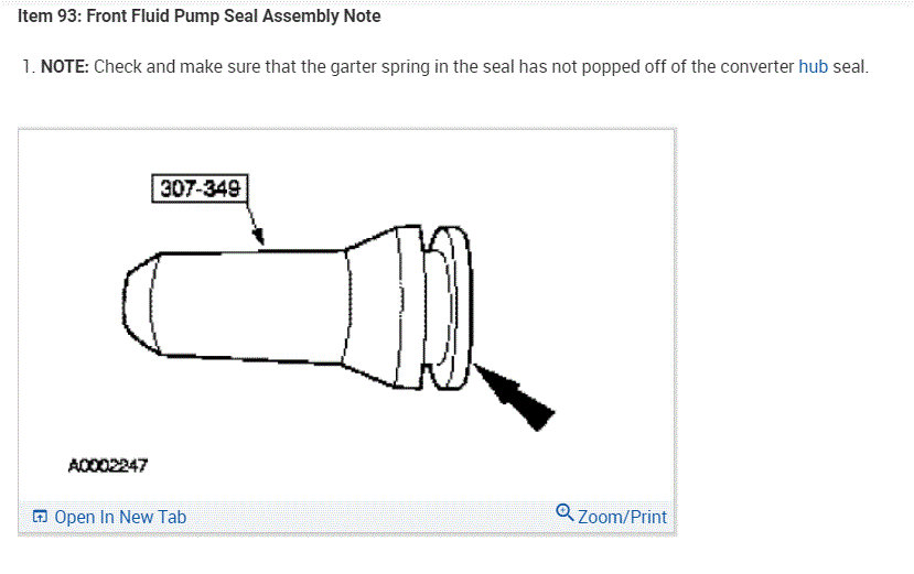

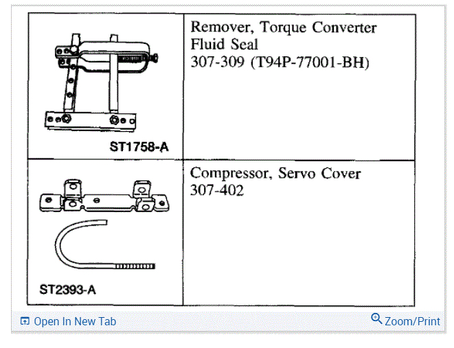

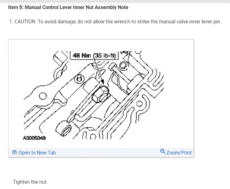

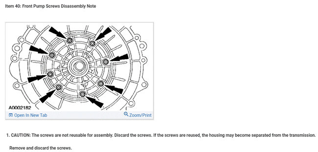

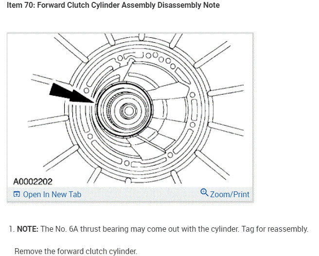

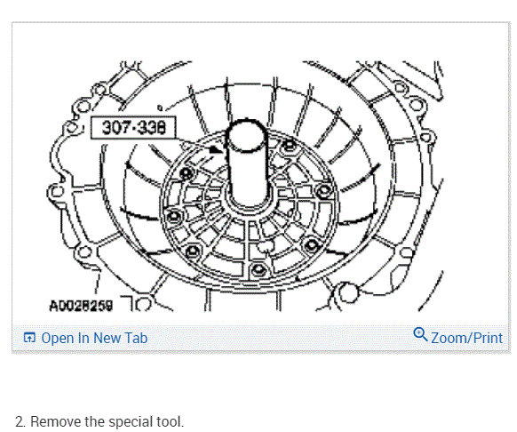

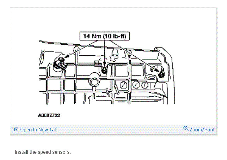

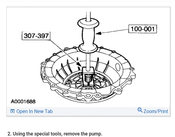

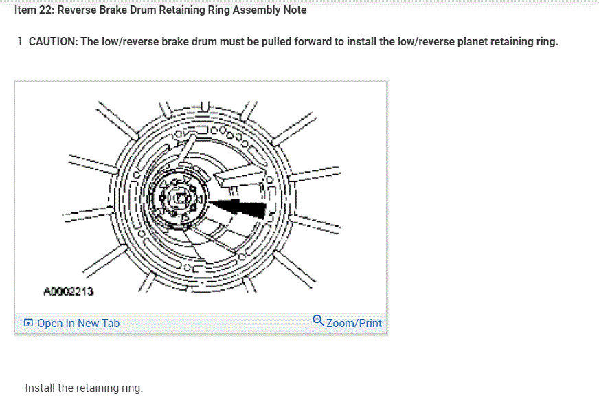

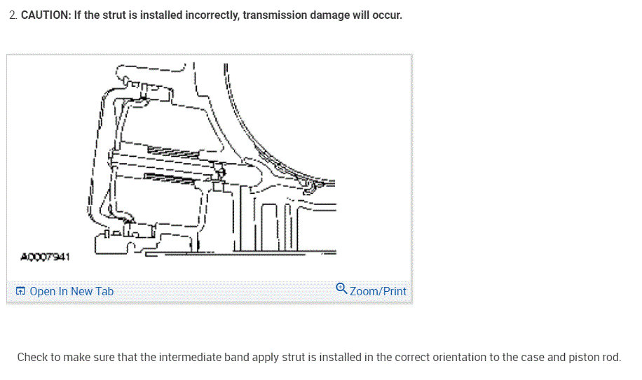

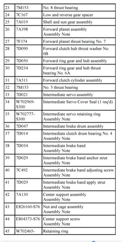

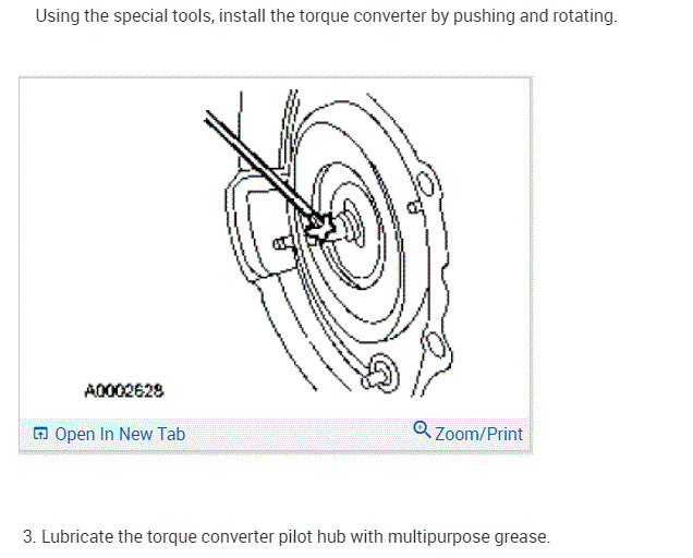

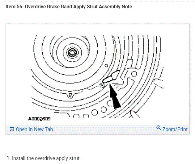

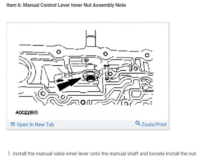

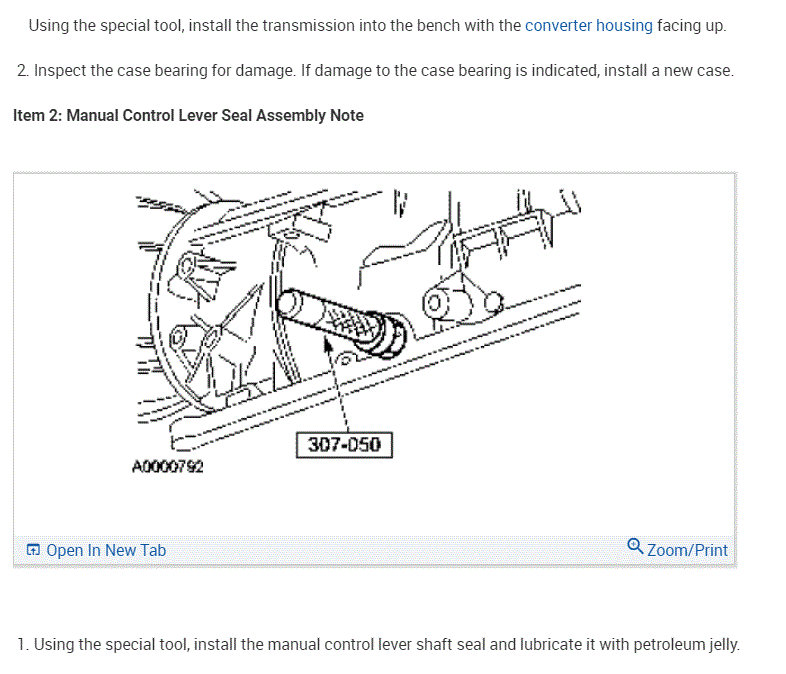

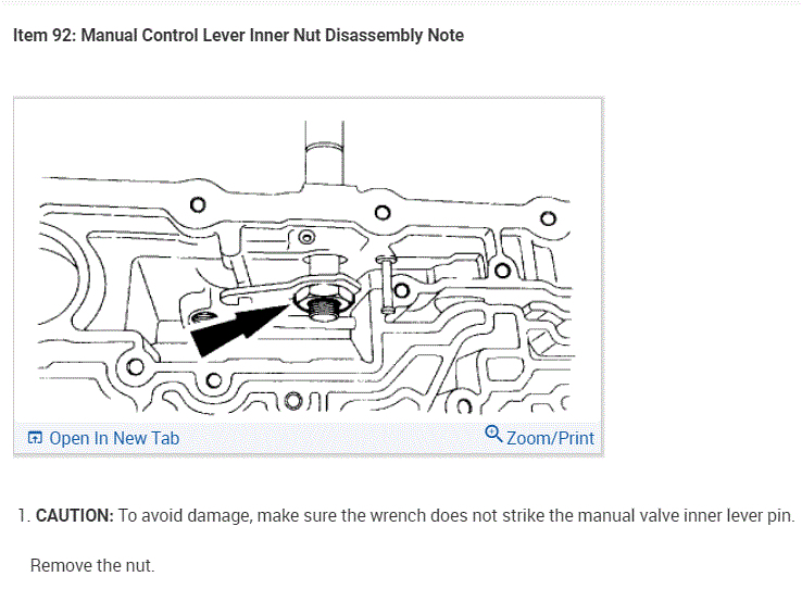

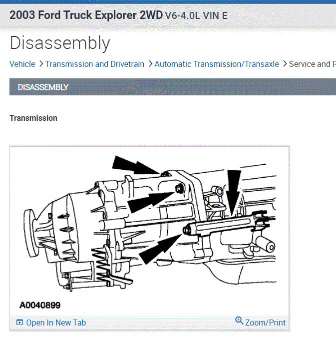

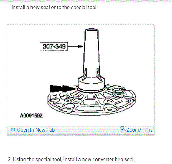

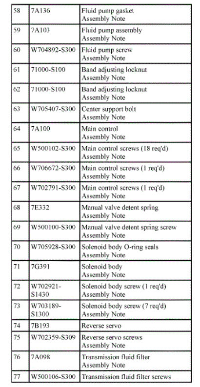

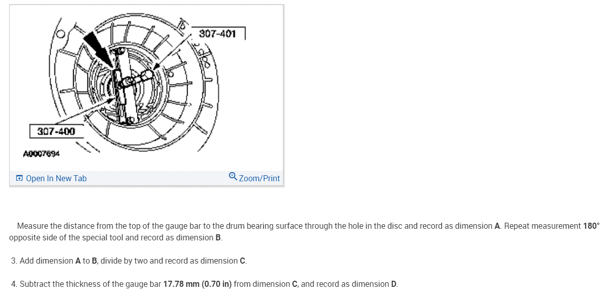

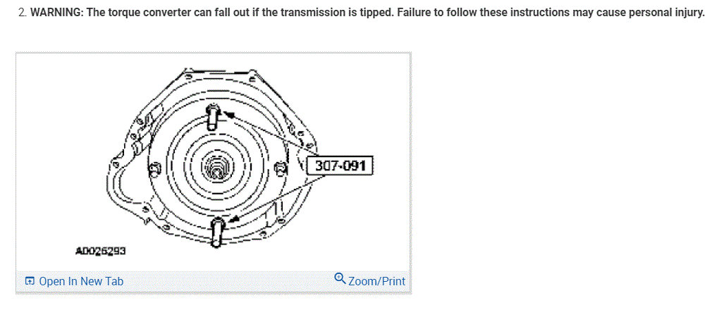

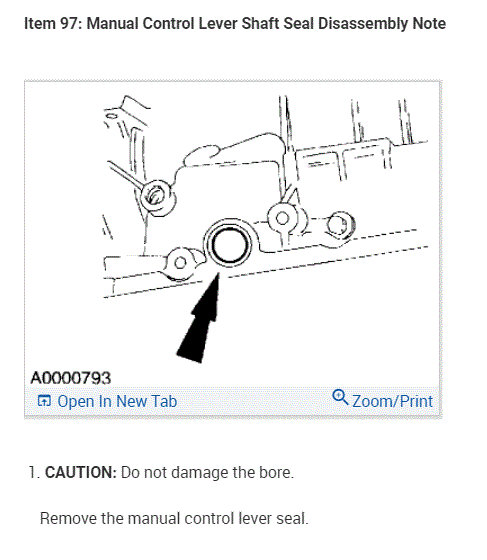

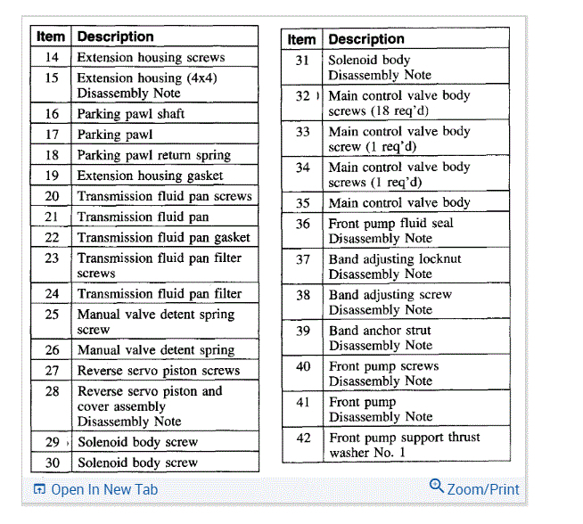

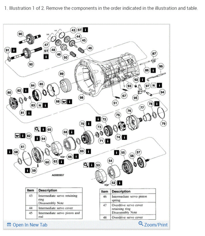

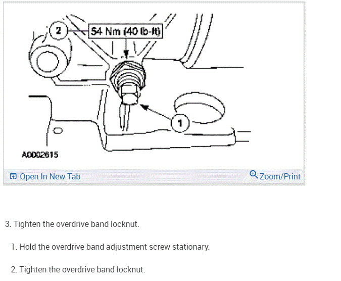

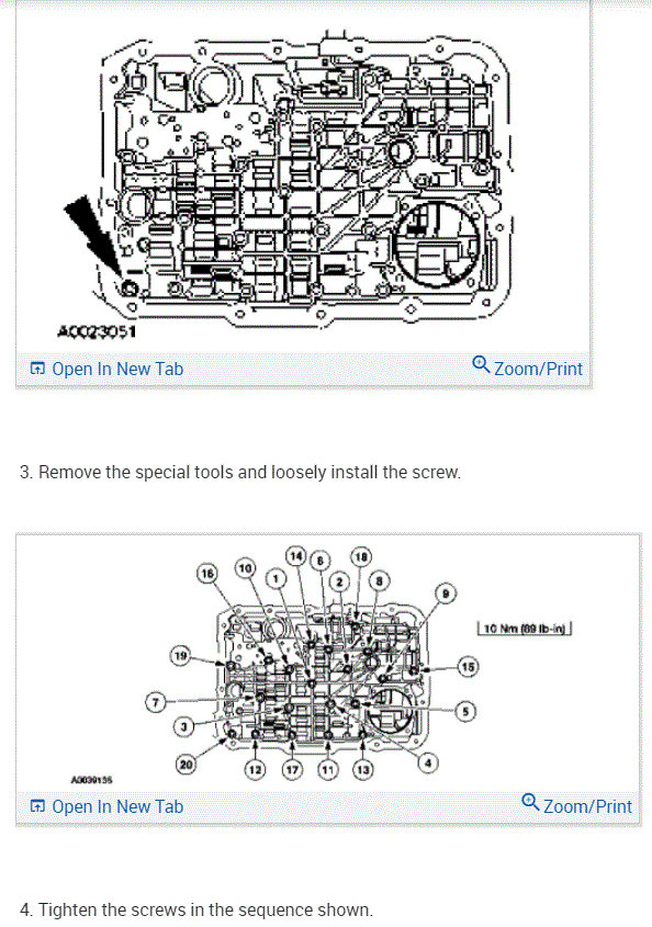

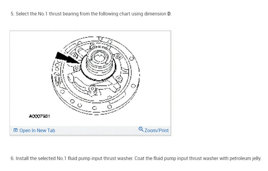

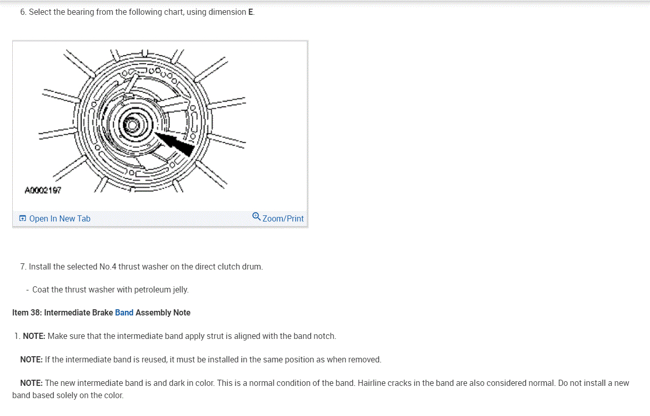

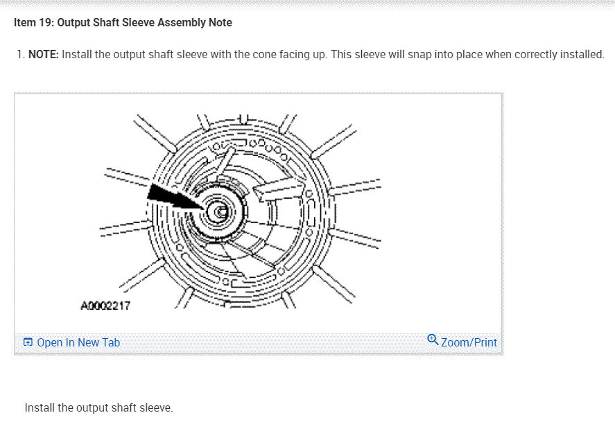

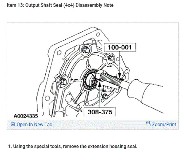

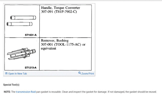

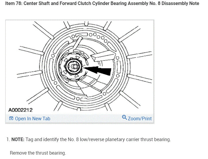

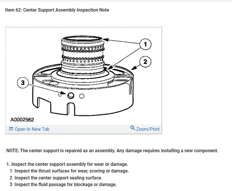

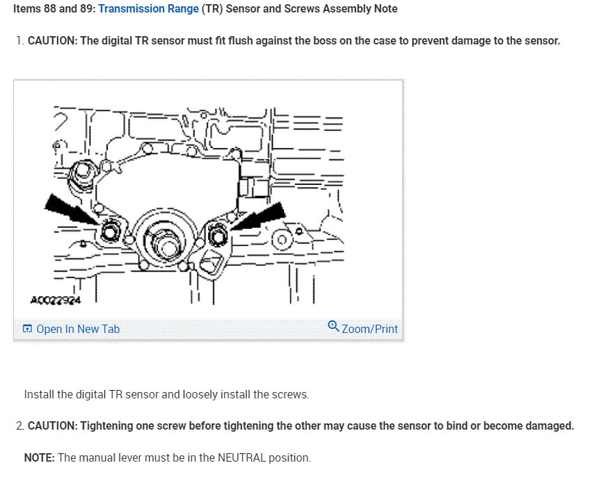

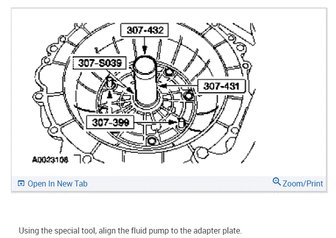

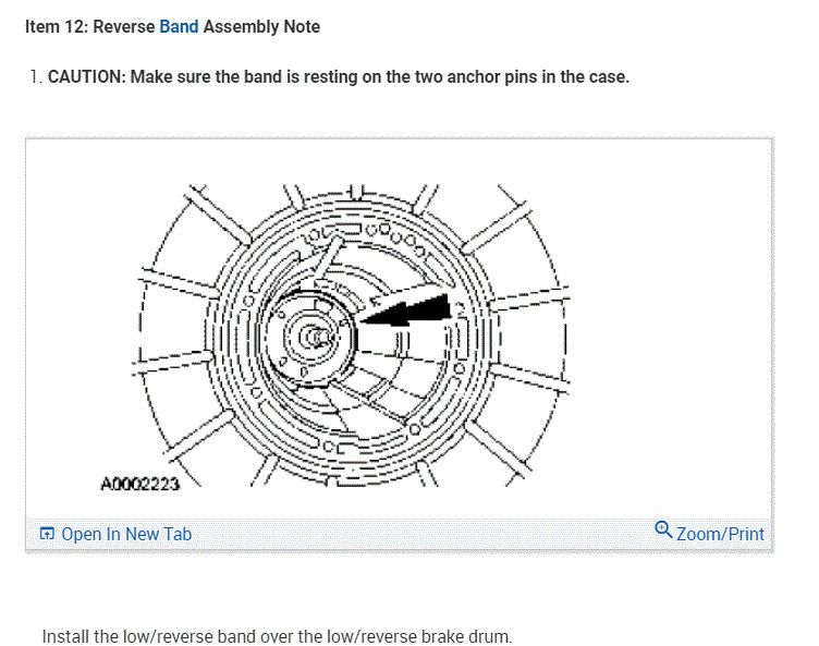

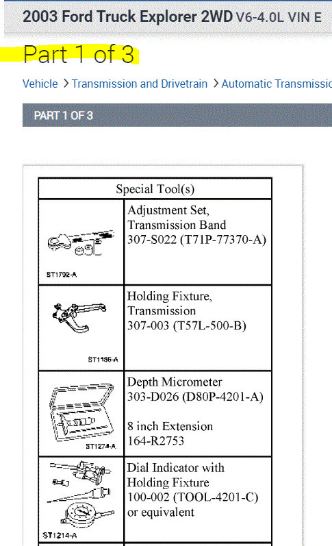

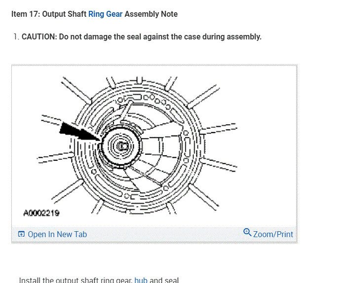

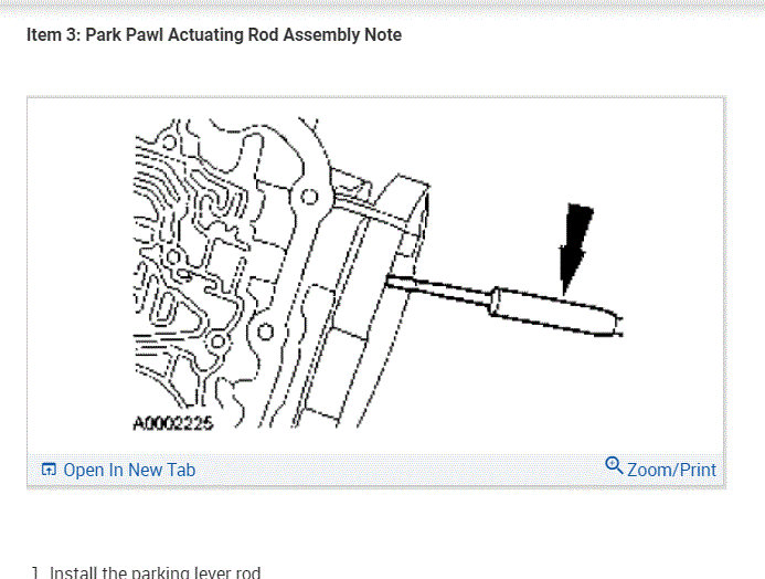

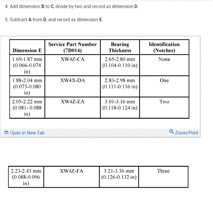

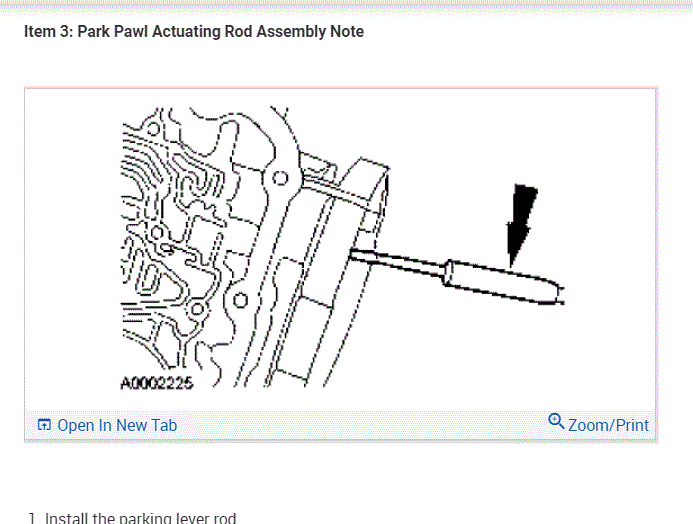

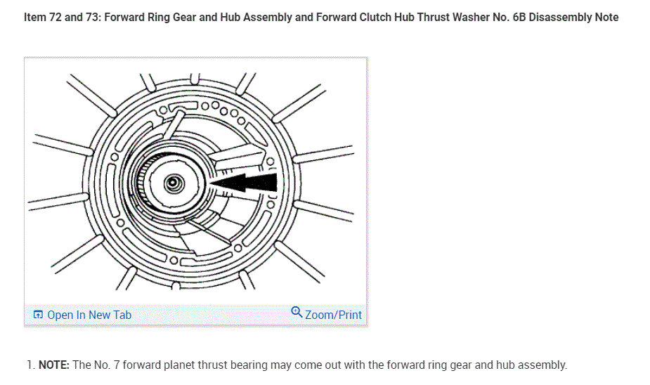

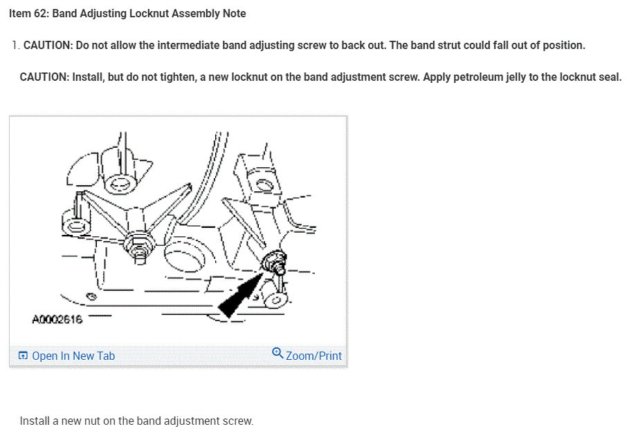

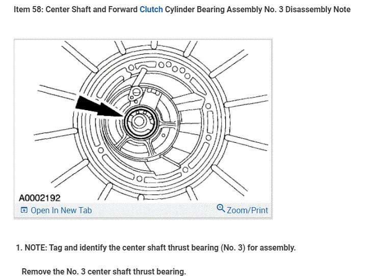

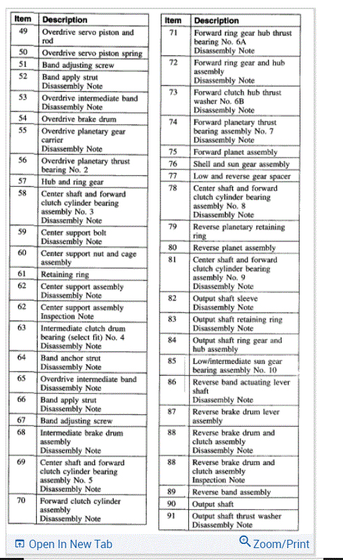

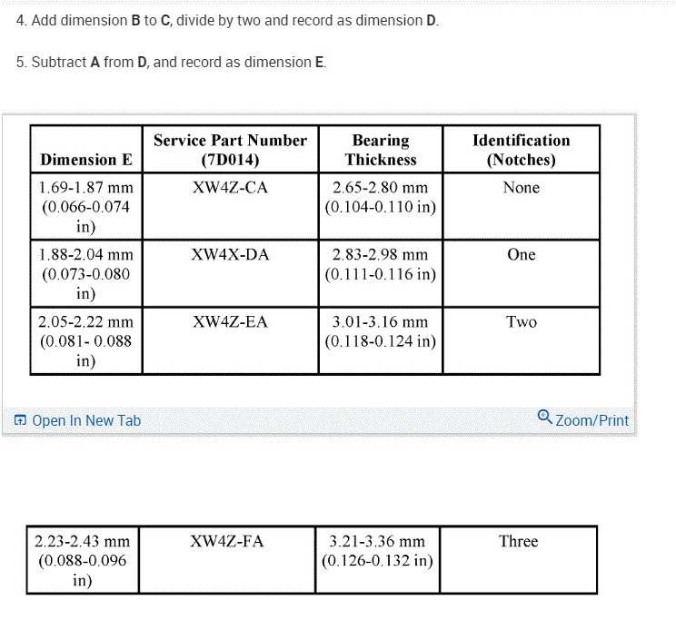

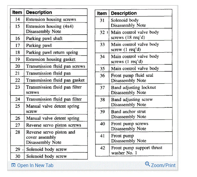

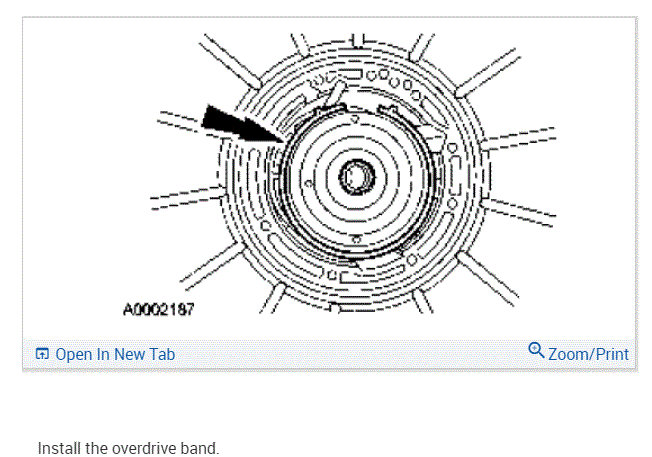

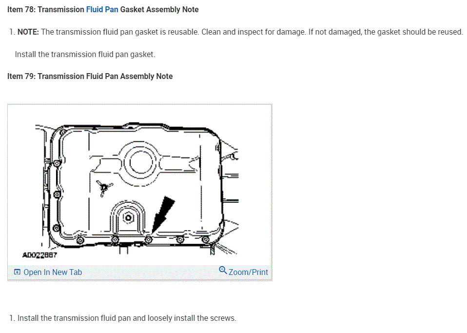

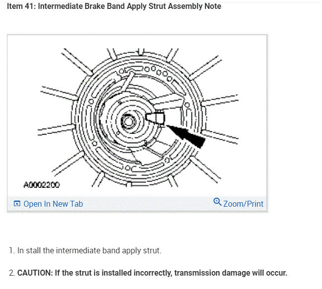

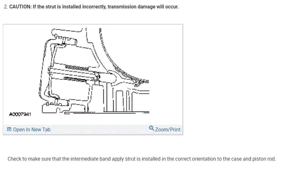

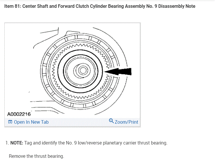

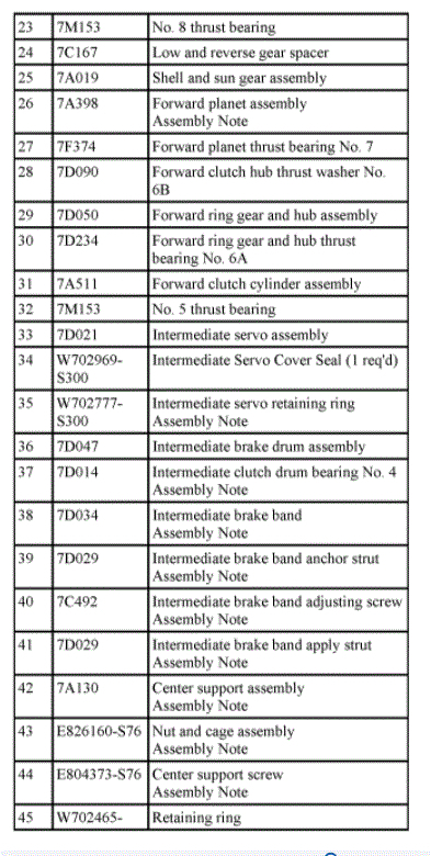

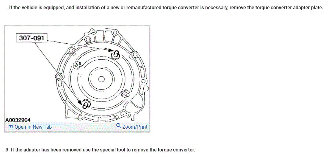

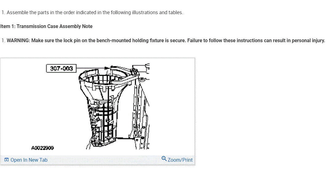

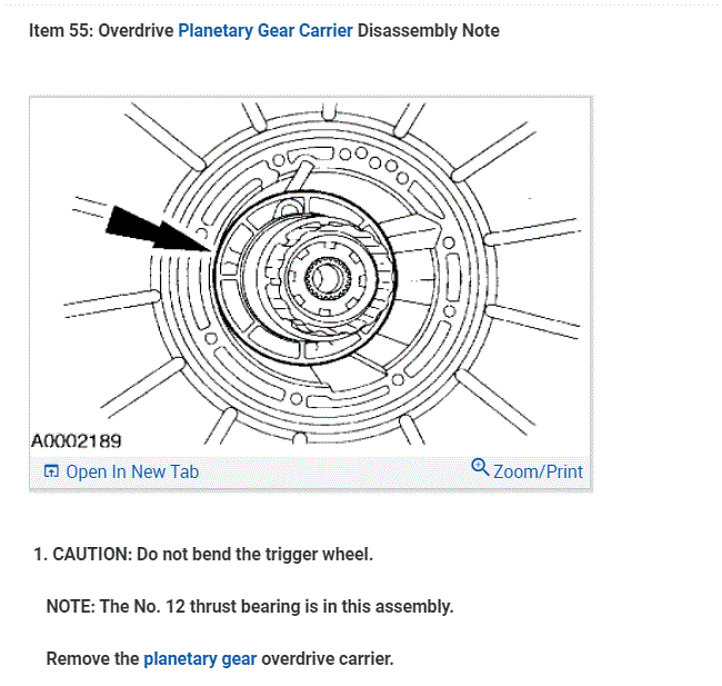

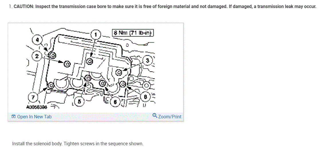

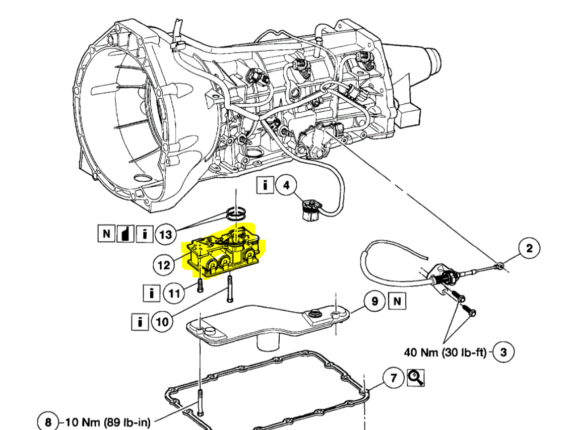

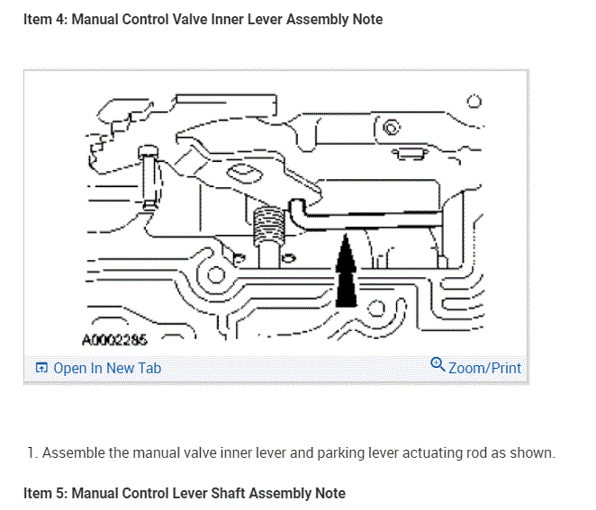

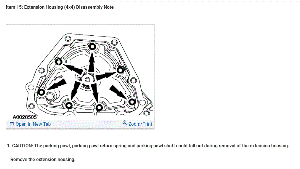

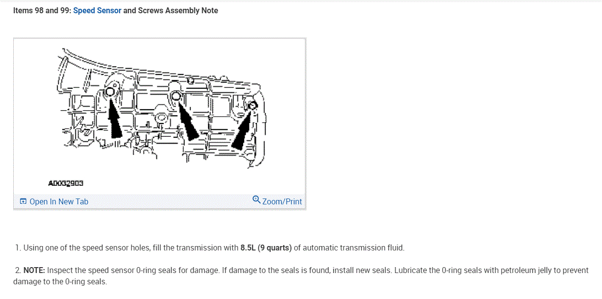

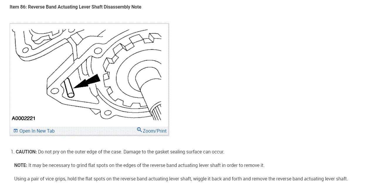

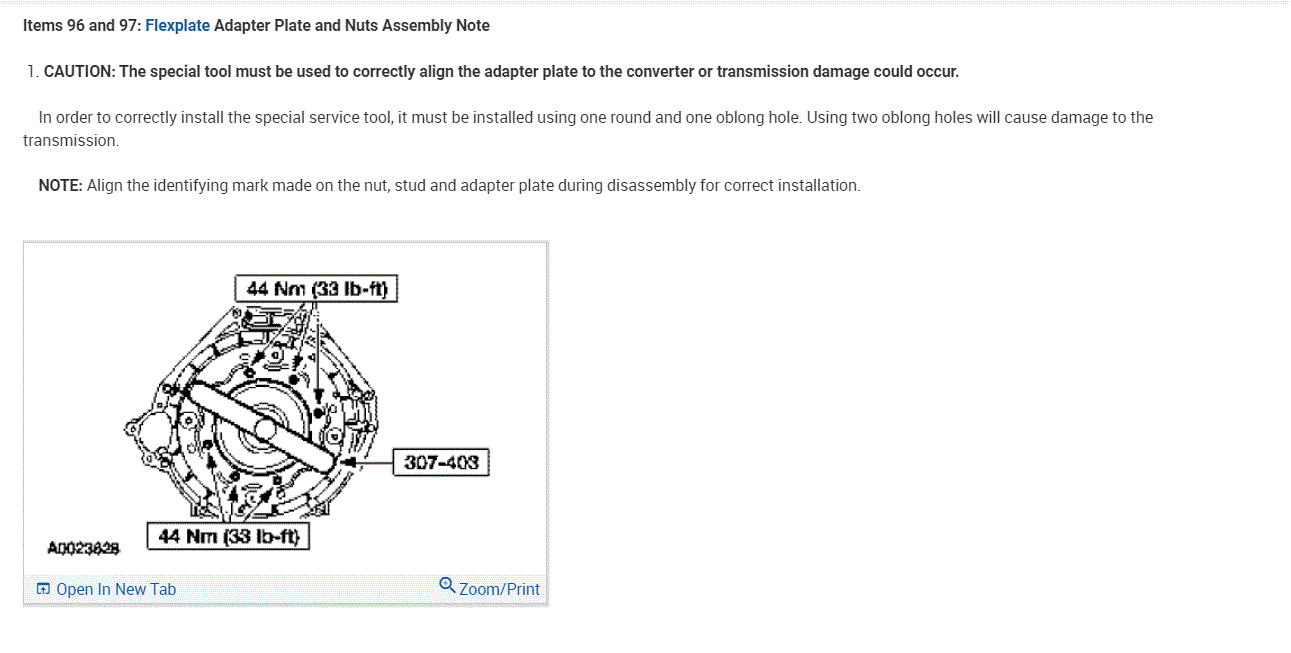

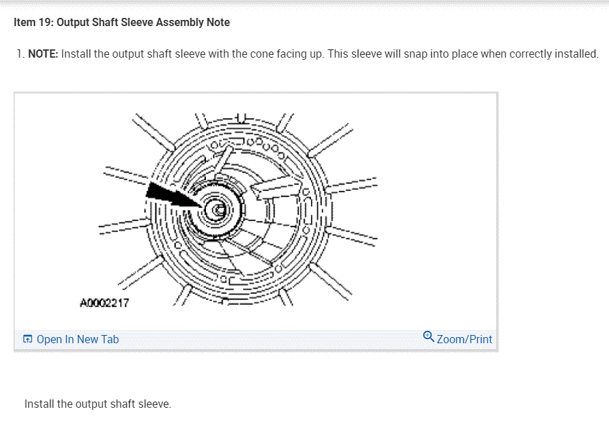

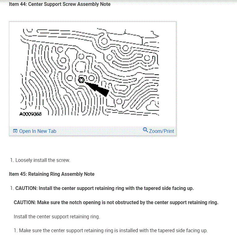

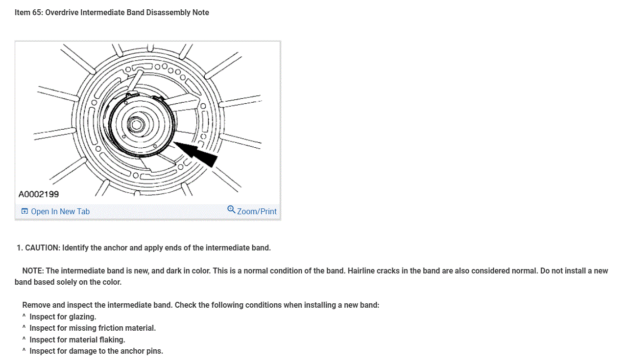

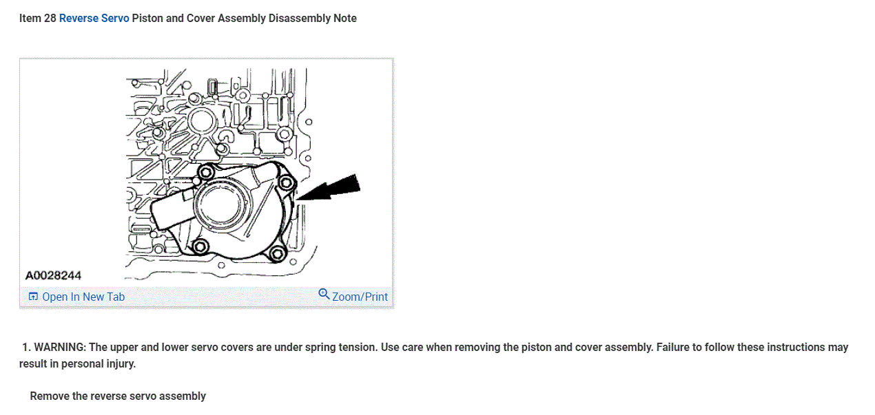

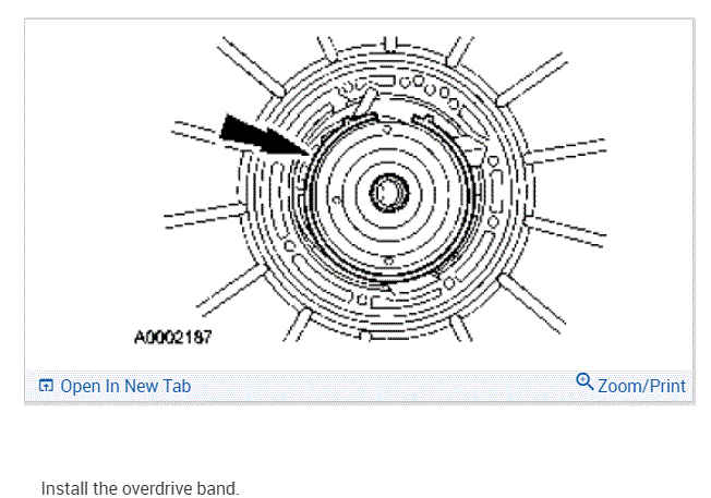

Don't worry about a manual. I can get you the directions for removal/replacement, disassembly, and reassembly. However, it is an extensive job, and I would feel really bad to have you do it when it's a pressure-related issue. But it's your call. I wish we could check the pressure before you take it apart. Also, you may want to see if you can find a good used one with a warranty because you are going to be putting some money into parts. I just don't want to mislead you.
Let me know which direction you want to go. I'm here either way.

  • 110,251 POSTS

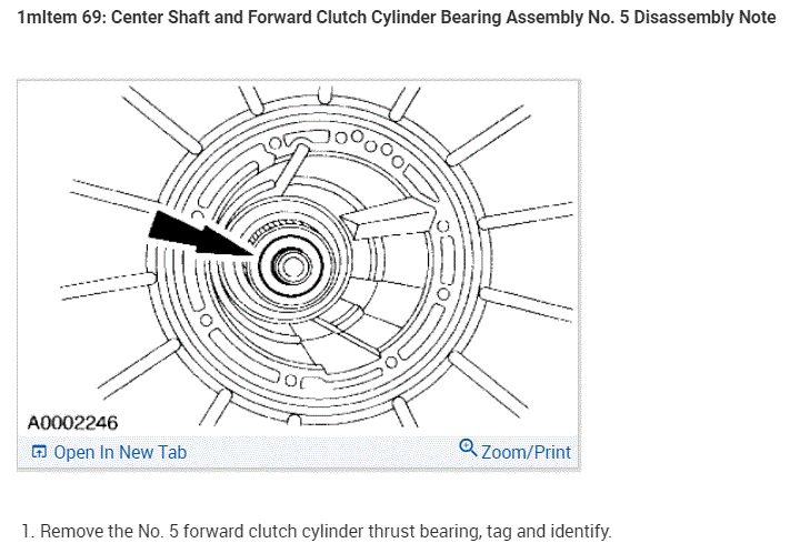

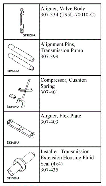

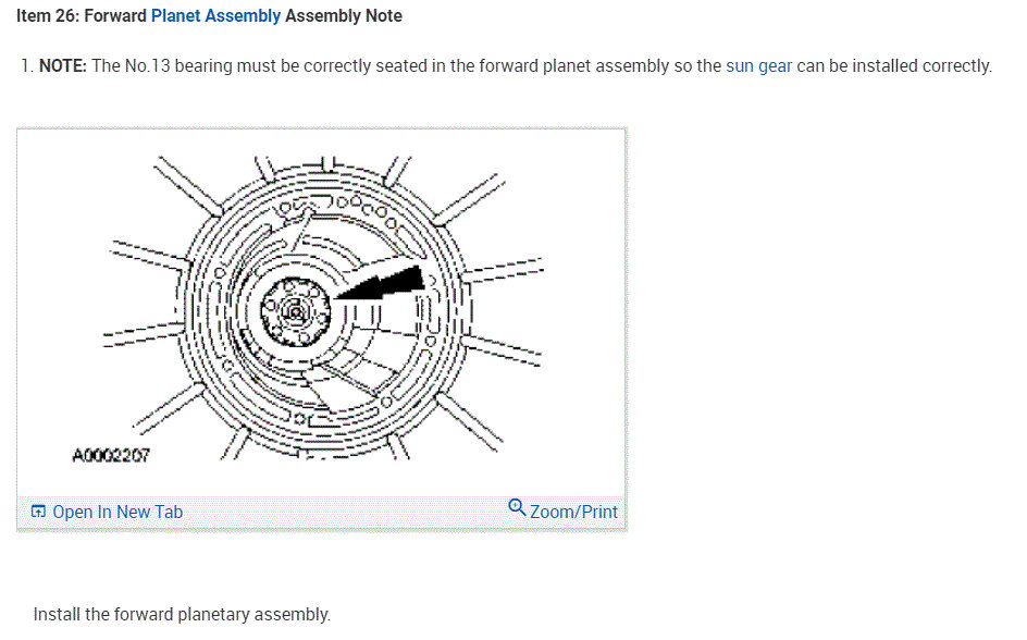

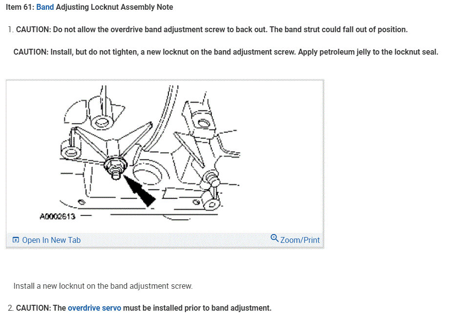

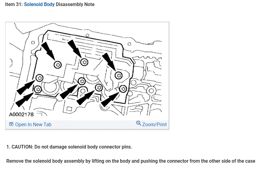

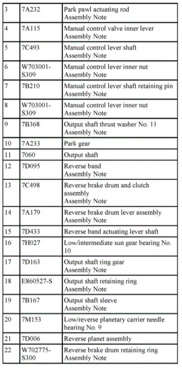

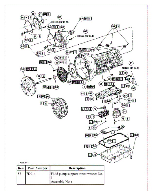

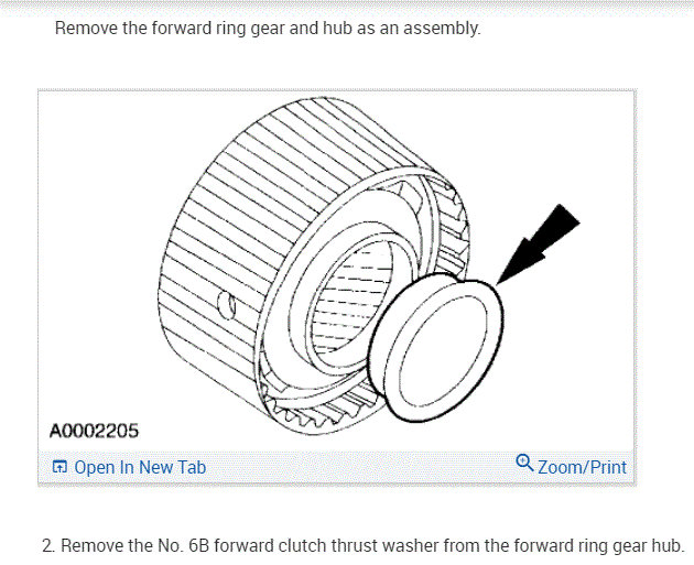

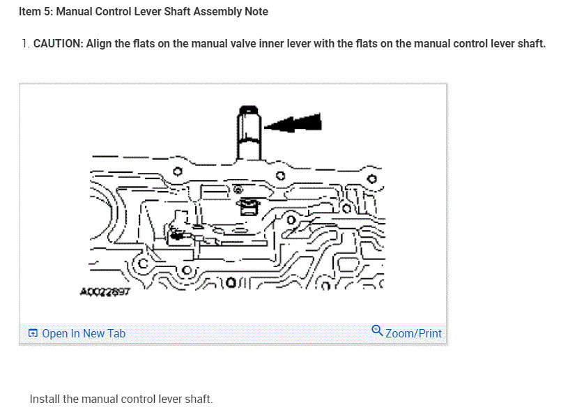

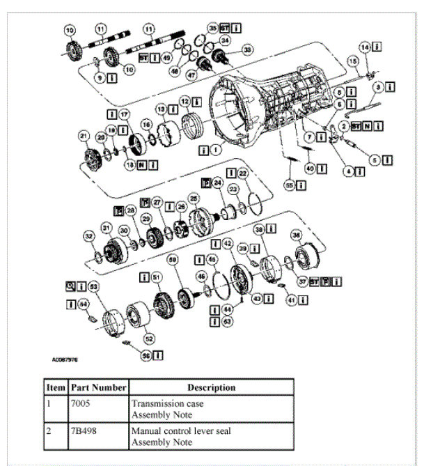

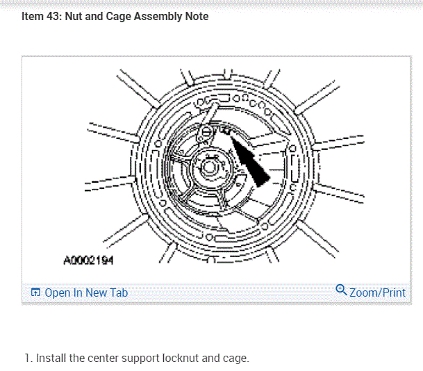

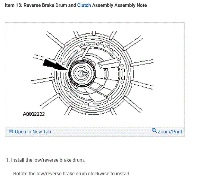

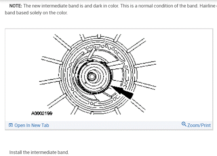

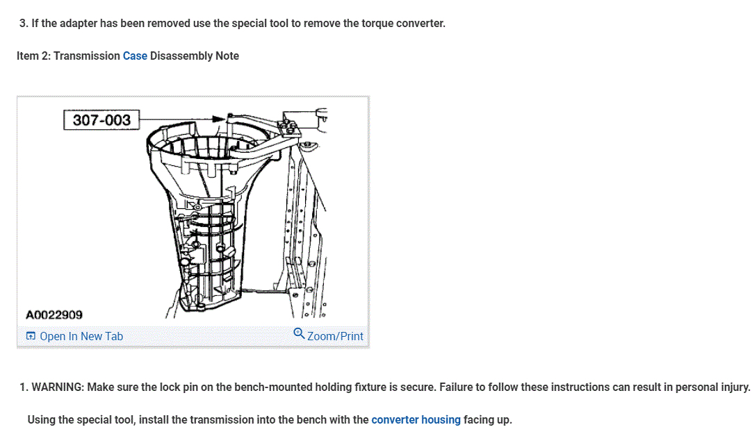

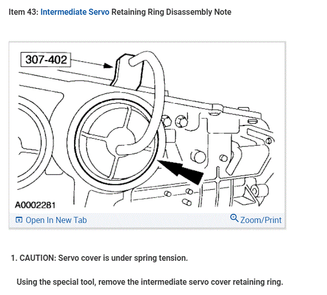

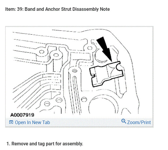

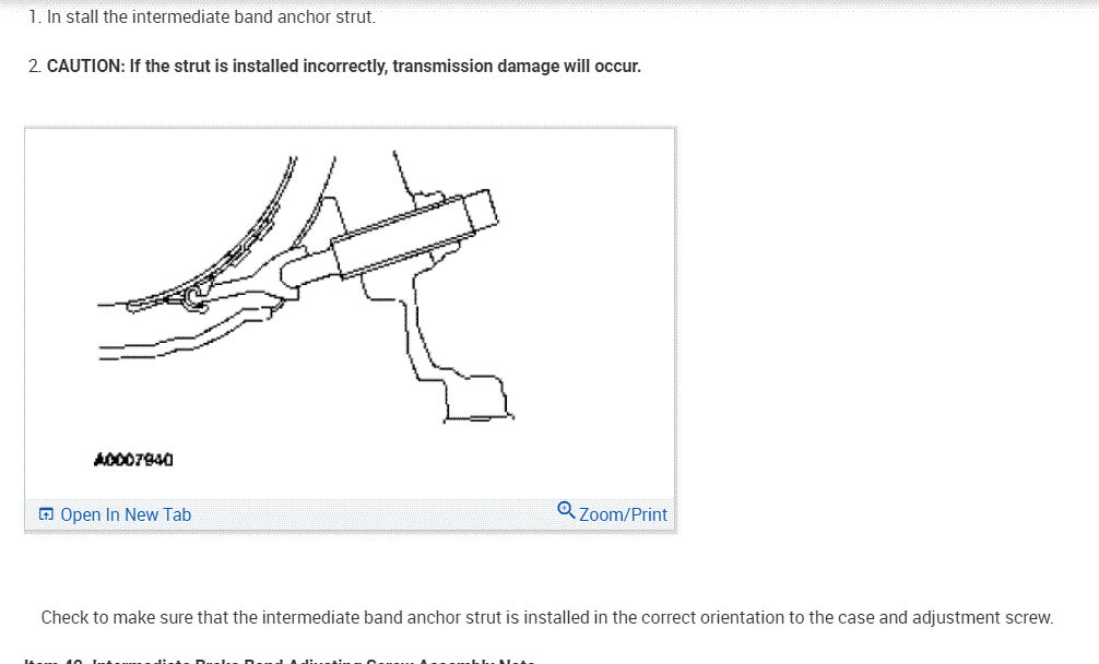

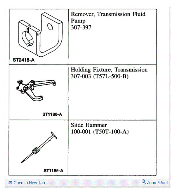

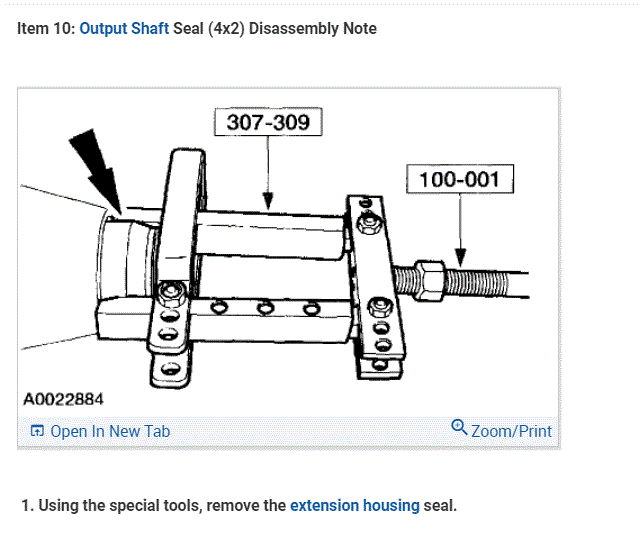

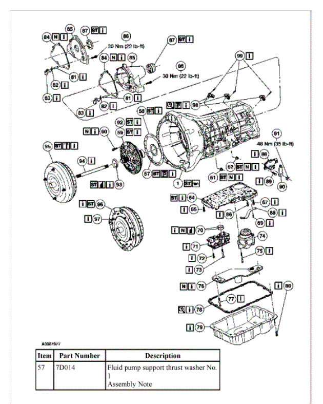

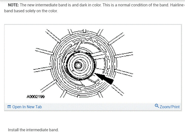

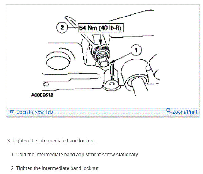

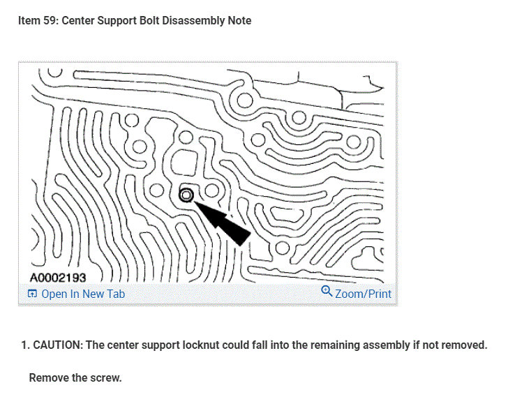

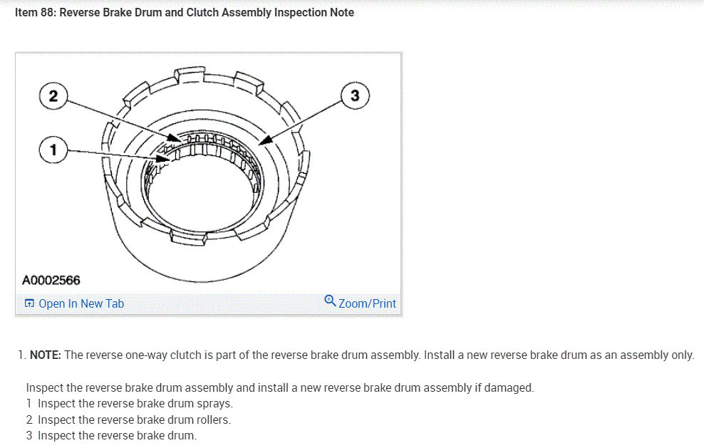

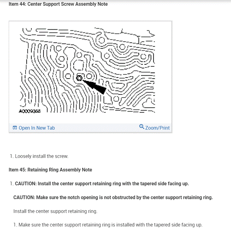

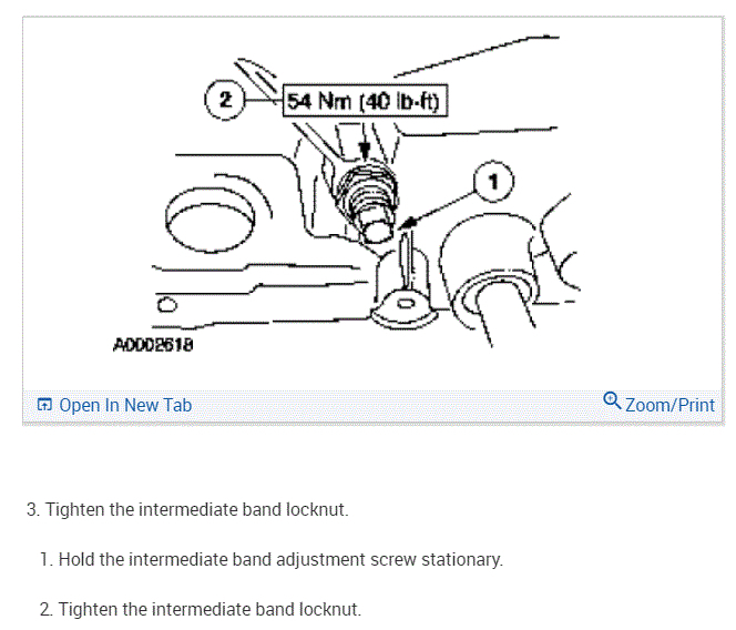

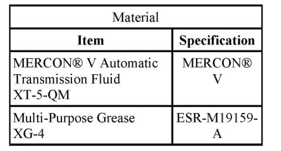

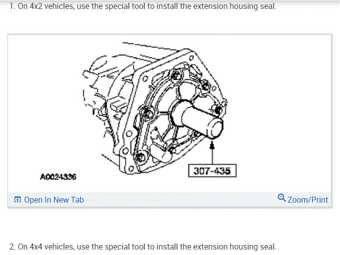

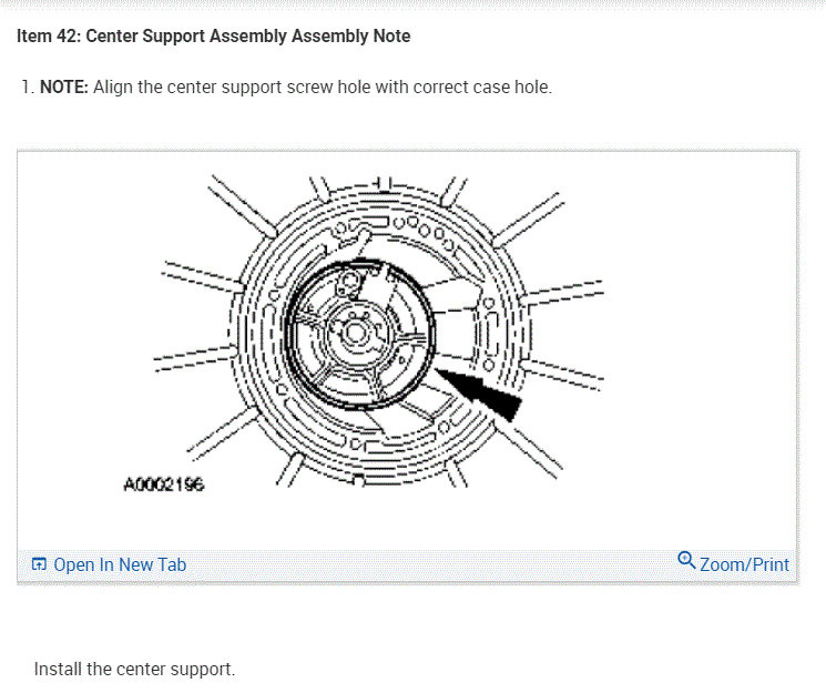

That is a great idea, Ariana. Are you going to do it? Are you confident they won't leave you in the middle of the project?

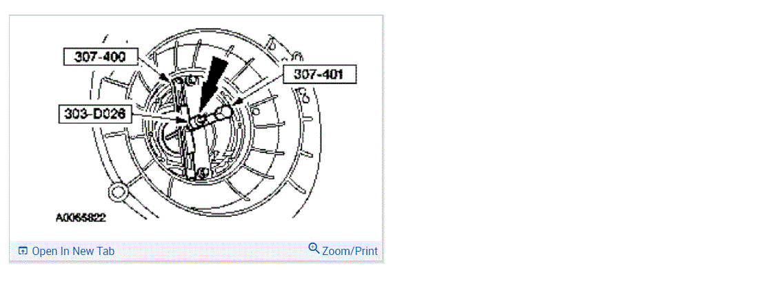

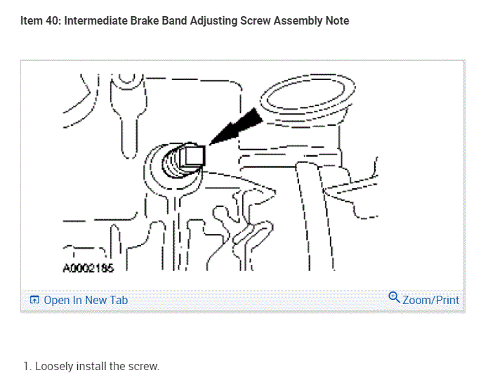

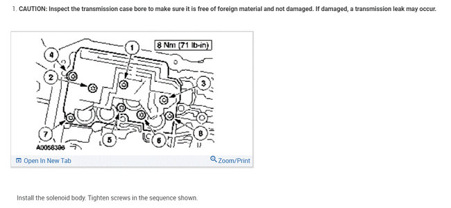

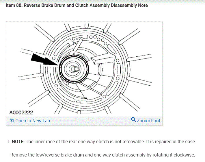

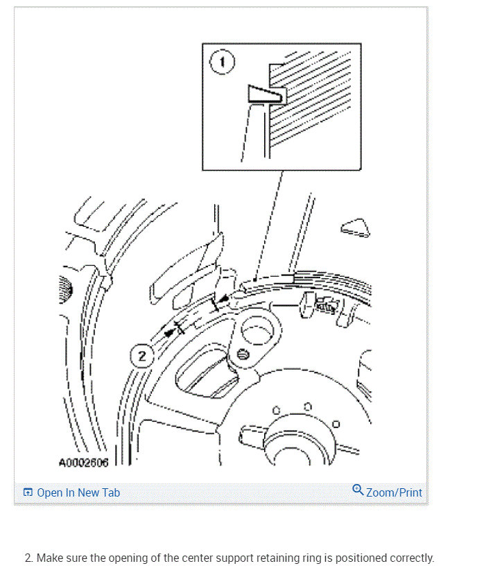

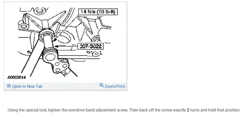

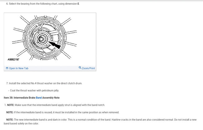

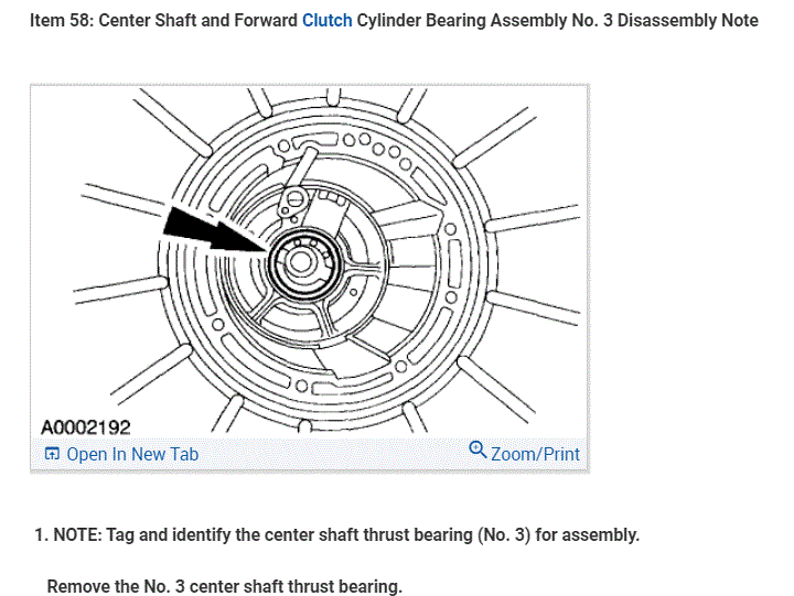

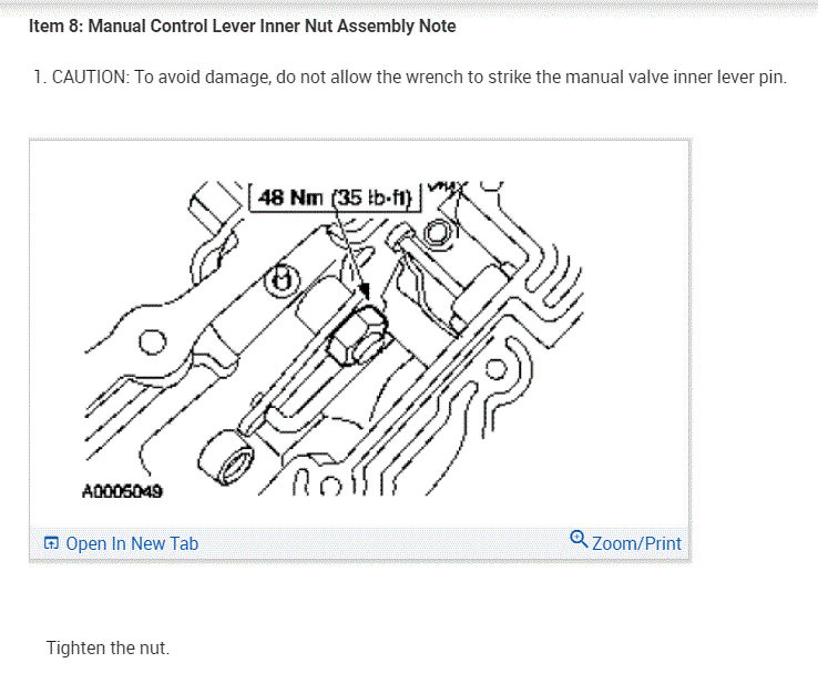

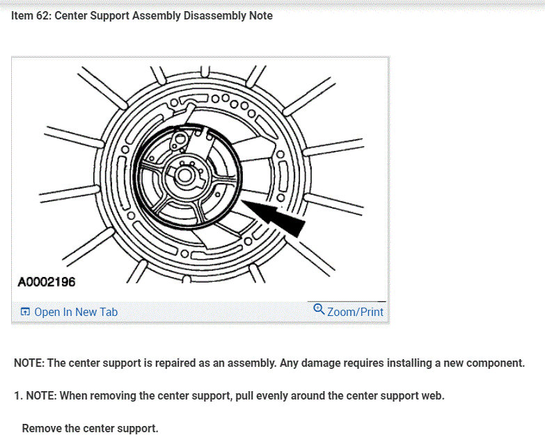

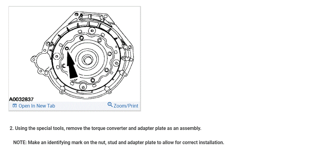

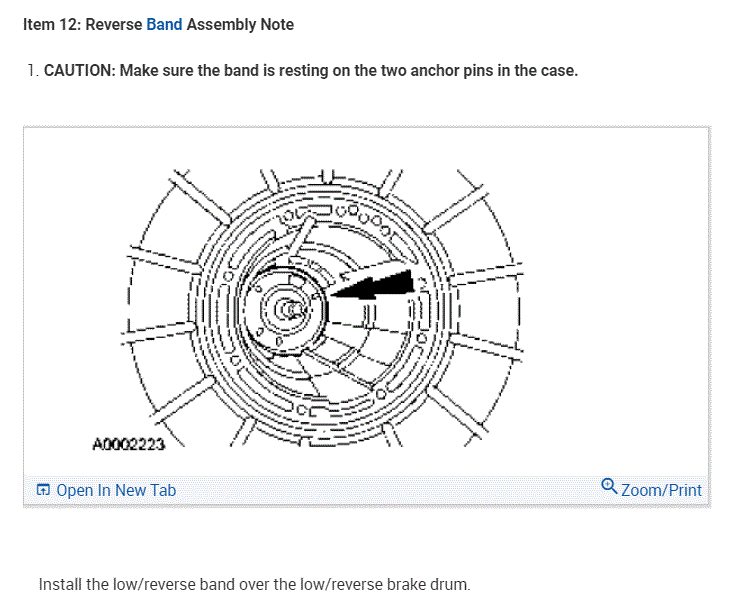

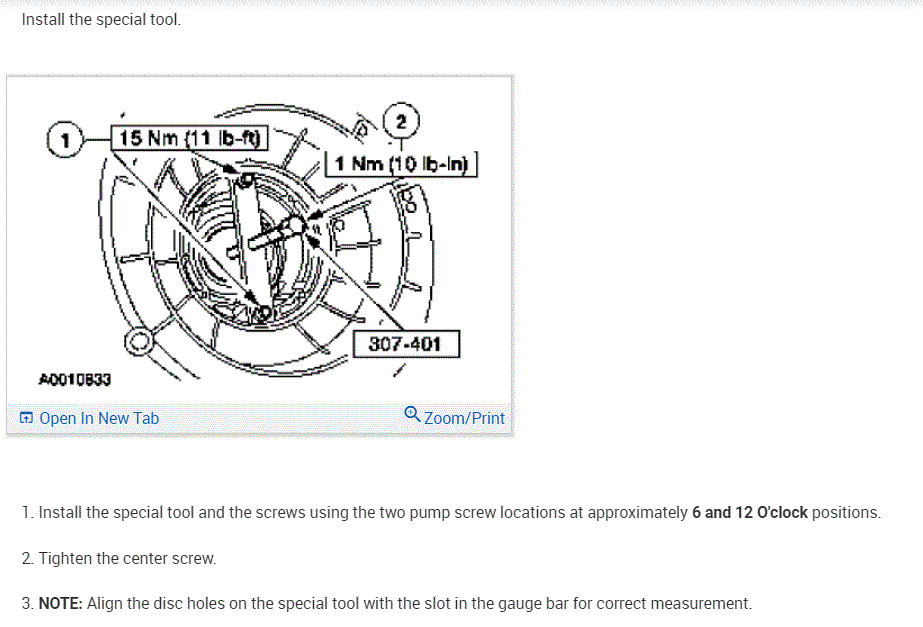

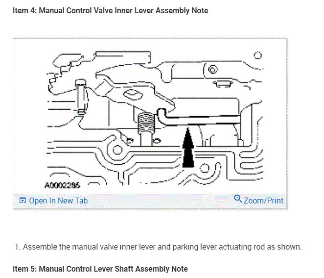

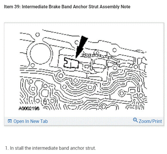

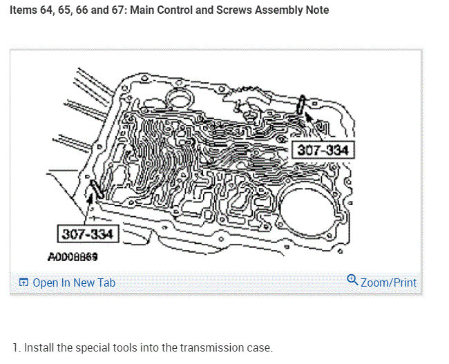

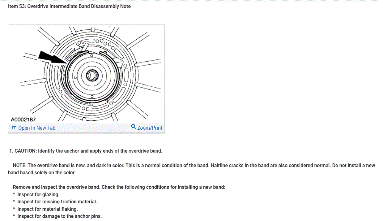

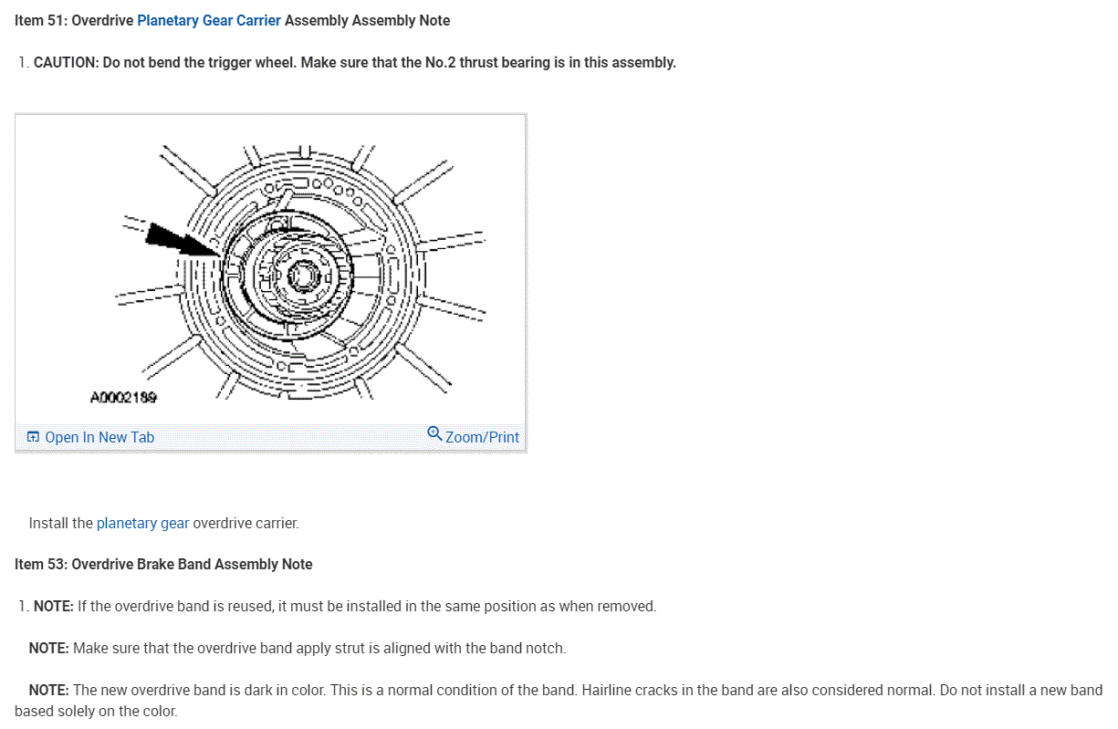

I just spent an hour copying everything for the disassembly and reassembly of the transmission. I wanted you to have them. They are very extensive but relax. One step at a time and you'll be fine.

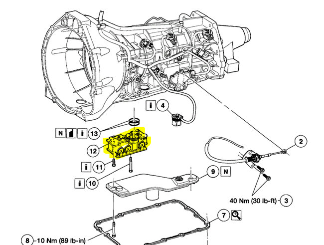

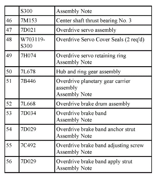

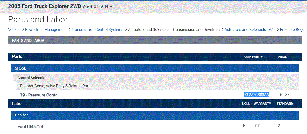

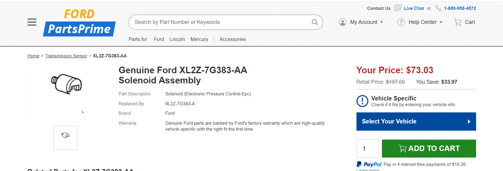

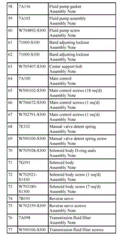

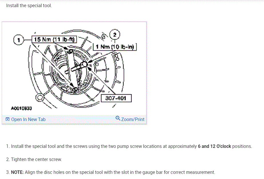

I look forward to hearing from you. LOL A compression gauge won't work. That is likely why it is leaking. Did you ask around at parts stores to see if they would lend one to you? Also, the shop that offered to help you, would they lend one to you?
I attached the part number from the manual and found one online for you. I would feel really bad if you made the effort to find it didn't work. Ugh!! I feel like I'm driving you crazy. LOL
Regardless, see if they will lend you a pressure tester. The part isn't really cheap, but you can likely find it for less than what I found.
Let me know and I hope you are enjoying the weekend.

Not driving me crazy at all. lol, but I meant the part number for the solenoid. I am just going to buy the part without doing the test because I’m pretty sure you’re right.

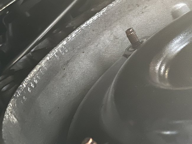

Apparently, I have to rebuild my engine again. The drive plate has worn down teeth and the bell housing have marks from it. I was told that means my crank and thrust bearing need to be replaced and that also is what caused my rear main seal to leak. I paid the machine shop that ended up screwing up my heads to grind my crank because they assured me, I could still use it because nothing was wrong with it. It all makes sense now because I had to replace the drive plate during the rebuild because it had a slight indent which I'm told was a contributing factor to my transmission needing to be rebuilt in the first place. So, I don’t really know what to do. I can’t afford to rebuild my engine again or to put a rebuilt one in. I just don’t know what I’m going to do at the moment.

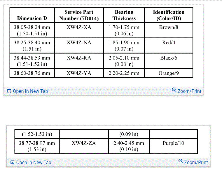

If they cut the crank, did you use oversized bearings to match their cut? Also, how much in and out play is there at the crankshaft pulley?
May 11, 2022 at 1:05 PM
ARIANADANIELLE5345
  • 402 POSTS
Is cutting the same as grinding? Because they never said anything about cutting. All they said was $90.00 to grind the crank so I said okay, if it needs it then do it and then they told me I could use standard size bearings and everything which is why they didn’t bore the block and only honed it.
May 12, 2022 at 5:45 AM
  • 110,251 POSTS
Ariana,
Grinding is the same. If they removed any of the surfaces, the original size would have allowed more clearance. Most times, the cranks are ground to .010, .020, .030, and even 0.40. If the crank was ground, I would have thought at a minimum a .010 oversized bearing would have been required.
If in fact the crank needed ground, I would have expected them to grind a specific amount to, you would know what size bearing was needed. If they took nothing, it didn't need ground.

I couldn't agree more. Also, I was correct. Crankshaft grinding always requires an oversized bearing. I've heard of having the crank polished which would allow the OEM size bearing, but not grinding.
