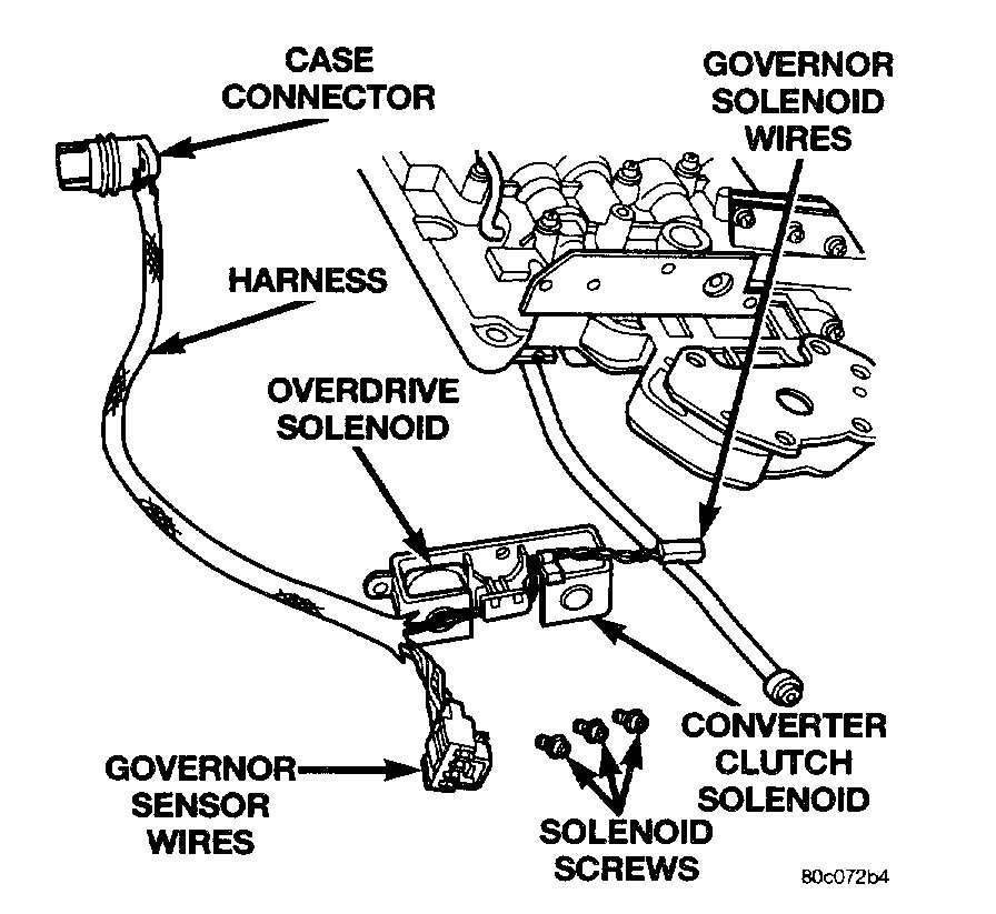

The overdrive does not engage. The button on the shifter works. It was working fine fluid is full. When it gets to third gear and passing gear still works, but does not go into overdrive.
Sep 29, 2018 at 8:13 AM
  • 110,194 POSTS
There are a few things which can cause this, sensors, actuators, solenoids. Often times, the overdrive solenoid fails and overdrive is lost. I attached a picture of the solenoid. It is inside the transmission. However, I would not arbitrarily replace it without confirming it is bad.
What I suggest first is to scan the computer for trouble codes. If the check engine light is on, there will be codes. Here is a video that shows how to check:
https://youtu.be/b2IJGfImVvw
If you do not have access to a scanner, most parts stores will do it for free. We need to start there. If the problem is related to the transmission control module or there is an electrical issue such as a bad overdrive solenoid, it will most likely set a trouble code.
Let me know what you find.

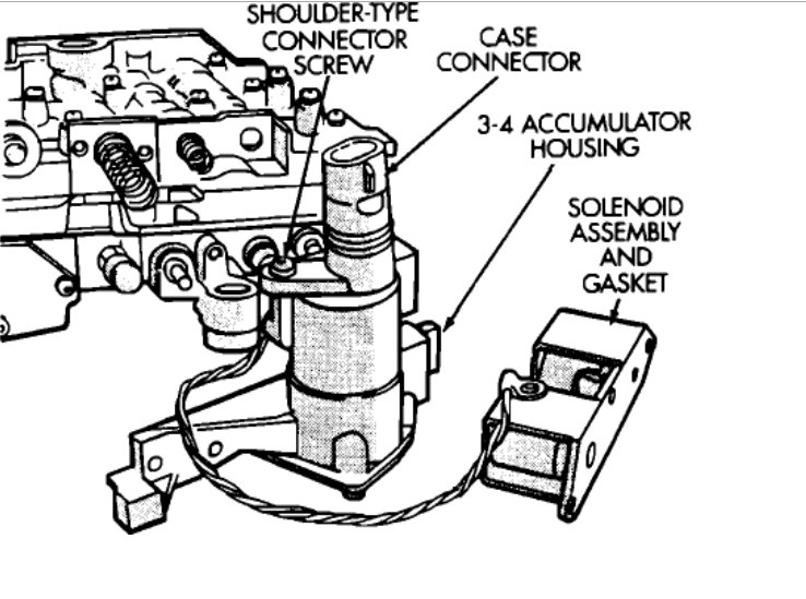

LEENSTACY2002
I have replaced the Throttle Position Sensor and something on the botton of the transmission. I took it to a shop and they looked at it and the cable on top had come loose, I was getting all kinds of codes. They hooked that up and stated that was all there was. I drove it and it would not shift into od still. When I let off the gas, the rpm's go to idle, press the gas and it catches up again. It has never shifted into od since I bought it. The tranny shop looked at it again and decided it needed the transmission rebuilt at $1400......I am hoping that there might be something easier and less expensive that I might could try. When I plugged in the computer checker, it stated 3-4 shift. Thanks for any help anyone can offer. Lee
Aug 9, 2020 at 12:46 PM (Merged)
  • 110,194 POSTS
Has the 3-4 shift solenoid been replaced?
LEENSTACY2002
no, i have not replaced that. is that inside the transmission? that is the code that came up. will i be able to change that myself or will i need to take it to a shop. i appreciate all the help you can give. i will make a donation when i am ahead enough. right now, it is week to week. thanks again....Lee

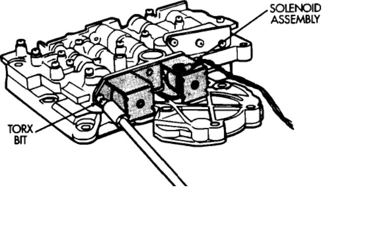

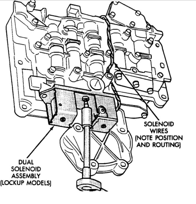

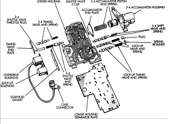

RICKY601
Transmission problem 6 cyl Two Wheel Drive Automatic 195000 miles
My Dakota will not shift into overdrive. It used to after 5 or 6 miles of driving. Now it won't shift at all. Also at about 55mph it starts missing and backfiring. When I ease up off the gas it will run right. But that don't work too good going up hill.
  • 110,194 POSTS
It sound like the overdrive control solenoid has gone out. Here is a guide and some diagram (Below) to help you get the the problem fixed.
Also, I need you to check something. Get in the truck and place the key in the ignition. Cycle the key from off to the run position 3 times (do not start engine). On the 3rd time, let the key stay in the run position. The check engine light will begin to flash codes.
The codes for a 92 are 2 digit numbers. The light will flash then there will be a sligh pause and it will start again to identify the 2nd number of the code. After it finishes the code, there will be a longer pause and it will move on to the next.
Count the flashes to keep track of the codes. Let me know if there are any and what they are if you find any.
I got you beat (but not by much), my 92 has 220K on it and going strong. It has a 5 speed which will outlast the truck. I use it to haul, plow snow, tow a motorcycle trailer... I love it. We'll figure your problem out. Just hang in there.
At this point, something tells me the torque converter isn't locking up to give you OD, but the backfiring and missing has added a new problem.
Let me know about the code. Also, when you get to code 55, that indicates it has finished.
Let me know what happens
Cheers, Joe
RICKY601
I checked the codes and the only code I get was a 55. I also went ahead and put some plug wires and a fuel filter on it. It's still doing it. Then I changed the overdrive solenoid and it works prefect, I love this site.
