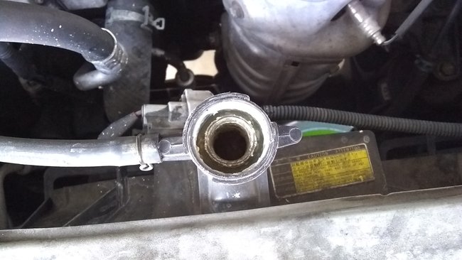

My car stopped because of overheat, shot up all the way to high red. Radiator top tank detached and milky white thing in radiator cap and blown between radiator broken area. I took it to Goodyear and they mentioned that plastic top take in radiator detached was the cause of overheating. They mentioned I have to replace entire cooling system radiator, thermostat, tubes and coolant flush.
Quoted around $800.00, my car is worth may be $1,000.00 to $1,500.00.
I also noticed that radiator cap milky white stuff dried and spluttered between broken area in the radiator. After referring online I am suspecting blown gasket due to which oil mixing with coolant. Am I right about it?
Should I fix this car or should forget bout it. Car is towed back to my house and thinking should I fix it myself referring DIY video or forget it do not waste any money in it?! I have been doing all the repairs of this car for last four years.
Is it fixable? Is it worth spending money on it?
radiator top tank detached and milky white thing in radiator cap and blown between radiator broken area

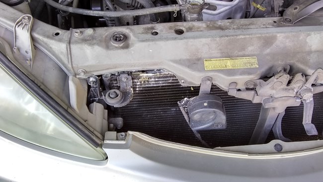

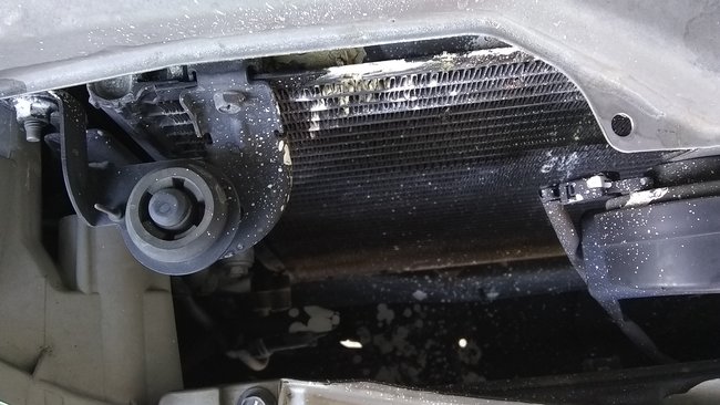

SPSK78
Thank you very much for the response. It really motivates me to work on my car. I am trying to learn and also fix it.
I have attached the pictures radiator leaks.
Jan 25, 2021 at 2:35 AM (Merged)
  • 110,240 POSTS
Hi again. I am here to help if you want to give it a try. As far as the pictures, it does not look like oil has contaminated the system. Either that is corrosion from age or someone put a stop leak in the system at some point.
I would recommend flushing the system (engine) and replacing both the radiator and thermostat. If any of the hoses are bad or look cracked or swollen, replace them at this time.

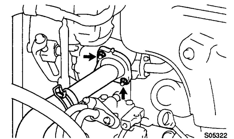

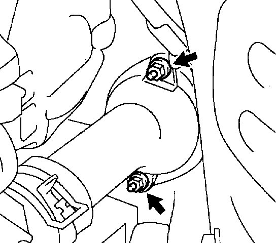

For thermostat replacement, here are the directions. Keep in mind, the thermostat needs removed to properly flush the engine block. The last two pictures correlate with thermostat replacement.
2002 Toyota Camry SE Sedan L4-2.4L (2AZ-FE)
Vehicle » Engine, Cooling and Exhaust » Cooling System » Thermostat » Service and Repair
SERVICE AND REPAIR
REPLACEMENT
DRAIN COOLANT
REMOVE WATER INLET
Remove 2 nuts, and disconnect the water inlet from the cylinder block.
REMOVE THERMOSTAT
INSTALL THERMOSTAT
Install a new gasket to the thermostat.
Install the thermostat with the jiggle valve upward.
HINT: The jiggle valve may be set within 10° on either side of the prescribed position.
INSTALL WATER INLET
Install the water inlet with 2 nuts. Torque: 9 Nm (92 kgf-cm, 80 inch lbs.)
ADD COOLANT
INSPECT CHECK ENGINE COOLANT LEAK
__________________________________________
A thermostat is very inexpensive, so I recommend just replacing it. Also, I am suggesting these repairs based on the idea that the engine still starts and runs. If you worry about engine damage, please refer to my original post. Also, if you start the engine to see if it runs, do not run it longer than a few seconds since there is no coolant in it.

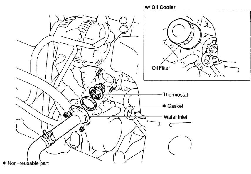

Good morning,
The first thing I would do is change the thermostat. It may be stuck closed not allowing circulation.
https://www.2carpros.com/articles/engine-overheating-or-running-hot
Did you verify the coolant level?
Does the coolant leak?
https://www.2carpros.com/articles/radiator-pressure-test
https://www.2carpros.com/articles/car-is-leaking-coolant
REMOVAL
HINT: Removal of the thermostat would have an adverse effect, causing a lowering of cooling efficiency. Do not remove the thermostat, even if the engine tends to overheat.
1. DRAIN ENGINE COOLANT
2. w/ Oil Cooler: REMOVE OIL FILTER
3. REMOVE WATER INLET AND THERMOSTAT
a. Remove the 2 nuts, and disconnect the water inlet from the water pump cover.
b. Remove the thermostat.
c. Remove the gasket from the thermostat.
