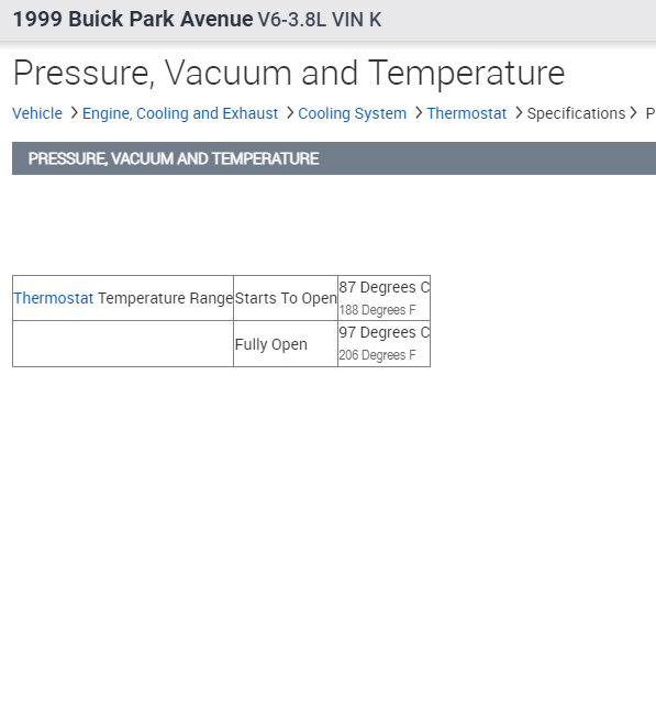

Is there a way to reprogram the fans to kick on at a lower temperature? i am worried that it is constantly sitting at 200 when idle that it's going to ruin the engine. I would like the fans to kick on at 195 because i put a 175 valve in and i don't like it getting so hot.
May 28, 2022 at 9:27 AM
SQM
  • 6,383 POSTS
The factory operating temperature for this vehicle is 195F-210F, so staying at 200F is well within the range and that is how the fans are set to operate from factory.
There is not any simple solution if you want the fan to turn on earlier as that is the ECM programming.
So, this won't ruin the engine as this is the factory setting.
Installing a cooler thermostat can keep the temperature down but the fan will kick on when it is set to turn on from the factory.
