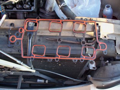

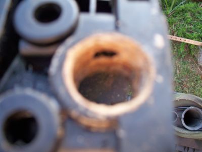

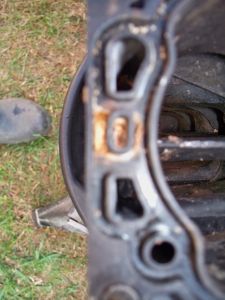

since i submitted question, i did more examining while waiting. found holes in plastic air cover, that i do not believe to be there. see pictures.
https://images.2carpros.com/forum/automotive_pictures/585764_100_0869_1.jpg
https://images.2carpros.com/forum/automotive_pictures/585764_100_0868_1.jpg
https://images.2carpros.com/forum/automotive_pictures/585764_100_0865_1.jpg
belive this is culprit. 1st picture shows holes around center hole. fell out when went to clean a little. found other hole in 3rd picture. do not believe those holes should be ther. please advise. also scan code revealed only intermittent misfires
Oct 23, 2010 at 9:47 AM
  • 75,992 POSTS
No its not its eroded its leaking thru it and making it into the throttle body,
