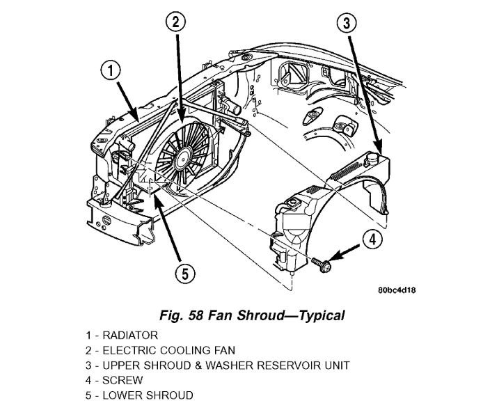

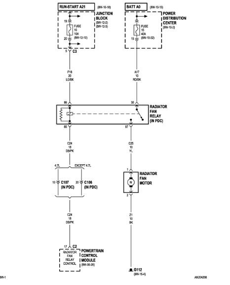

Lastly, the cooling fan on the front of the motor can also cause this condition. it needs to be checked to verify it is working.
https://www.2carpros.com/articles/how-an-electric-cooling-fan-works

Any signs of over-heating besides the temp gage? Does the radiator fan/s work ok? The other person has a good idea, about the thermostat.
