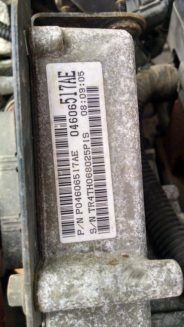

This is mine. Do these numbers have to match exactly?
Monday, October 15th, 2018 AT 3:31 PM
KEN L
  • MASTER CERTIFIED MECHANIC
  • 48,363 POSTS
They do not have to match, see if the color wires going into it are the same that are in the wiring diagrams earlier in the post.

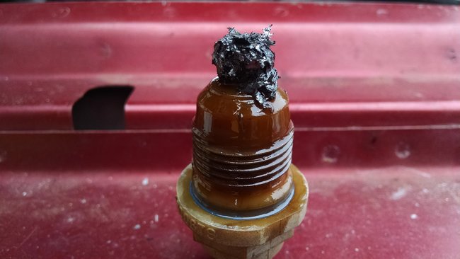

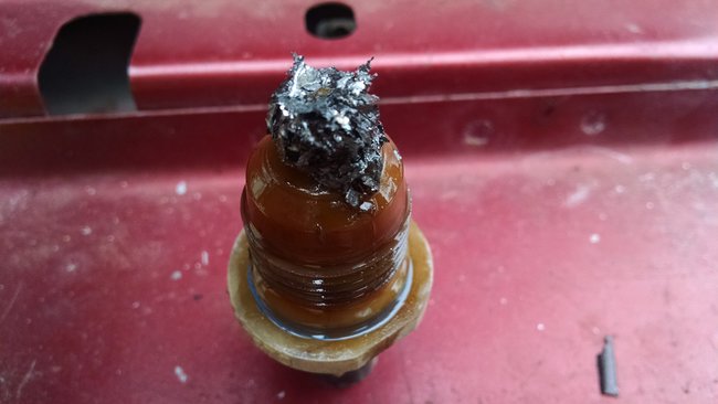

Is this bad? It does not look good, lol.
Monday, October 22nd, 2018 AT 2:10 PM
KEN L
  • 48,363 POSTS
Those are some big metal pieces on there. The transmission could be coming apart inside.
Tuesday, October 23rd, 2018 AT 10:01 AM
SHADETREE102
  • 18 POSTS
That is what I was afraid of. Seems like the magnet was holding all that it could and there may be more than that inside.

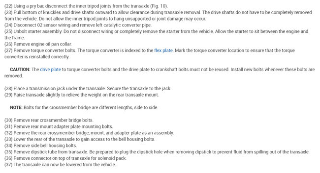

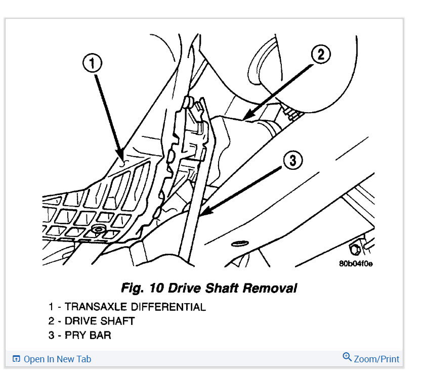

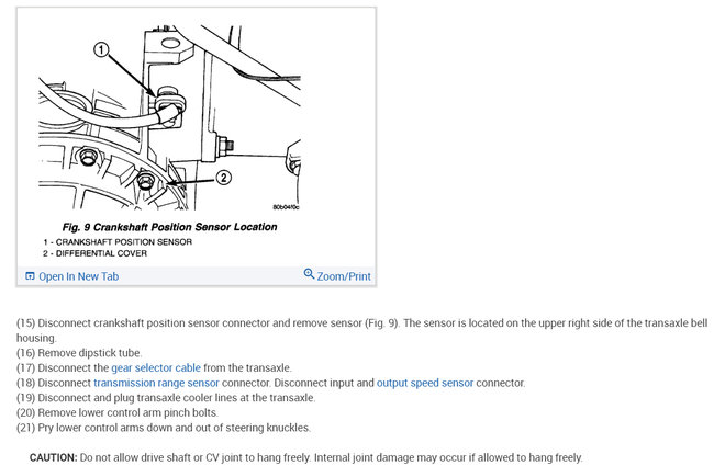

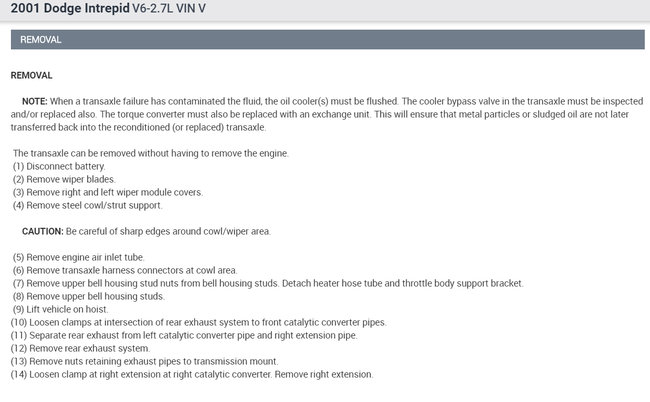

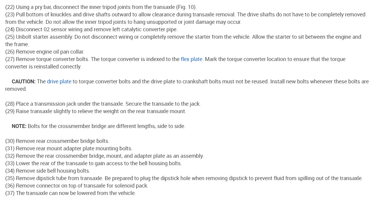

Yep, might be time for a rebuilt unit. Here are diagrams to help you get the unit out for the rebuilder or a used unit. This is a video of a front wheel drive transmission being removed (different car but the process is the same) with diagrams below to help you see what it like for your car.
https://youtu.be/6N6b5F2ChyE
Check out the diagrams (below). Please let us know what you find.
