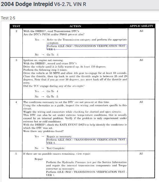

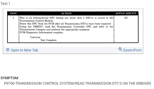

The engine light is on, I took the car to Auto Zone and the above codes were given (P0740/P0700) Would you please tell me what is my issue and how to test it?
Oct 16, 2009 at 9:39 AM
SQM
  • 6,383 POSTS

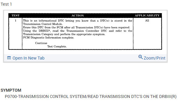

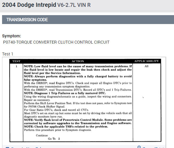

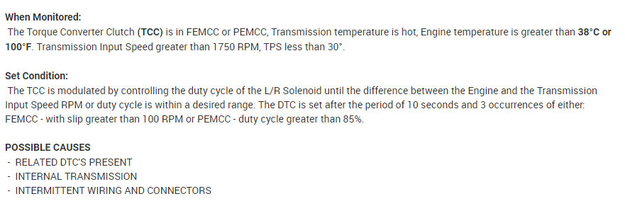

Both of these codes are related to transmission.
P0700 - Transmission control system/read transmission dtc's on the drbiii(r)
P0740 - Torque converter clutch control circuit
I have attached more details below.

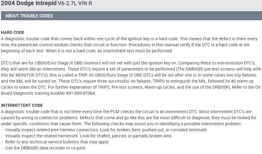

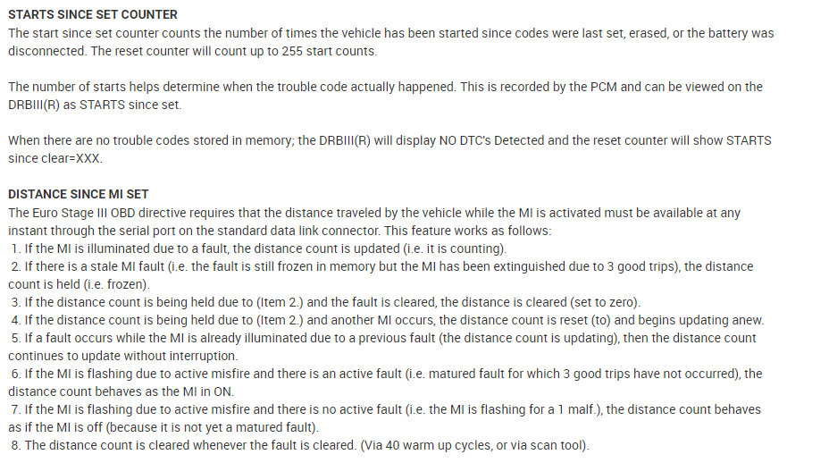

Here are the diagnostics of those codes.
