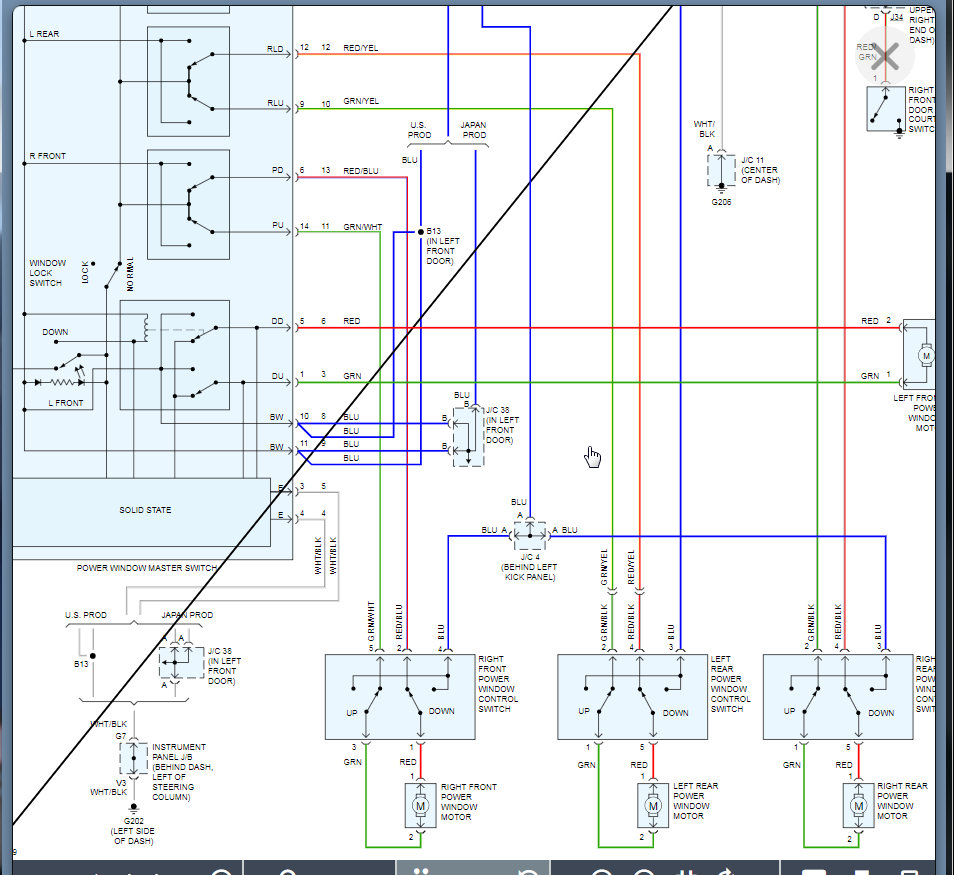

what are wire colors going from master door/window switch?
2001 TOYOTA CAMRY
100,000 MILES
FDR
Car listed above is an LE model. I need to check Ohm reading to check motor, before removing motor. ie: trying to determine if sw or motor problem.
Apr 7, 2021 at 2:25 AM
Sounds good. Below is the wiring diagram. Sorry for the line going through it. Not sure why it did that. However, attached below is the diagram that shows all the wiring for the master switch.
Let us know if you need other info. Thanks

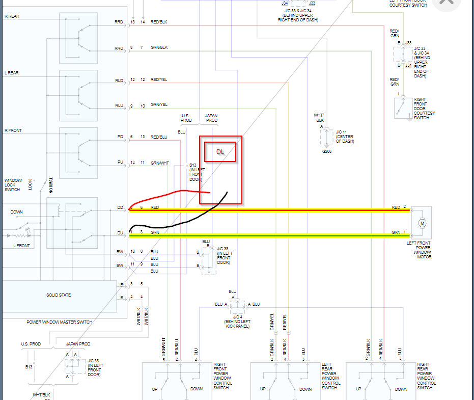

My only remaining question?
If I unplug the LHF master switch and check for an Ohm reading in the red and green window motor leads running towards the motor, I should have some kind of a reading. I get O/L which tells me there is no resistance in motor and motor must be D.O.A.
Am I correct? If you have no resistance, no power will be used to do work like turning the motor.
Thanks for your help!
Donald F.
Apr 8, 2021 at 8:27 AM

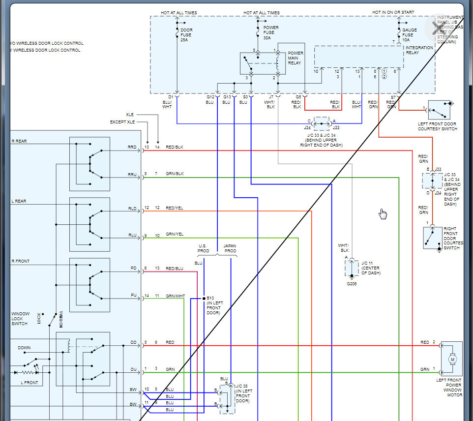

Just to be clear, you are unplugging the switch and checking resistance through the motor as shown below?
If so, then yes you should have resistance through the motor. Sounds like one of the windings in the motors is broken.

Correct. However, I just want to correct the thinking just a bit.
OL means out of limits or infinite resistance. Which means there is so much resistance that the meter can't read it. That is different then no resistance or 0 ohms. You can actually have a circuit that has no resistance because the amount of resistance that is there is so low that the meter cannot read it and it will show 0.
When there is an open circuit/broken wire, then there is so much resistance that the voltage/current cannot flow.
I don't want to split hairs because your thinking is correct but just want to clarify that for anyone else in the future that reads this. Thanks for the update.
