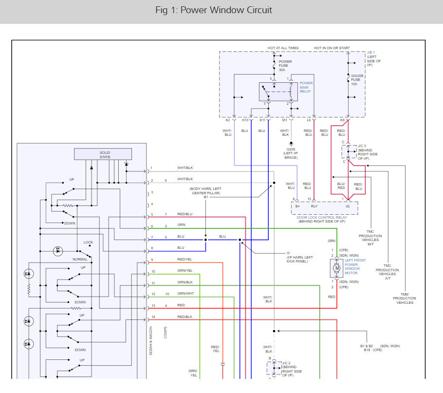

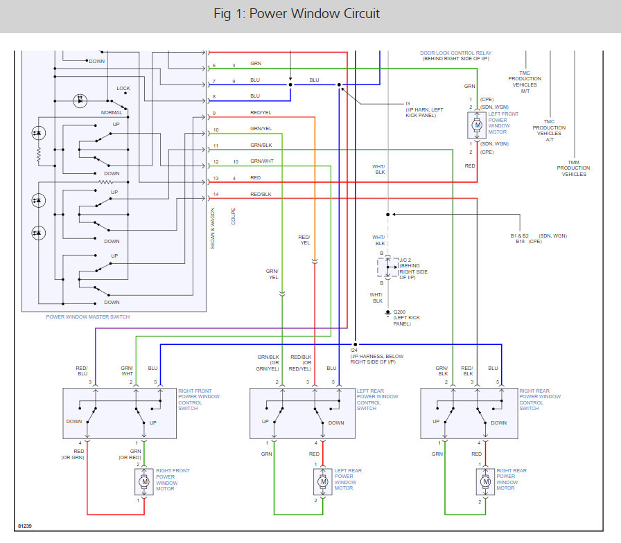

https://www.2carpros.com/articles/electric-window-repair
Check out the diagrams (Below). Please let us know what you find. We are interested to see what it is.

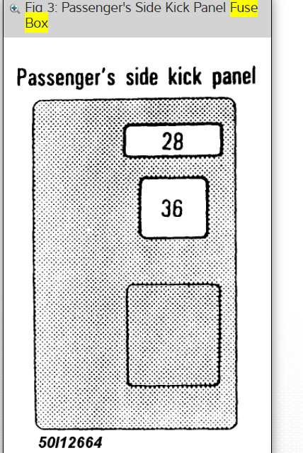

no you got a bad fuse some were. theres not only fuses under the hood and behinde the tray there fuses behinde the panel were the tray is on under the steering wheel remove that paner under the steering weel you see the fuses then remove the black tube were the ac airs goes threw you wont need to remove an screws for that just pull down hard on it you wont brake it it comes right out that way you can get to the fuses behind it you see the 30 a fuse (the bigger kind with the little glass its pink) youll find that that fuse is blown check them all to be sure there good
dum place to put that fuse you dont even now about it youd think theyd put it with the regular ones you can see but then a gain that was a pretty stupid thing you did
thats definatly your problem with out a doubt

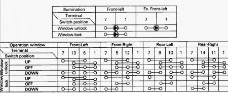

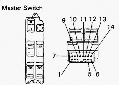

ALEX1991
  • 7 POSTS
i have a 95 camry, but only one window works. which is a rear right window. i changed the main driver side switch and i still have the same problem. i have ruled out a relay or fuse since one of the window is working. the motors are also good. i am getting voltage at the connector of the driver side switch. i am thinking it would be shortage in the wire, but i think it is too coincidental that the other 3 windows has that same problem. thank you...
Feb 19, 2021 at 11:03 AM (Merged)
PROTECH1980
  • 901 POSTS
Suspect broken wires in door jamb (inside black dust boot) common problem from years of opening wires become brittle and break, check there.
ALEX1991
  • 7 POSTS
thank you, but how do i remove the wiring?
PROTECH1980
  • 901 POSTS

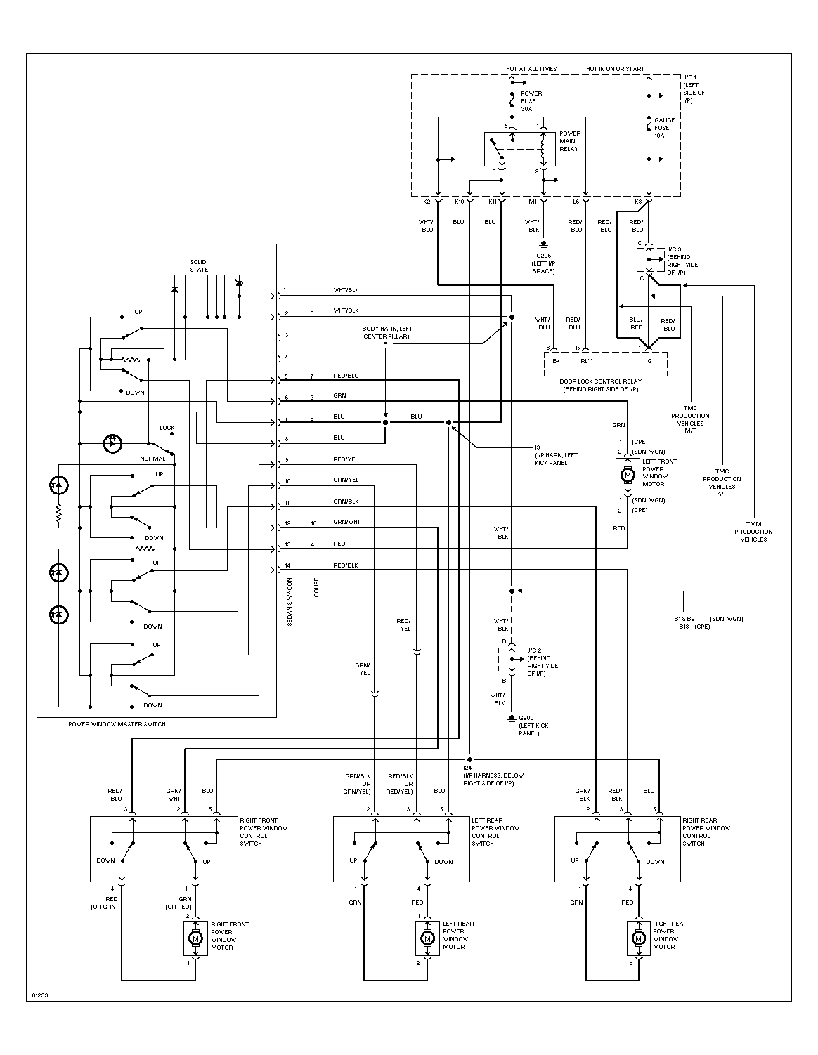

You dont want to remove the wiring, just the boot to inspect for broken wires, dont cut it, just feed one end of the boot inside the door exposing wires, then inspect for any broken wires, Also if you have knowledge of auto circuitry and are able to read wire diagrams and know/have a meter i could post a diagram for you, to aid in diagnosing problem
ALEX1991
  • 7 POSTS
that would be perfect if you could post the diagram. thanks
PROTECH1980
  • 901 POSTS
See below

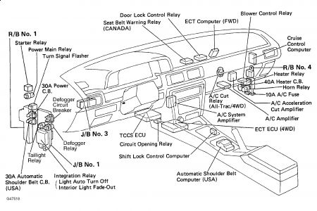

CRAST
my back right window wont roll up and the other 4 including the sunroof wont work either. is it a fuse that has gone bad? it is a year 1995
Feb 19, 2021 at 11:04 AM (Merged)
KHLOW2008
  • 41,814 POSTS

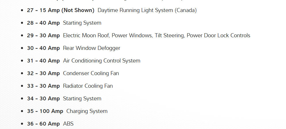

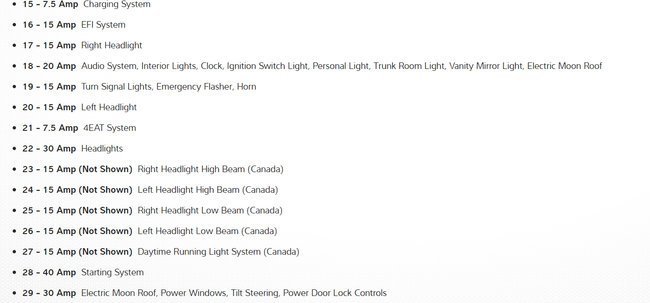

Hi crast,

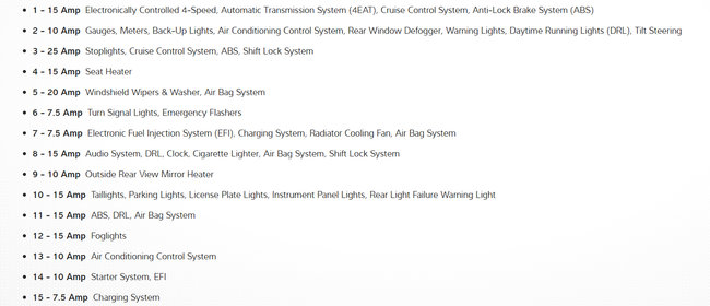

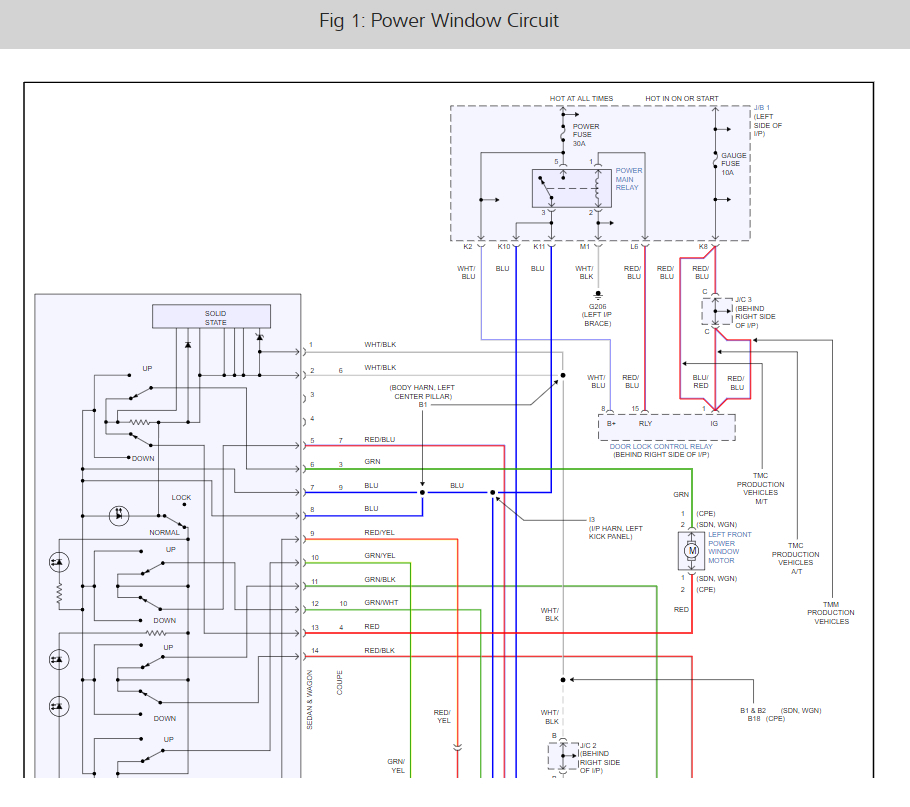

Problem could be due to a bad fuse, ( POWER FUSE 30 A) or power main relay, both located at relay box on left side of instrument panel.
Other possible causes would be a faulty master switch or wiring circuit.
Check the fuse and relay first.

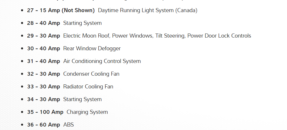

LFUL2441
Seem like I am not getting power to none of my window they will not go up or go down,I throught it was the master switch ,i got another one but it did the same thing,window still wouldnt go up or down,need your help please,oh i check the fuses but didnt see a fuses say windows2
  • 75,992 POSTS

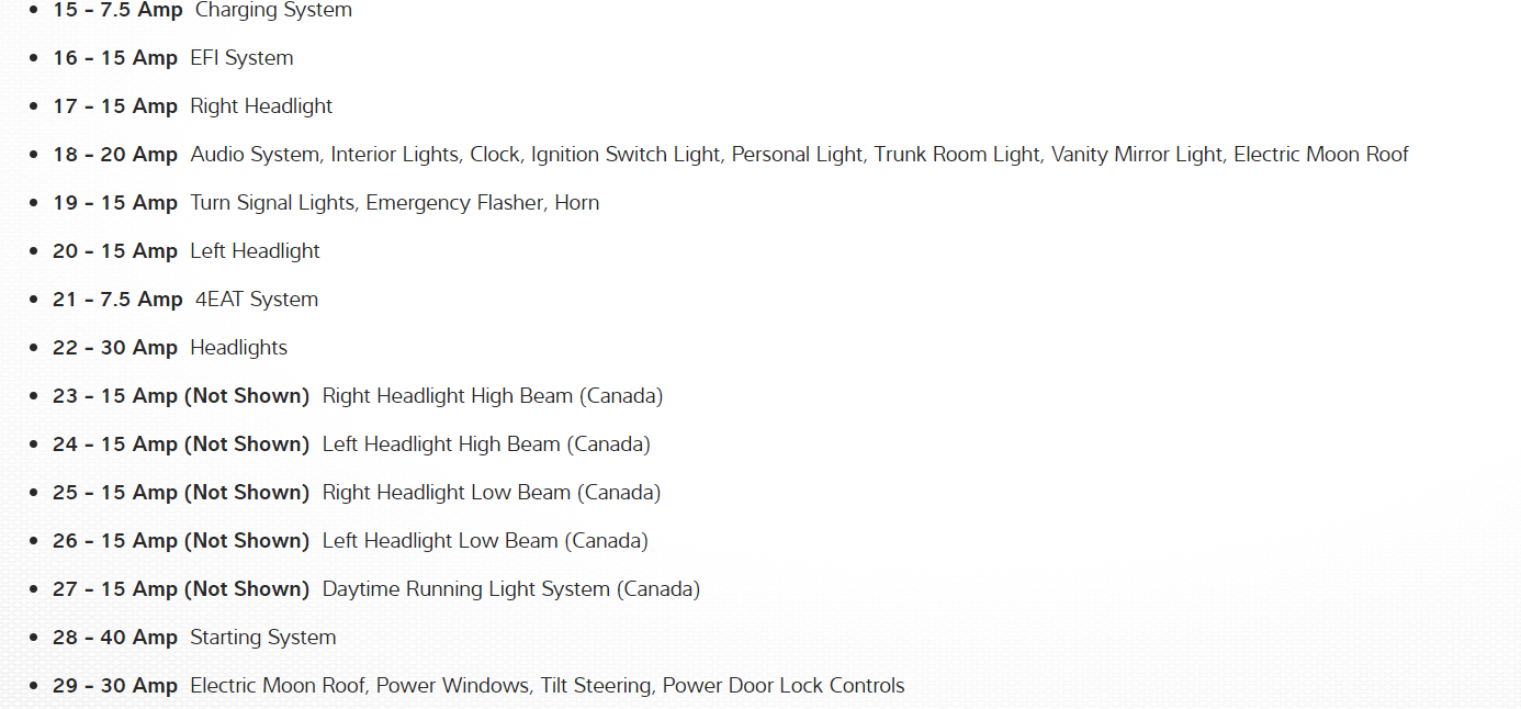

Check and test the power fuse 30amp and power main relay
LFUL2441
we here is that 30amp fuse an the power rely located at on the car.
  • 75,992 POSTS
Its inside junction block no.1 left side of instrument panel. Also check main ground at master switch white and black wire and ground point G200 left kick panel

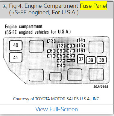

Check the main fuses that are locted under the hood on top of the fender There is a box with relays (the main fuses are right there)
check those and let us know.
Feb 19, 2021 at 11:06 AM (Merged)

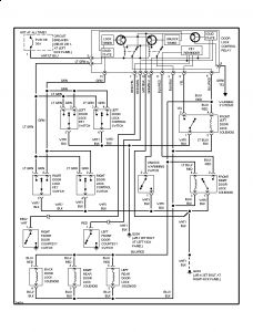

MSANTILLAN
hi my name is manuel santillan im a proud owner of my first car a 1989 toyota camry le . well my question is my moonroof and doorlocks and power windows dont work i checked all my fuses and relays and i even replaced them with new relays n fuses but no their dont work please give me an advise what could be the probelm i dont want to sale my first car cause i didnt know how to fix it please help me thank you very much
Feb 19, 2021 at 11:07 AM (Merged)
BMRFIXIT
  • 19,053 POSTS
https://images.2carpros.com/forum/automotive_pictures/99387_Graphic1_611.jpg
https://images.2carpros.com/forum/automotive_pictures/99387_Graphic2_291.jpg
