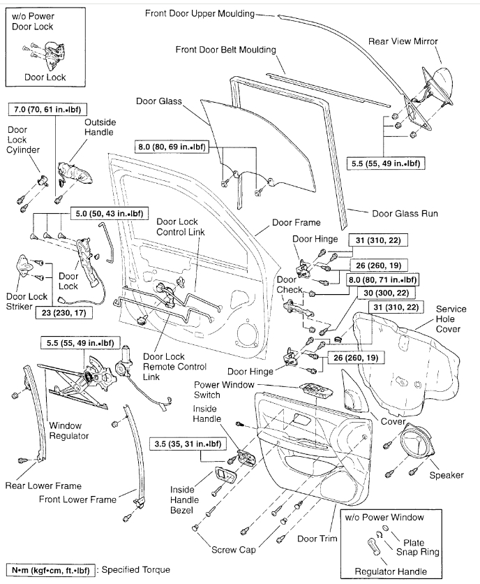

how to adjust front pass window?
Jun 28, 2008 at 11:42 AM
MASTERTECHTIM
  • 4,750 POSTS
remove door panel and check the bolts holding on the window regulator for tightness, also look at the window regulator, its possible its bent and needs replacement. Here is an exploded view of the door which shows the window motor and regulator and how to adjust the window rails. Check out the images (below). Please let us know what happens.

Hi alan suschanke,
Try spraying some silicone or wax lubricants on the door glass runchannel to see if it helps. Front area is most suspect, try using water to test.
Dead run channel will cause high friction resulting in the slanting glass when going up.
There are no adjustments available.
