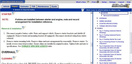

  • 75,988 POSTS
https://images.2carpros.com/forum/automotive_pictures/12900_1994_bravada_starter_removal_1.jpg

I removed the starter from the vehicle because I could not get to the terminal in place. I checked the resistance across the solenoid with an ohmmeter and it read zero to ground (Direct short). I also checked the resistance of the starter motor from the positive terminal connnection (the one with the big black wire) to ground and read an open. Just to make sure, I read the purple wire voltage to ground with the switch in the "Start" position and read 12 volts. This makes me think that the starter/ solenoid is bad. Am I thinking correctly?

You're in the right path-It has power to it but won't kick over. You can open it up and do a little cleaning at the commutator and brushes might work again. Its your call.
