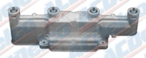

SERVICE WRITER
  • 9,123 POSTS
On the top of the engine there is a plate with 4 bolts holding it down. Remove them and pull the plate off. There are 4 boots that go over the plugs and on to the coil housing. the coil housing is the large white thing with the coils attached to it. replace the boots at the same tiome as the coil housing.
Picture below
