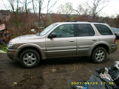

my 4 wheel drive dont work . i have smarttrack in my 2002 olds bravada. i jacked the car up n put on jack stands then started the car n put in drive . all 4 wheel spun i staied in the car so i dont know if the front wheels had any power ? but thay looked 2 spin slower then the rear wheels also after a minit the abs light came on .i just drove in sum snow last night n my 4x4 did not work whats wrong ??????[img:fdecb0b7ed]http://www.2carpros.com/forum/automotive_pictures/286133_Picture_022_1.jpg[/img:fdecb0b7ed]

Sounds like the ABS sensors may have a problem. They are used to sense the difference in wheel speed to activate the SmartTrack system. If there is an ABS fault the system will not operate. The ABS light will come on when the wheels are off the ground.
