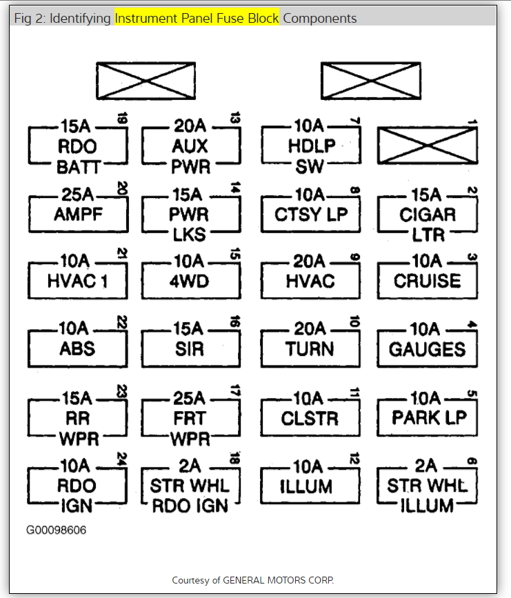

The AWD is not working I did the actuator and that did not help?
Friday, February 19th, 2010 AT 1:11 PM
4 Replies
  • 109,874 POSTS

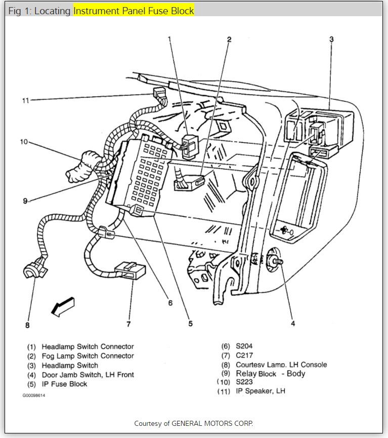

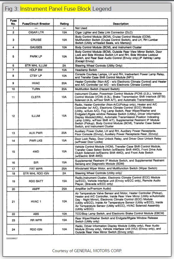

We just saw this problem in the shop please check the dome light fuse it powers the 4WD controller. Here is the location and a guide to help
Check out the diagrams (Below). Please let us know what you find. We are interested to see what it is.
+1
Friday, April 9th, 2010 AT 8:43 AM
TURBOJAY
Thank you for this post I had this problem and it was the fuse :) all set I love this site.
