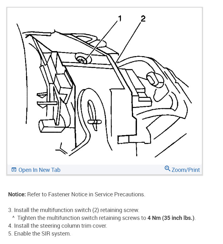

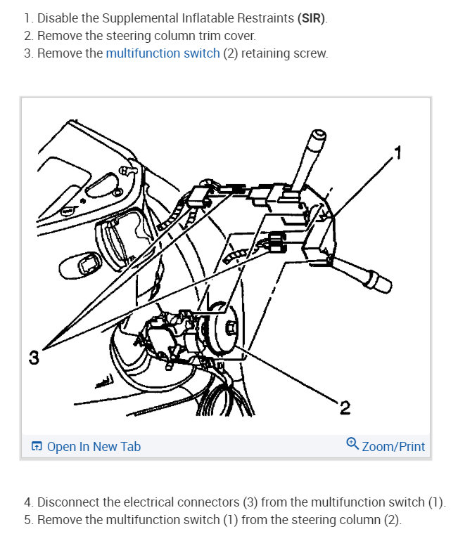

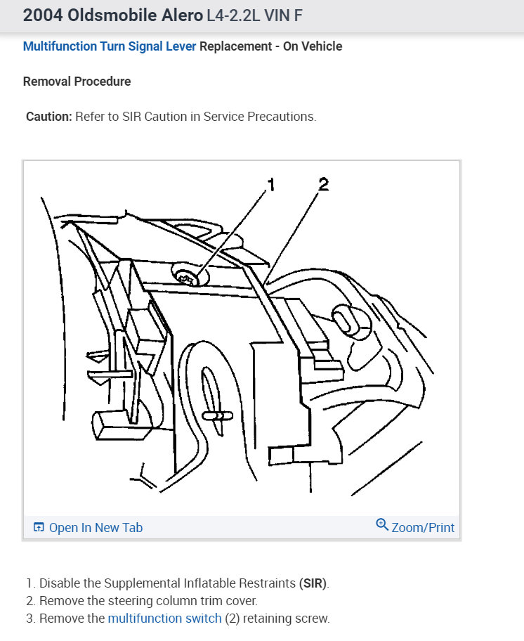

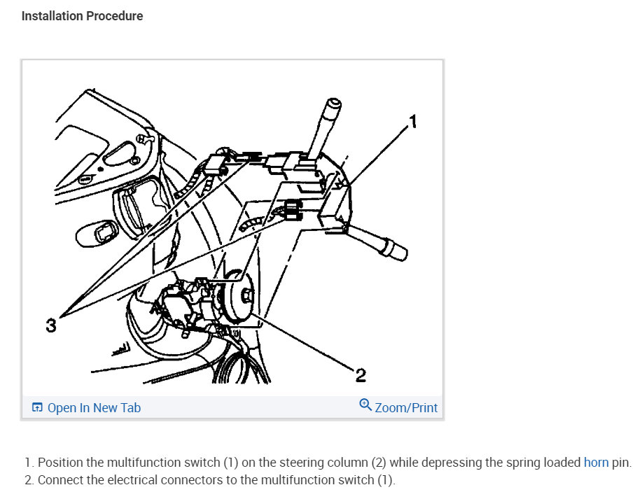

how hard of a job is it to replace turn signal switch on steering column?
Feb 19, 2009 at 2:13 AM
DOCFIXIT
  • 18,828 POSTS
Not to bad you have tilt steering then need tools, here are the instructions on how to change out the switch in the diagrams below. Check out the diagrams (Below). Please let us know if you need anything else to get the problem fixed.

I replaced it on my Alero. If you have not done it yet, tilt the stearing wheel down pull up on the cover of the collum. It just snaps in. Once it comes off there should be one screw in the center of the assembly. Remove it and the disconnect the plugs and they insert the new one.
If there was anything different I'd like to know so if you could respond that would be great.

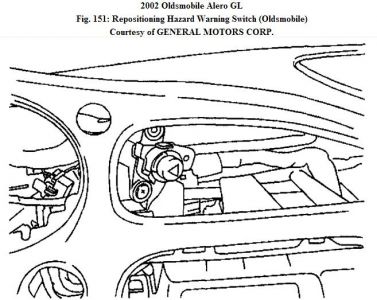

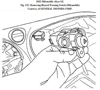

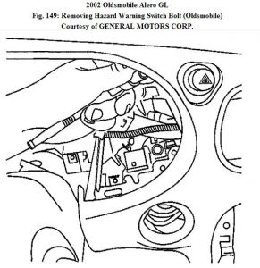

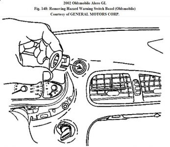

No, the hazard relay is inside the hazard switch which is located on the dash. Replacement time is 1.0 hour. Here are the removal procedures. You decide if it within your capacity. Removal Procedure 1. Remove the hazard warning switch bezel from the instrument panel (IP) using a small -flat bladed tool to release the retainers.
https://images.2carpros.com/forum/automotive_pictures/192750_HazardSwitch02AleroFig148_1.jpg
2. Remove the IP center air outlet. 3. Remove the IP cluster. 4. Remove the left side bolt from the hazard warning switch through the instrument panel cluster pocket.
https://images.2carpros.com/forum/automotive_pictures/192750_HazardSwitch02AleroFig149_1.jpg

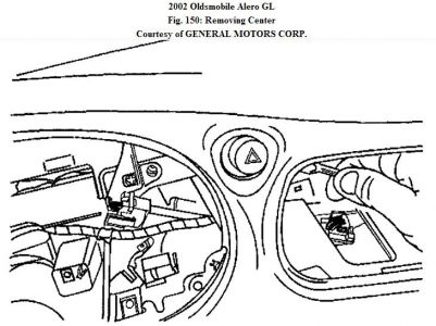

5. Remove the right side and center lower bolts from the hazard warning switch through the center air outlet opening.
https://images.2carpros.com/forum/automotive_pictures/192750_HazardSwitch02AleroFig150_1.jpg
6. Reposition the hazard warning switch to the center air outlet opening.
https://images.2carpros.com/forum/automotive_pictures/192750_HazardSwitch02AleroFig151_1.jpg
7. Disconnect the electrical connectors from the hazard warning switch. 8. Remove the hazard warning switch from the IP.
https://images.2carpros.com/forum/automotive_pictures/192750_HazardSwitch02AleroFig152_1.jpg
Jul 17, 2020 at 9:30 AM (Merged)

Ok wow that looks quite doable. Thank you so much this forum is quite remarkable. I will do this.
Just one more bit of information I learned. The switch to turn the turn signals on, if I move it a fraction of an inch away from center that causes the clicking sound from the dashboard non-stop. Does this still indicate the hazard switch?
Thanks so much again.
