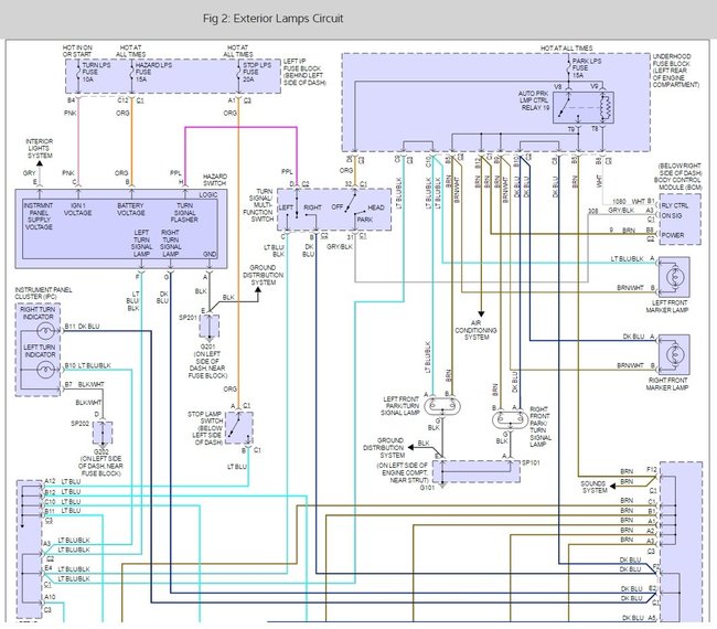

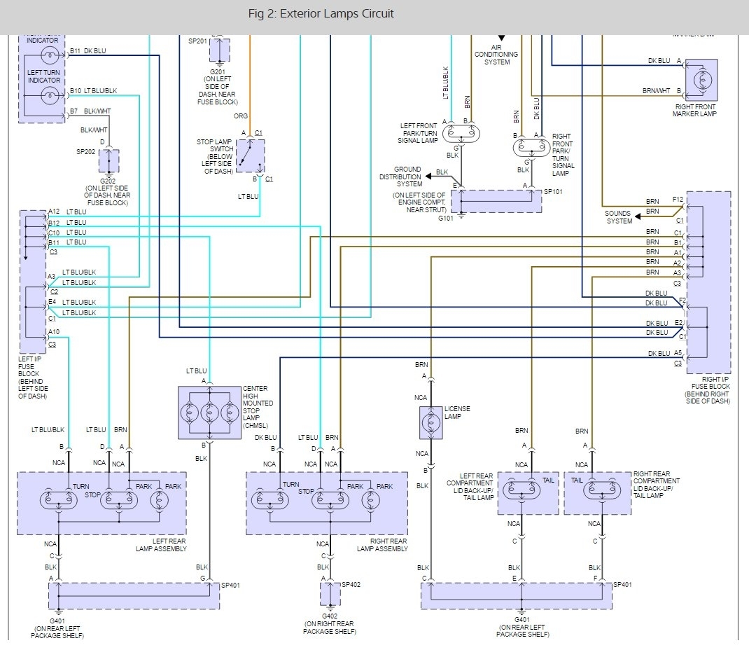

There is a auto park lamp control relay that looks like it controls the power to the turn signals that could be out, here is a guide and a diagram that can help you get the problem fixed. Also you can check for power and see if you are loosing it somewhere.
and
Please run this test and get back to us so we can continue helping you.
