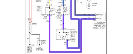

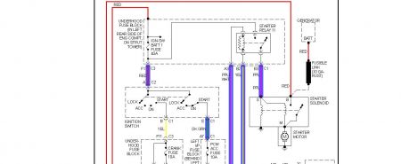

wiht the fuses and relays in place the vehicle will not crank at all. battery power at starter but no power to solenoid wire with key in start position. have confirmed power at relay for both the signal and the battery power for solenoid. bypassed the nuetral safety switch with no good result. was able to get the engine to crank with term 86 of the starter relay grounded which makes the car turn over with the key in the on positoin. seems to me that the pcm is not grounding the starter relay. has anyone had this issue. am i on the right track?
Nov 12, 2019 at 2:55 PM (Merged)
  • 75,992 POSTS
Sounds like you're on the right track -also see below
https://images.2carpros.com/forum/automotive_pictures/12900_s1_46.jpg
https://images.2carpros.com/forum/automotive_pictures/12900_s2_43.jpg
