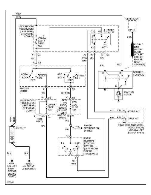

A few nights ago I went to start my car, and it wouldn't start. The ignition made no noise at all, no clicking to indicate a dead battery or anything like that. I could hear the fuel system starting up, but that was all. None of the dashboard lights car on either. I called AAA, and they sent out the vehicle. The person who showed up immediately found it was not the battery, and proceeded to check if it was the starter or something else. He found that it was a shortage, which had caused the 40A fuse for the Ignition Switch Battery to blow. He didn't tell me that specifically at the time, though, and merely said there was a shortage in the ignition somewhere. I had the car towed to Pepboys, and the next morning they said it was the Ignition lock Cylinder, which sounded a bit off to me since I was having no problems turning the key. Before they did any work on it, we had it towed home and checked it ourselves, and found the problem with the fuse that had been found my the AAA guy. After a ton of research, we figured the problem must be the ignition coil, which we then had tested. The coil was blown and we replaced it. The car didn't start, but the fuse didn't blow and the battery was dead, so we charge the battery. The car was able to start after that, but when we turned the car off again the 40A fuse had blown once more. I've done more research, and found that the problem could either be a wire grounding out somewhere, or the alarm remote could be interferring with the car somehow. The problem with the second theory, though, is that when I bought my car used it did not come with a car alarm remote. Is there anything else that could be causing the problem?

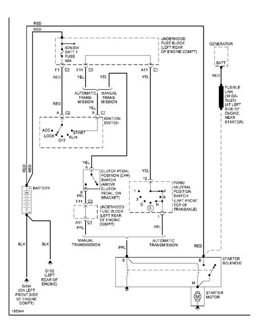

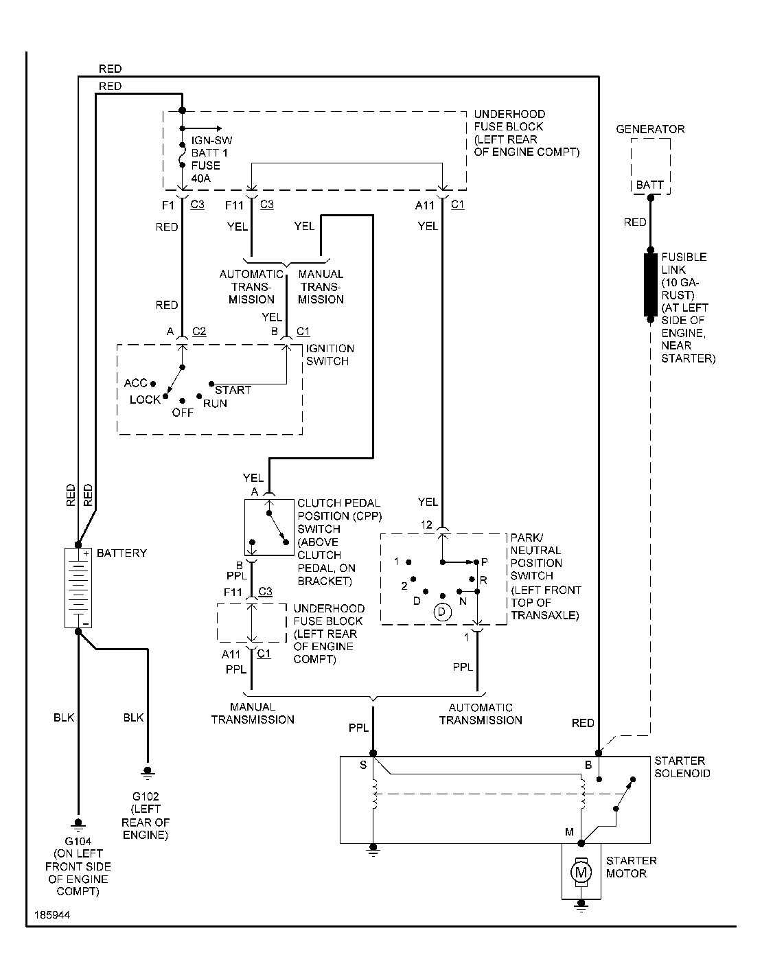

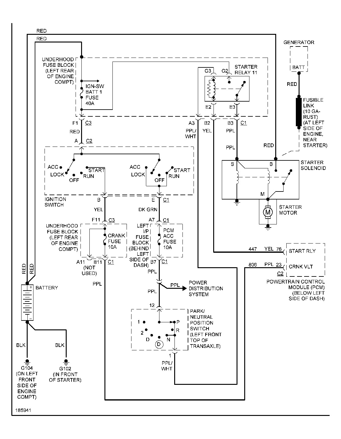

The starting system would be the place to start. I do see the 40 amp fuse in the system.
Diagram 1 ) 2.2l vin f
Diagram 2) 3.4l vin e
This may show you things to disconnect to see if the fuse blows or a way to trace through the system. Locations are marked beside items.
Let me know if you need more information.

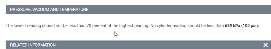

Your engine needs three things to start and run. Fuel, spark at the right time, and compression. Looks like you checked it all except compression.
Here is a guide that tales about the basics that we need for this issue:
Based on what I am seeing we need to do a compression check.
Your vehicle needs at least 100 PSI so let me know what you find and we can go from there. Thanks
