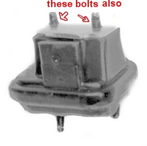

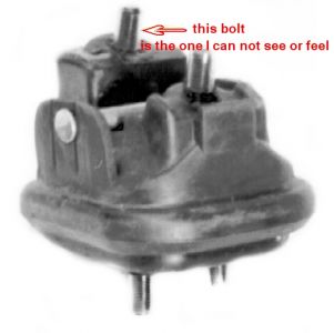

Right side (next to firewall) motor mounts both transmission and engine front. How do I get to the 2 top bolts to remove the nuts. I am unable to feel the 2nd one or see it (transmission mount)? Pictures would be a great help.

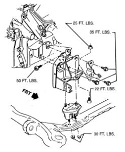

May have to remove theexhaust pipe-to-exhaust manifold bolts and separate the exhaust pipe to access the motor mount better..

Those drawings don't look anything like my 90 Olds engine. It has 2 front mounts and 2 rear (transmission) mounts I have included pictures of those 2 mounts. I will later take a picture of what may be my Olds ALDL connector Tomorrow and send it for your identification.

k you must have the VIN C engine style then. check this out..
https://images.2carpros.com/forum/automotive_pictures/261618_1_99.jpg
Remove the air intake duct. Remove the throttle cable and bracket from the throttle body.Raise and safely support the vehicle. Remove exhaust. Then remove the mounts.
