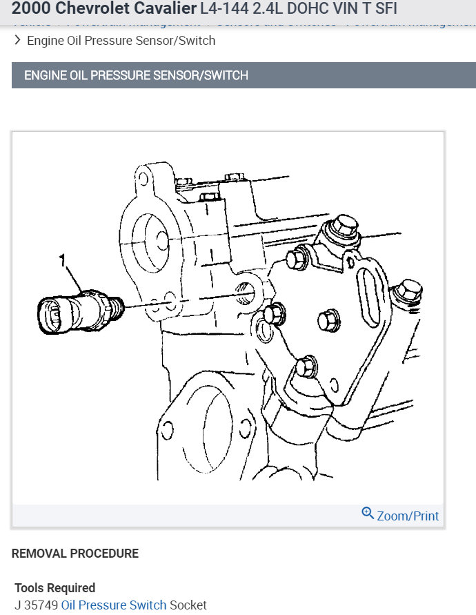

How do you change a oil sending unit on a chevy cavailar
-2
Tuesday, July 21st, 2020 AT 2:20 PM (Merged)
JDL
  • 16,098 POSTS
These have two different engines so here are both locations below. The info I looked at was for 2.2L engine. The oil pressure switch is near the oil filter.

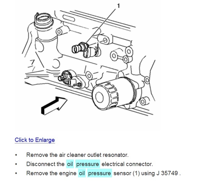

How do I check the oil pressure switch?
Tuesday, July 21st, 2020 AT 2:21 PM (Merged)
JOHNNY G.JR
  • 320 POSTS
Ground the sensor wire going to it.

Lately my oil light has been flicking on and off, but only when idle. It doesn't come on and stay on. I check to see if there was an oil leak and there wasn't. A guy at an auto part store said it could be my oil pressure switch going out.
Could that be the problem and where exactly is the oil pressure switch located in a 1997 Chevy Cavalier?
+1
BLUELIGHTNIN6
  • 16,542 POSTS
Yes, a faulty engine oil pressure sensor could cause the light to illuminate as stated. However, it may also be a faulty oil pump. The sensor is much cheaper of repair than pump so I would start with inspecting wiring to the sensor. Your vehicle's engine oil pressure sensor is located on left side of engine ( for pic. Diagram post your engine size [2.2L or 2.4L?] ).

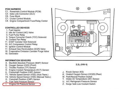

SMALLBUTTOUGH89
The engine is a 2.2L
How do you know if the wiring is causing the problem?
+2
BLUELIGHTNIN6
  • 16,542 POSTS
Just make sure the wiring is connected properly to sensor and inspect the wiring for damage (i.e. bare spots, burnt spots etc..).

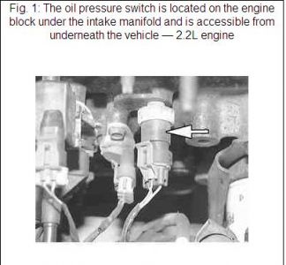

can anyone tell me where I can find an oil pressure sending unit on a 1996 cavalier 2.2L motor? Much appreciated
thanks
JDL
  • 16,098 POSTS
https://www.2carpros.com/forum/automotive_pictures/170934_chevy_cavalier_oil_pressure_switch_1.jpg
Hello, my info gave the above location. Toward driver side of engine.

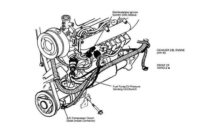

Could you please tell me where the oil pressure sensor is located on this car?
JDL
  • 16,098 POSTS
My info showed this location, below.
