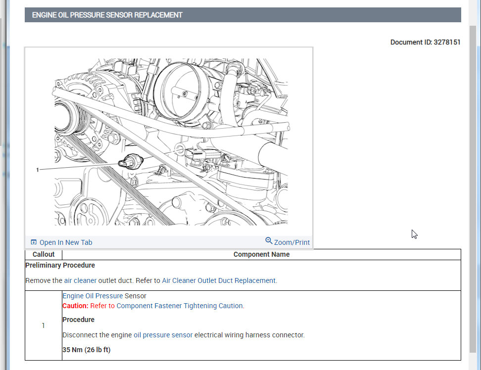

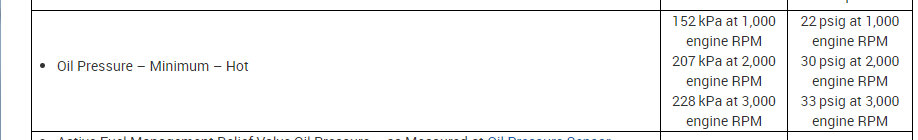

Oil pressure sensor switch location oil pressure reading high 45 to 75 PSI.
2014 CHEVROLET SILVERADO
128,000 MILES • 5.3L • V8 • 4WD • AUTOMATIC
CORERALPH
Oil pressure reading high 45 to 75 PSI.
Dec 3, 2020 at 12:24 PM
You are correct. That is a bit high. here is a guide that will help with causes of high oil pressure:
https://www.2carpros.com/articles/high-oil-pressure
Run through that and let us know what you find. Also, we want to confirm this is accurate with a mechanical gauge.
I attached the info you requested for your review. Let us know what questions you have. Thanks
