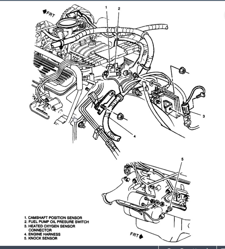

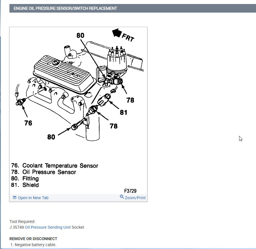

oil pressure sensor location?
MANCILLA
where is the oil pressure sensor?
Jun 3, 2009 at 2:16 PM

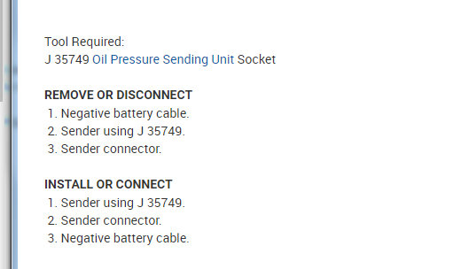

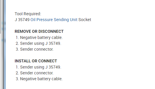

I am attaching the info from the manual on how to replace the sensor. Please review it and let us know if there is more info needed. Check out the diagrams (Below). Please let us know if you need anything else to get the problem fixed. Thanks
